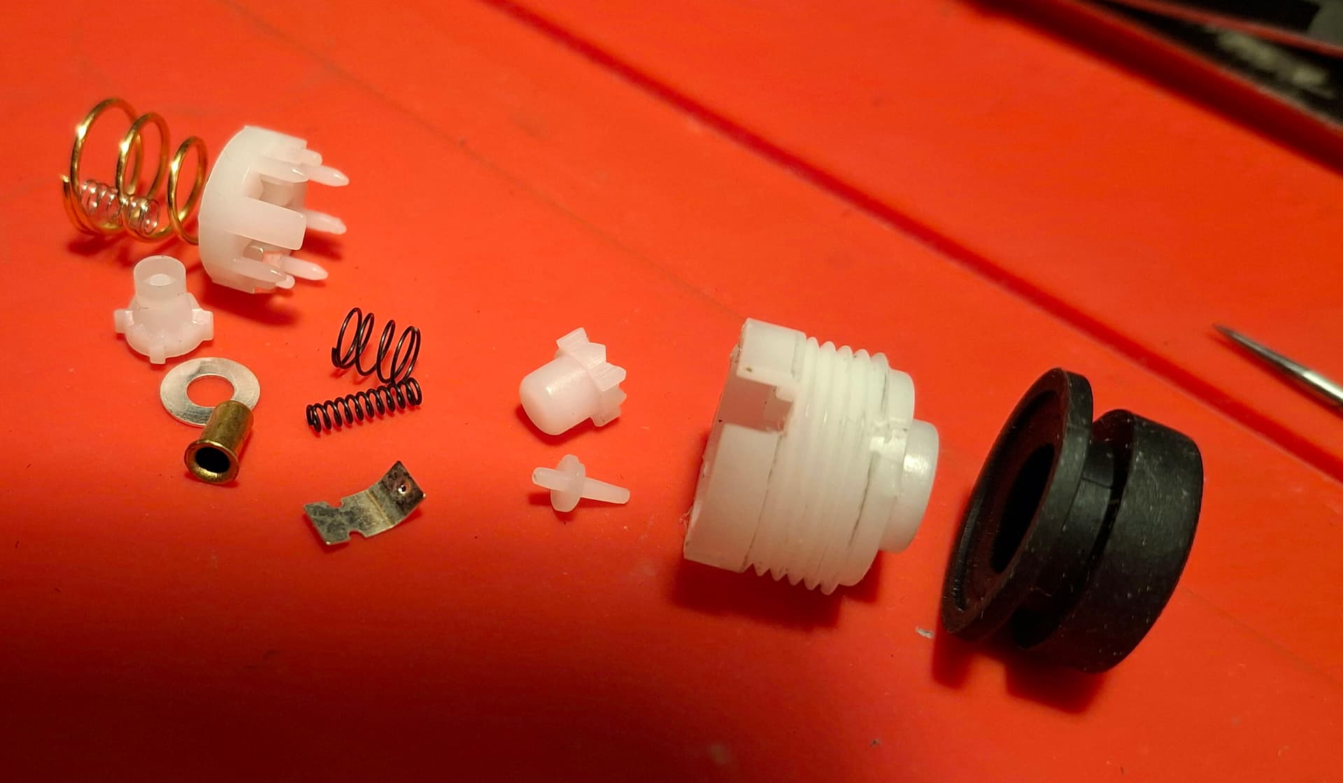

I will post pictures of the tailcap next
The actual clicky switch is not installed in these pictures, only the plastic body that houses it, just for demonstration.
These are the important dimensions. I guess it could be possible to bore out the diameter, but I do not have a lathe, only a drill, vise, and dremel, so it would be unlikely that I could get it perfectly straight.
The problem is that most “drop-in” forward clicky switches are, I imagine, built very similarly on the inside. Maybe all of them? If I could find a switch that would fit into the tailcap’s ID, I doubt that the bottom cube shaped portion of the switch would fit well, unless I could remove enough material.
IF I have to do that, it would likely be necessary to just keep the switch held in place between the battery tube and tailcap instead of using a threaded retaining ring. could even solder it in place maybe? I’ve no problems with leaving the tailcap on and replacing batteries through the head end.
