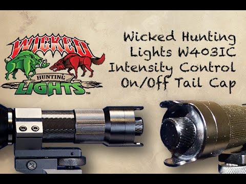

Looking for a driver that supports a dimming knob. Wicked hunting lights use an intensity knob. Pretty much what I’m looking for. Check them out.

Some have indents for fixed modes,but others are infinitely variable.Visually linear output ramping would be best.One problem,they are only available as complete torches,not just drivers.

So I posted this link to video about Wicked lights earlier on. Then I found an intensity upgrade kit for their lights that don’t currently have one. Ok, now all I see is a pill, containing a red emitter, and some sort of driver I’m guessing. The kit also contains the tail cap that has the intensity switch, potentiometer, in it. Now all the tail cap switch does is complete the negative circuit, so how could you have the potentiometer in the back, and have it work? Wicked Lights W402zf to W403ic Red LED Upgrade Kit W/ Intensity Control Tailcap for sale online | eBay
