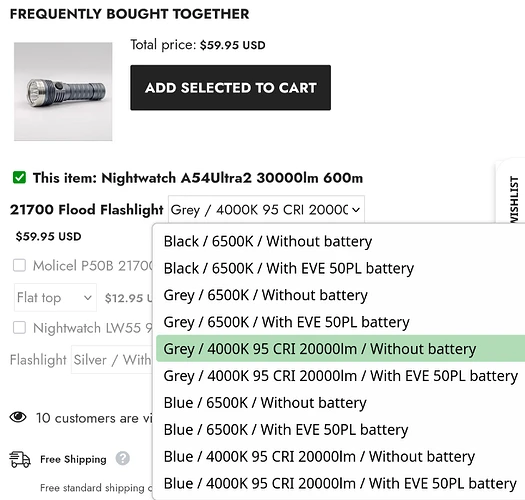

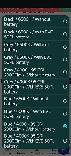

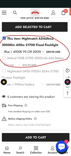

Important note: the current Nealsgadget website is bugged for the A54 Ultra 2.
If you want to order the light in 4000k 95CRI you need to drop down to these options.
