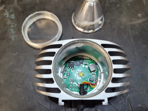

Saw this in one of the AE reviews:
Seems there’s a bosmaa PCBs in there. And there’s 2 versions; a cheap XHP70 and a more expensive Cree XHP70. And indeed aluminium (and glue) as PeyoX said.
Bosmaa pcbs
