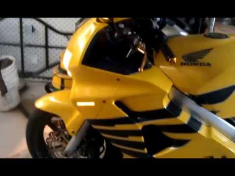

I’m making custom bodywork all around, including a headlight unit (I’ll have one set that is carbon fibre, and another one or two fibreglass sets that are painted or vinyl wrapped). I’m looking to make an LED headlight with integrated indicators, hopefully the LEDs will allow for a really tight fit, I’m aiming to put the lights right at the bottom of the unit, under that little edge that points out. For the rear I’m planning for integrated indicators and brake light tucked away right under the rear fender. Depending how things go, I may try to have the indicators completely hidden like this:
