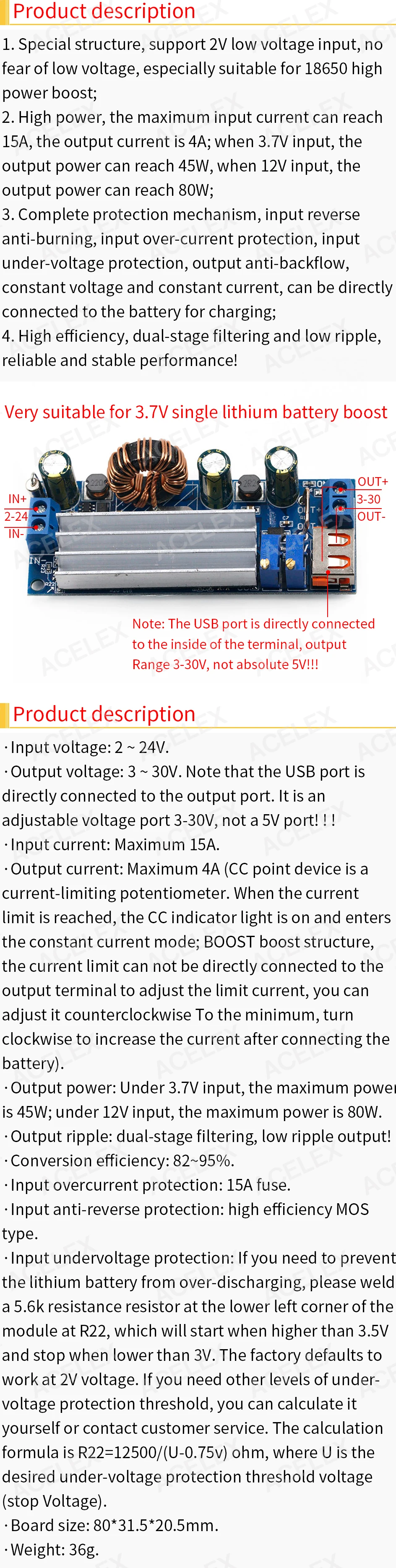

At last, let's not forget that you want to boost from low voltage, so let's find out a DC/DC module meant to handle these conditions:
A couple links:
As explained in the picture, the module lets you set input undervoltage cut-off/protection. For 2.5V, R22 = 12500 / (2.5 - 0.75) = 12500 / 1.75 = 7142.8̅5̅7̅1̅4̅2̅Ω, or -of course- the closest value you can find. In any case it defaults to 2V, which is enough.
