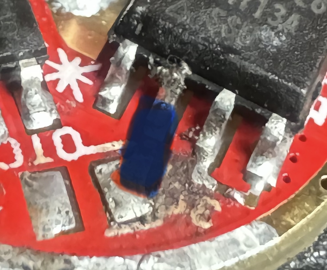

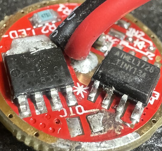

Have a 30mm diver from mtn electronics and the otc pads came off any idea if I can solder somewhere else ? Or is it junk know

You can solder the cap from pin 2 of the MCU to ground.
If you are not using an OTC, or an E-switch which uses the same pads and pin (pin 2) then you don’t need to do anything, the driver will still work fine. If you want to use an OTC or e-switch just bridge the pad to pin 2 with solder, or connect your e-switch wire directly to pin 2.
Yes E switch I’ll be using
So hoop like this or both pads with solder then to pin 2 ?
Yes, like that. That pad is connected to pin 2 only. The other pad goes to ground. One wire of your E-switch needs to connect to pin 2, the other needs to connect to ground.
