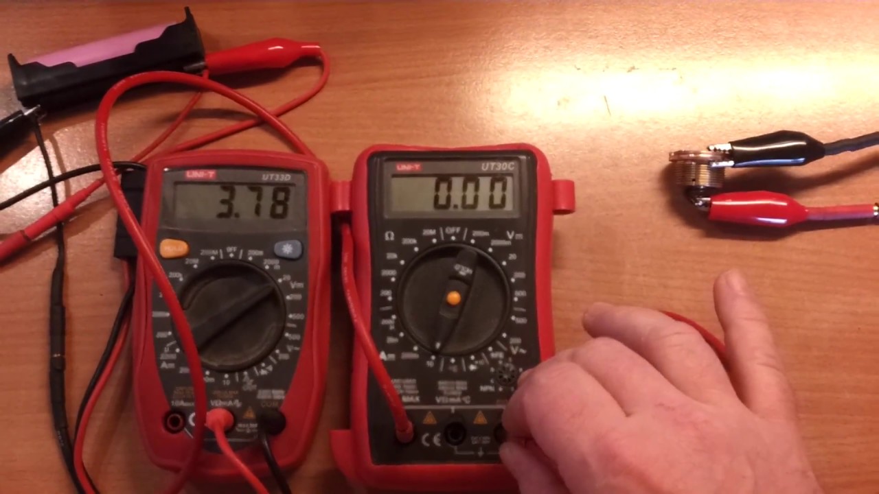

I think I’m having an issue with this driver, maybe I’m wrong. It’s FET driver (http://www.mtnelectronics.com/index.php?route=product/product&path=67_117&product_id=227) installed in Brinyte B158 and it drives an XP-G2 dedomed led. I wasn’t aware of the thermal protection in these drivers, but this sure looks like one. Three blinks and a step down should be the indication of low battery protection kicking in. Please correct me if I’m wrong and explain what is happening here. After the step down the temperature of the driver was about 50 degrees Celsius. A Multimeter on the left measures voltage of the battery and the one on the right measures Amps. Please watch the video, it’s not long.

Which MCU pins? Please point or explain. Comfy said pin No.7. Where should I put other multimeter lead? Should I measure when light on or off? Should I measure when step down or before?

There is no step down after shorting pins #7 and #8 :-). When short is removed step down kicks again. Should I short them permanently and lose LVP or there is better solution?
