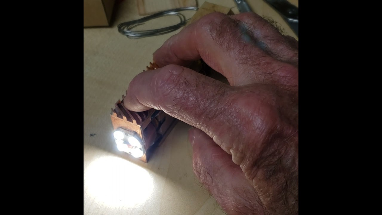

The last image for today has the heat sink, switch plate and cell block secured with a hex head machine screw. A 16650 cell is slipped inside as a fitment test. I am happier today than I was a few days ago.
