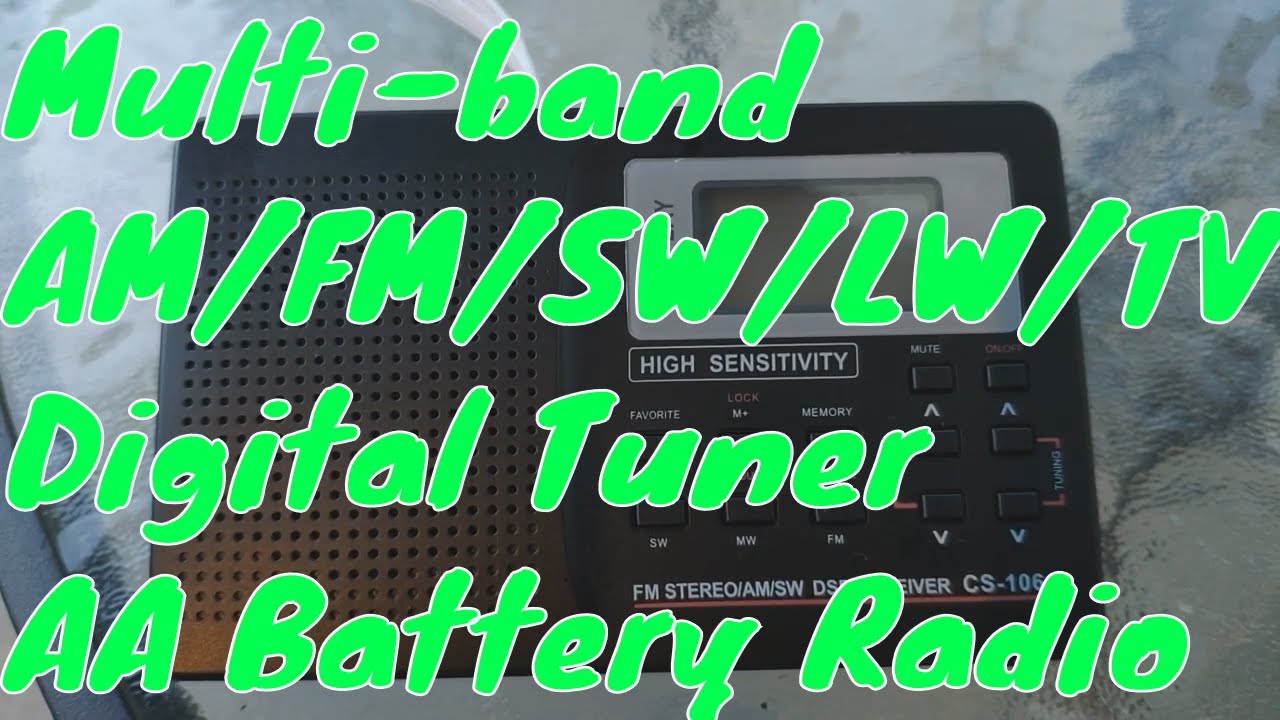

For me the most important aspect of this radio was reception then battery life and then build quality.
Reception how is it? I highly rate the reception on this radio it’s great compared to a radio of similar price in Australia it leaves them for dead. They do not compete in reception or features but that is understandable. I will break reception up as groups.
Shortwave is good. I am not sure what to expect from SW as i don’t use it much but as far as i can tell it does better than Degen SW radio. I was able to pick up SW radio station from NZ with no issues. Also I got some overseas Asian stations that sounded like it was in Thai. I did try and google what station they are but i found no results except one station called WRMI 11.53mhz this is an American station that sells its network so i am not sure where they transmit from.
My main goal was to get good reception on the FM band as where I am currently located the reception is bad. I am in between Sydney and Newcastle with lots of mountain ranges in the way. About 80+km from Sydney and 40km from Newcastle the two main cities.
Reception here is bad on any piece of equipment my Kmart no name radio is horrid. I get better reception from a Kaido branded radio I have. I get about 2 or 3 stations on most radios. Compared to the CS-106 which picks up about 15+ stations. I also have a Panasonic mini HiFi which only gets a few stations but that is located inside the house. The CS-106 does better than the car for stations around here.
Best way to check the reception quality is to watch the video and hear it for yourself.

Build quality
I will skimp over the build quality. Overall the radio seems sturdy and robust. My radio does have a chunk of the body missing from where one of the clips meets on the top side. It’s hardly noticeable, Not sure if that happened in transit or the radio was built like that.
Overall I think the radio is built great, the buttons work properly, the antenna can swivel a full 360 degrees. The antenna is long but still compacts down to a small size. An additional feature is the little flip stand it helps the radio stand while leaning making looking at the screen easier and clearer.
The screen is clear and easy enough to read and has a backlight. The backlight is a bit sporadic it will sometimes flicker when listening to the radio up at high volumes but it still works.
The CS-106 can run on either two AA batteries or you can input power from a micro USB cable 5v. The CS-106 has a clock and also an alarm feature which makes the USB power feature great. The radio has no inbuilt battery, that was my decision as I wanted to be able to use disposables.
Battery life is not tested yet but the radio has a mechanical switch and a soft off which keeps the time displayed on the screen. For a fishing kit or bug out bag the mechanical switch is perfect as you don’t want the batteries to drain.
I probably missed a bunch of stuff but yea i don’t usually review radios. I was after a Sangean radio but really didn’t want to spend that kind money on a radio that might not see much use. Overall i am happy with this radio it has its quirks but for 10 bucks its more than acceptable. Mine did come with a ding but its still solid overall.

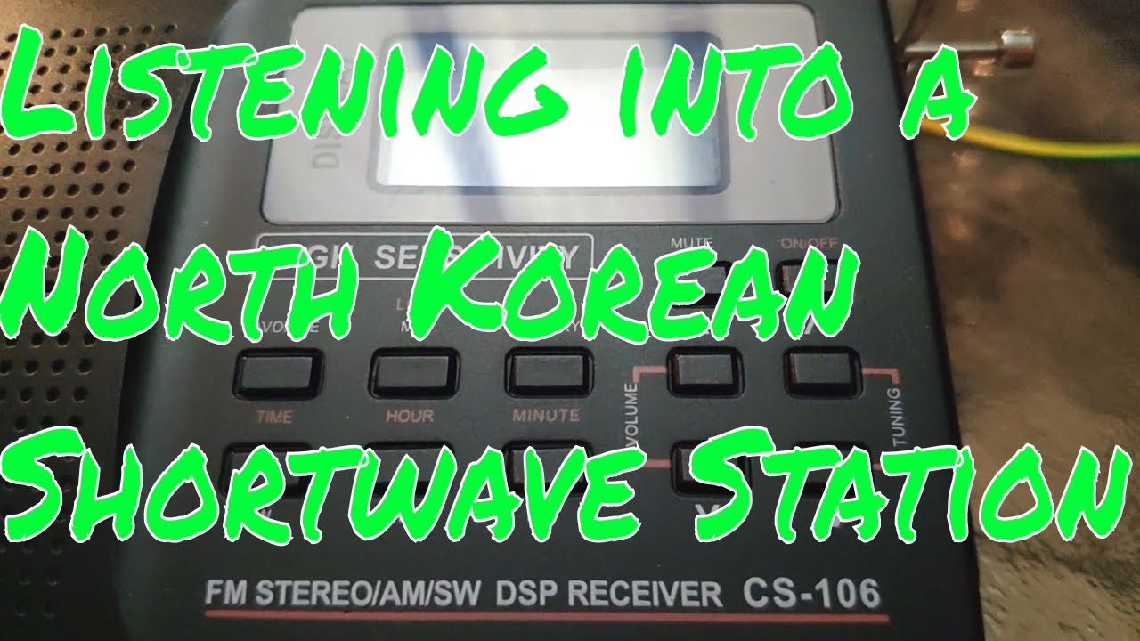

I picked up a station from Mainland China last night SW 9810khz Voice of China.
I found some interesting stations with this little short wave radio. Pretty cool to pick up a North Korean Shortwave station, I think its like 8000+km distance.
