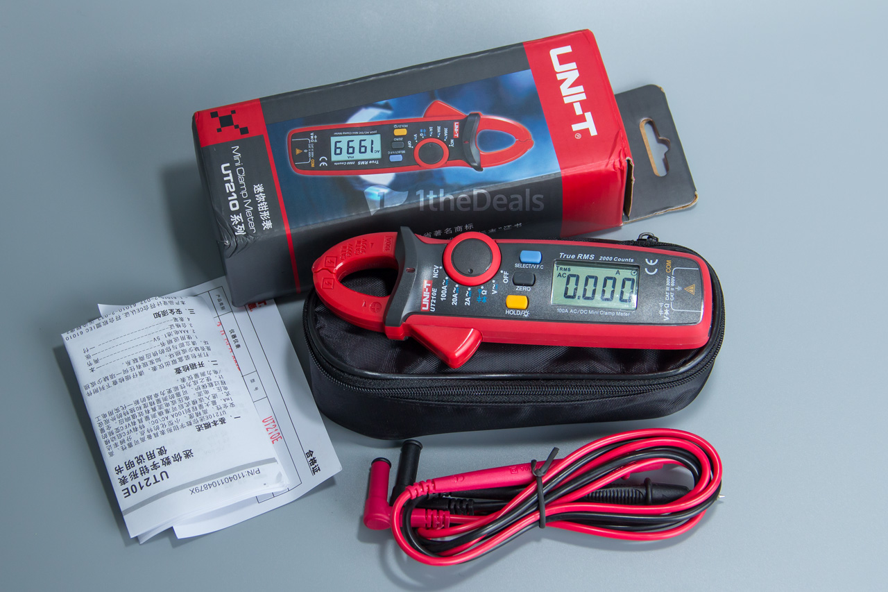

Clamp meter —> UNI-T UT210E if you have that, you don’t need an additional multimeter since it can measure almost everything a DMM does. (it only does 20A though, but it’s cheap and offers value for money)

For a clamp meter I use the UNI-T UT210E that was recommended to me here on BLF.

I use a UT210E clamp meter and UT61E multimeter.

Sorry folks, but when you mention the UNI-T UT310E , do you mean UT210E?
Today I had my hands in a UT210E box, then the 301 reference made me confuse, so…it was not this time I bought one :zipper_mouth_face:
moderator007 gave me UT210E suggestion a while back (which I thank again ), and I guess I will follow it anyway. But I just wanted to make this situation clear!
