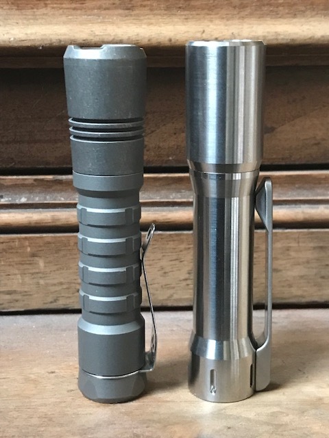

I got the Raw smooth Ti version and it does look very classy. It’s about 10g heavier than a Reylight Ti Pineapple and just a tad bigger. The threads are not compatible. I contacted Edoluc about the problems so we will see how they handle it.

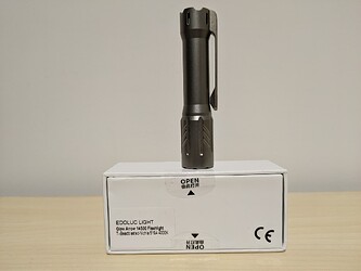

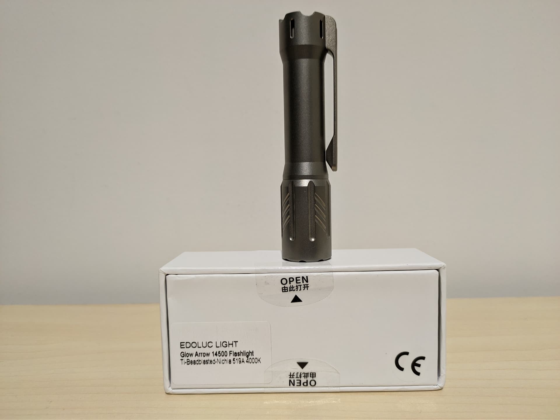

After a long wait, I finally received it. The package got stuck for more than a week. The customer service was helpful and sort out well.
The tail switch for my unit is fine but a bit mushy as well. Not as good as Raylight Pineapple Mini

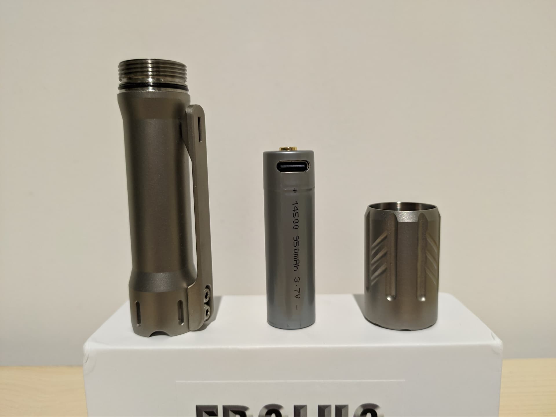

The package is quite simple and clean. The build quality is good and feels great.

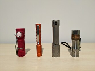

Size comparison with some other flashlights.
From left to right. D3AA, Pineapple Mini, Glow Arrow and TS10 TiCu
