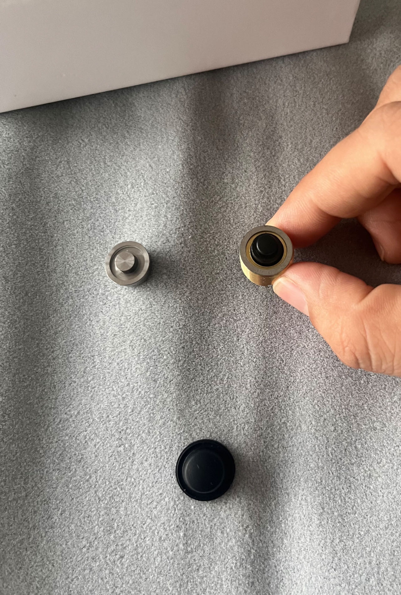

The switch is bad. Not a complete deal breaker, but bad. It is adjustable but none of the settings make it firm and functional. Too tight and the light doe snot come on, too little and the switch is too sloppy. There is little horizontal play but vertical play and everything just feels loose. An eraser between the button and the boot makes it a little better. The titanium button is gritty (as to be expected) but copper is nice and smooth (for what it is). Once it is adjusted, it keeps that adjustment for the most part but may become loose after several battery changes.
A couple of little touch up and a button fix would really make this light shine like it should. EDOLUC has been responsive in general so with a few changes this could be an excellent budget custom.

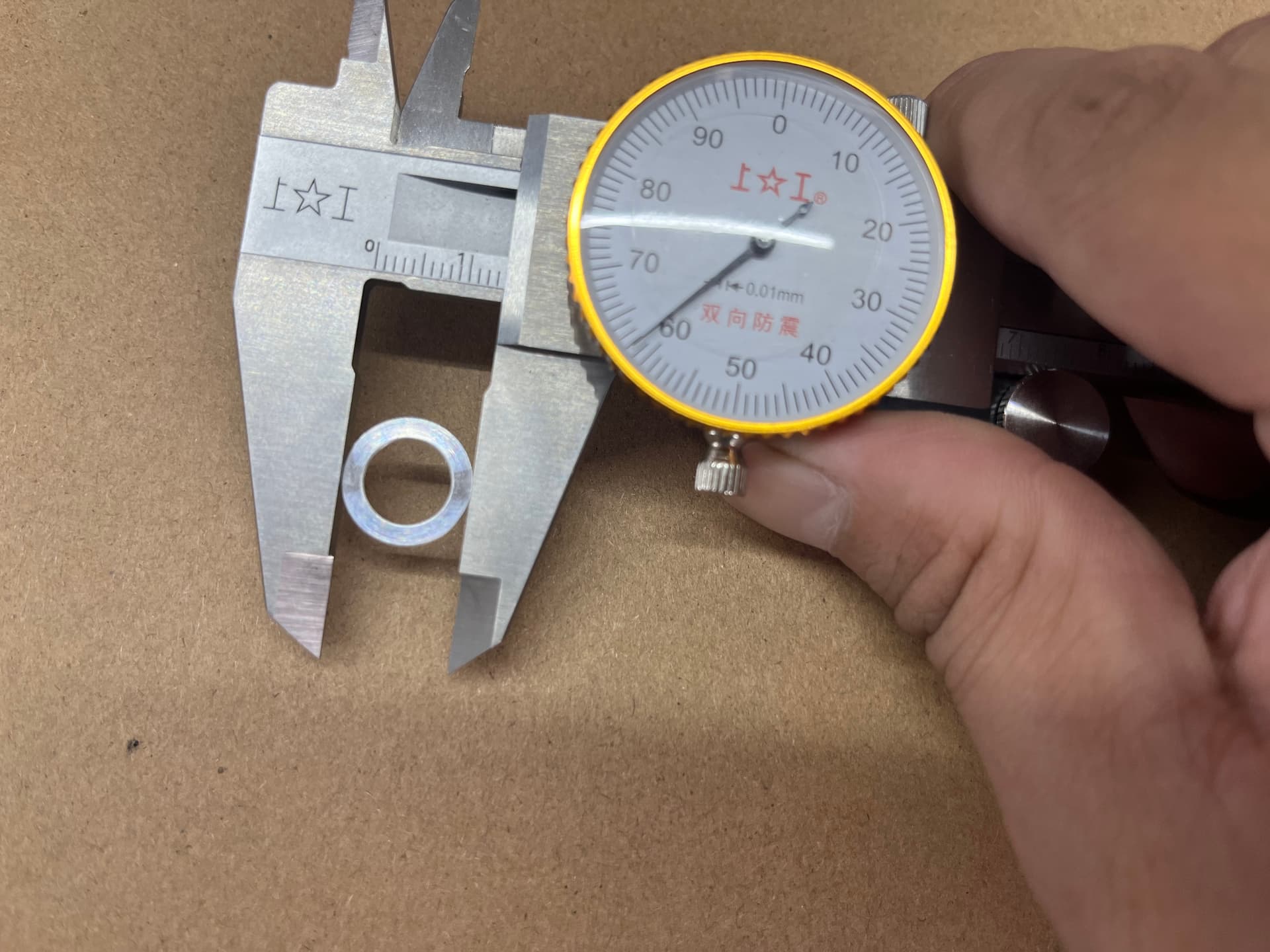

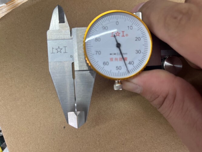

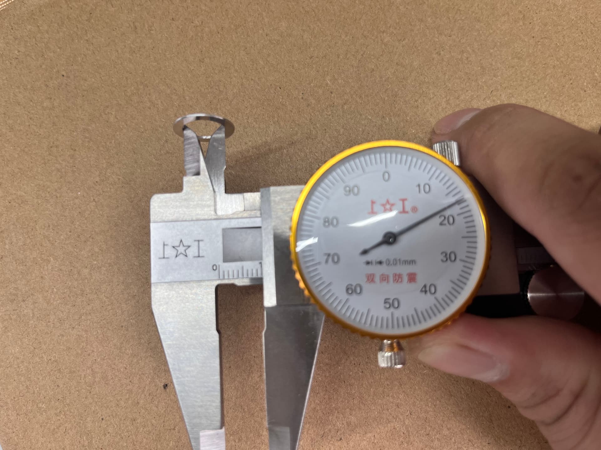

Yes,We are now adding a 2mm spacer to the black rubber cap inside the flashlight to resolve the switch malfunction issue.

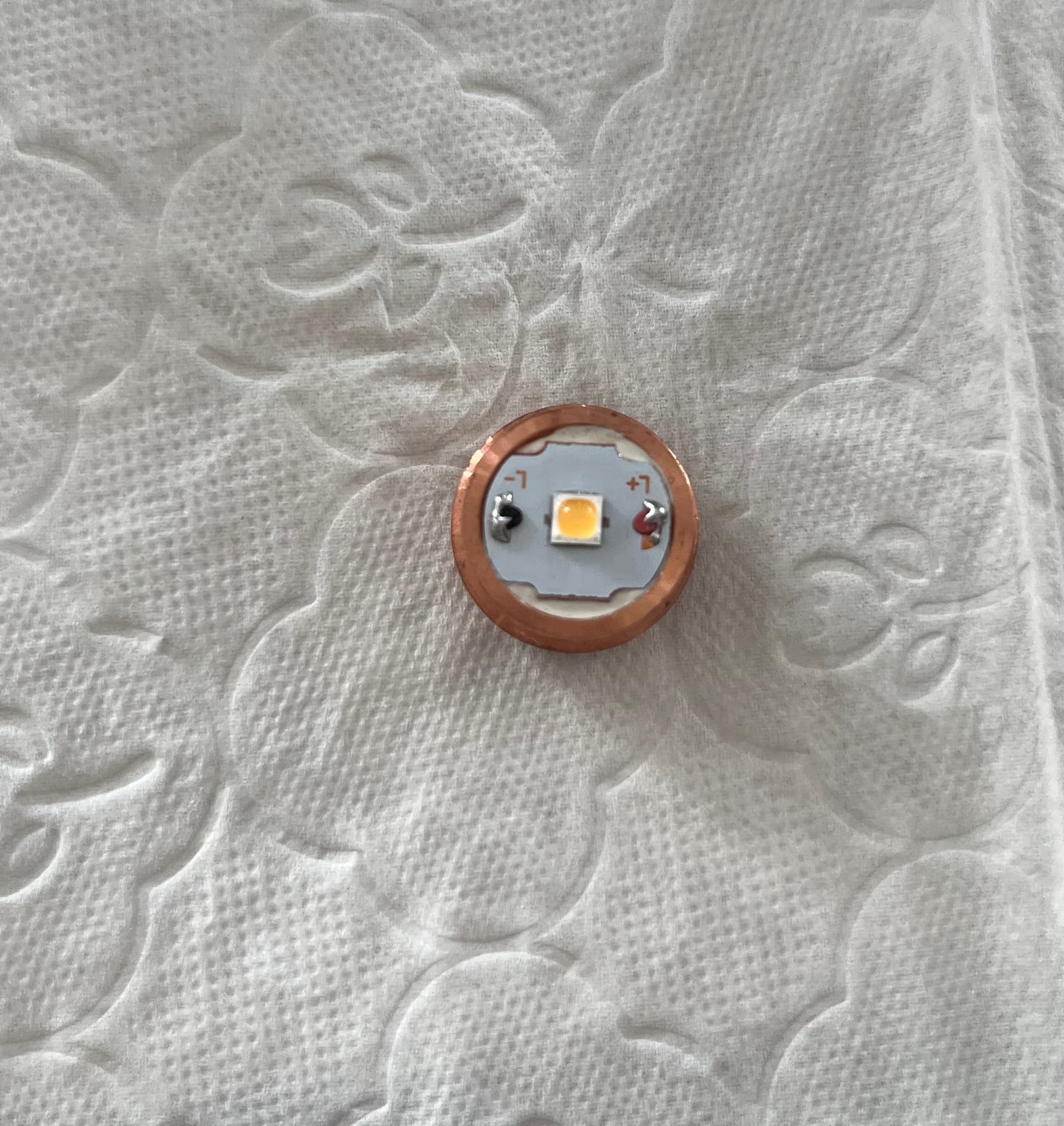

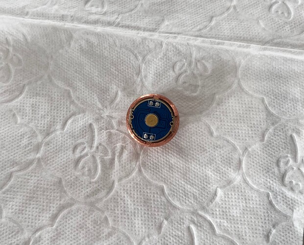

Yes, if you need the pills, please contact our sales team directly via email or reach out to us on Facebook.
Could you post a picture of your fix? Is this applicable to the lights you have sent out already?
Here’s attached for your reference.
I’m sorry I meant the 2mm spacer for the switch so we may be able to fix the switch ourselves.
How low is the new moonlight on the new driver?
Oh, please find attached. I has test it ok.
Now the moonlight just 1 luminan
