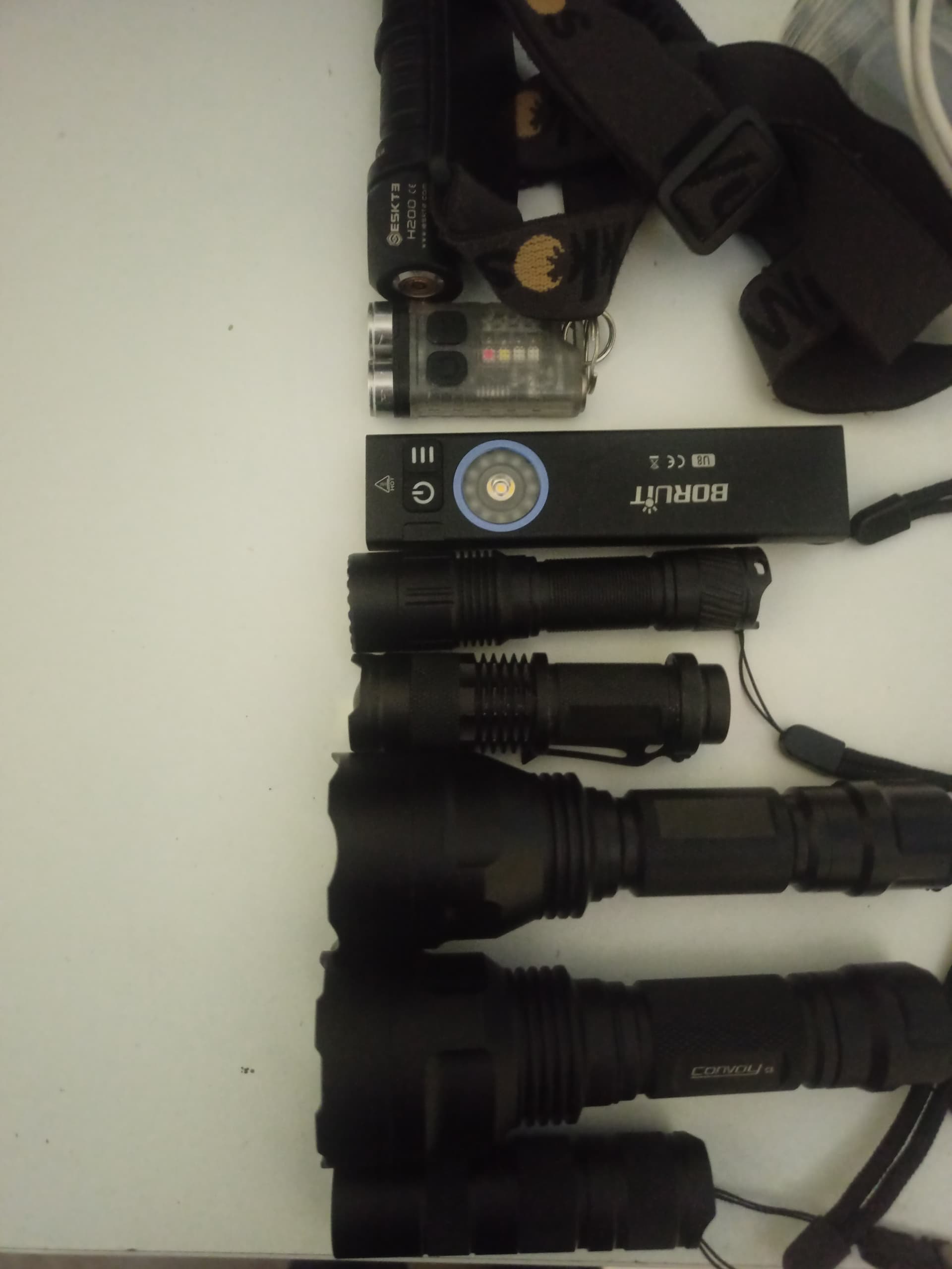

Cant live without lanyard
What should I add next to this?

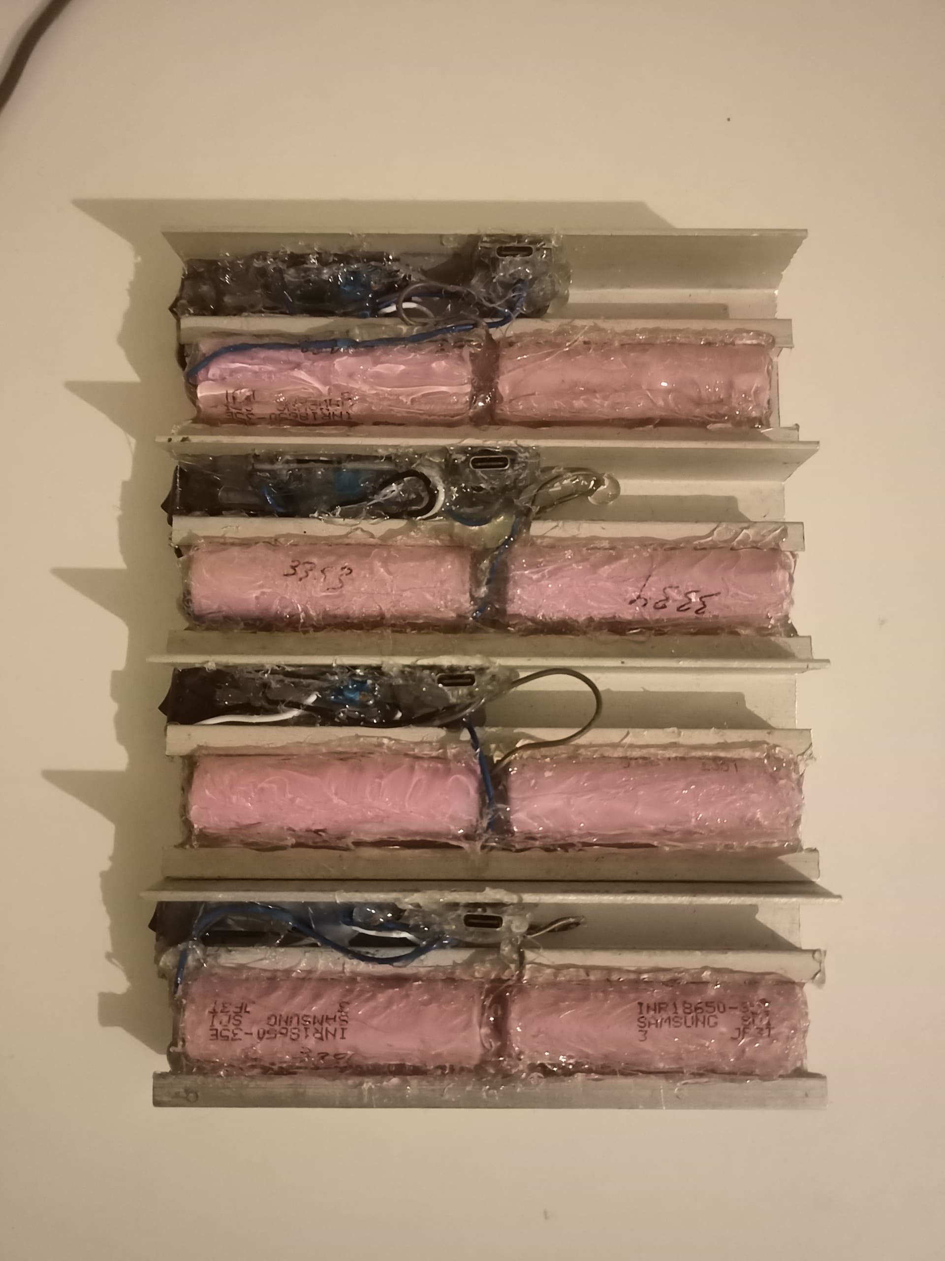

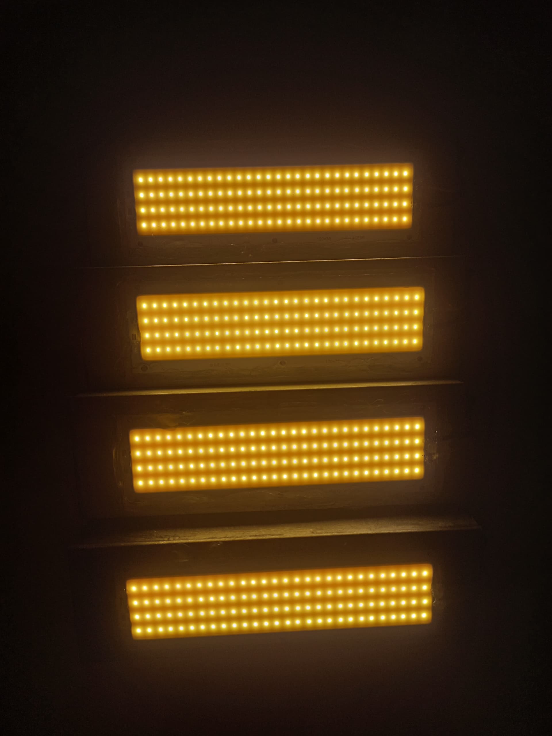

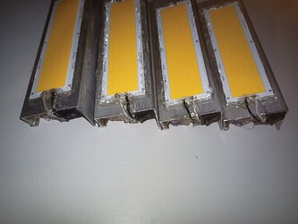

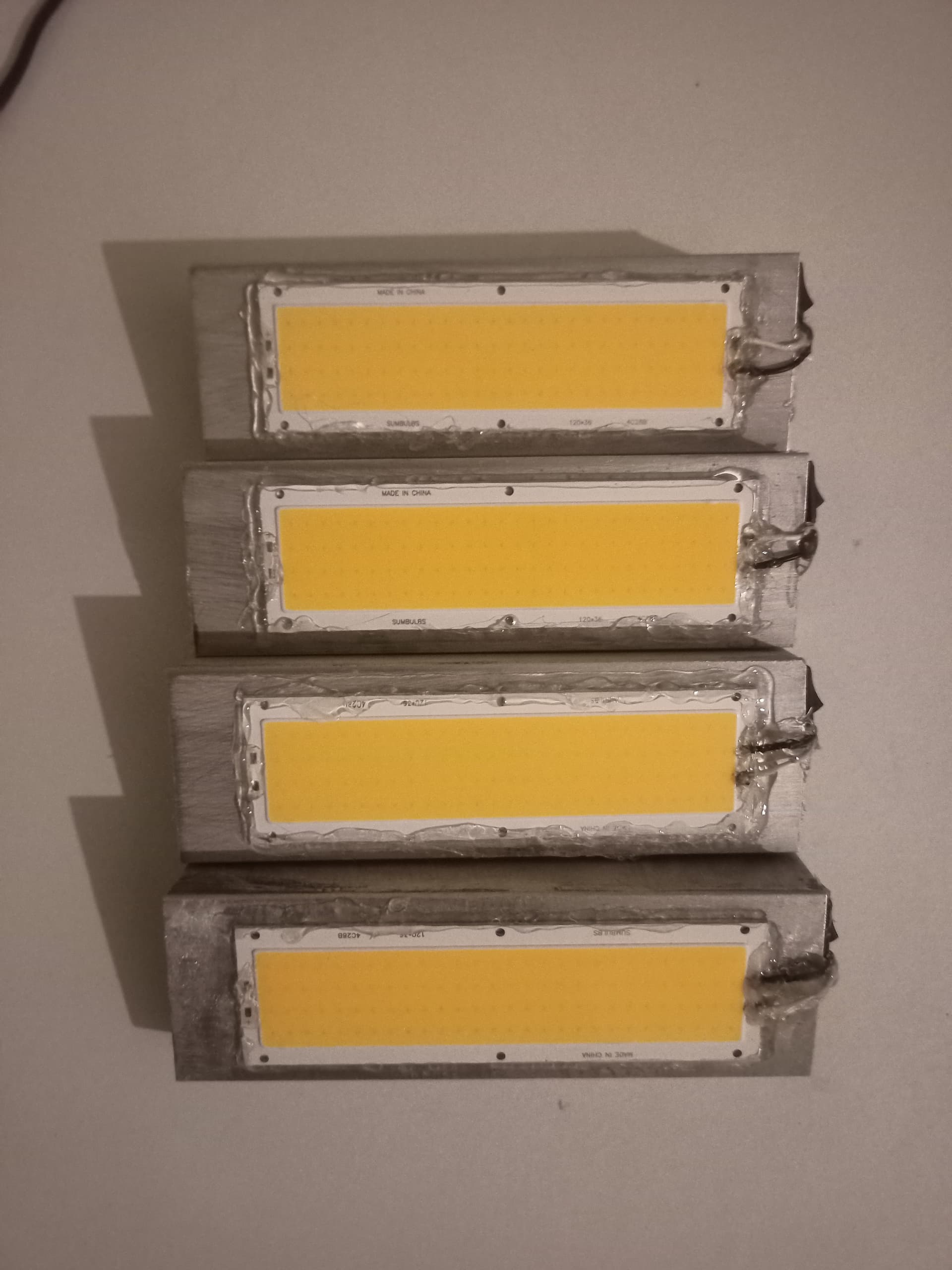

Some time ago I made these simple COB flashlights on 15cm pieces of aluminum cornice as a radiator
Sumbulbs 120x36 12V 12W 3000K R80 LEDs underdriven to 3W(~300 lm) in order to not overheat
The cheapest 1A switch

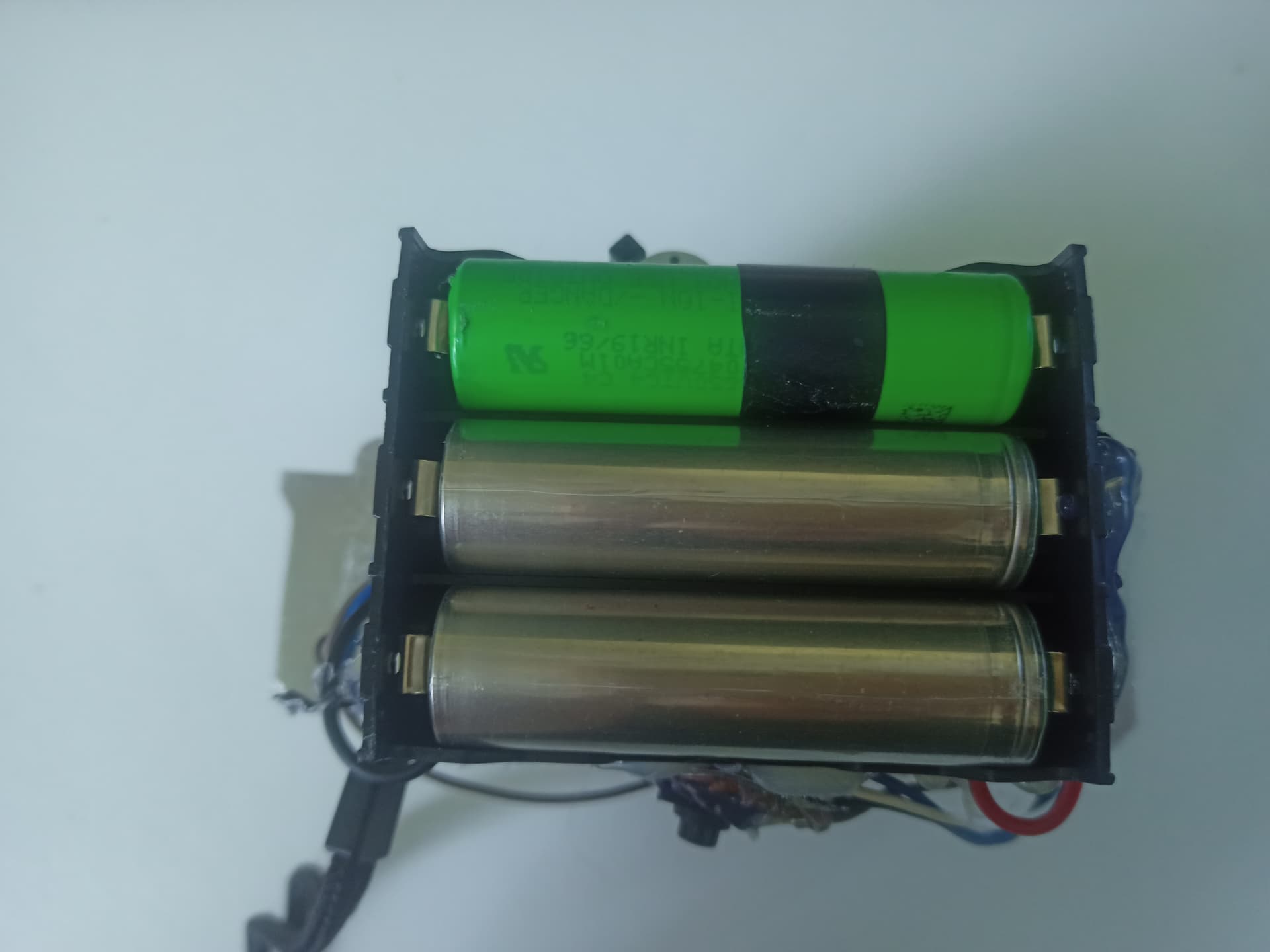

Bought 8 used Samsung INR18650 35E for ~2$ each, connected in parallel.
TP4056 Type-C board for charging and protection
MT3608 constant current boost module
Everything is held by a hot glue, there’s some thermal paste under the LED.
Doesn’t that thermal glue soften due to heat produced by LEDs?

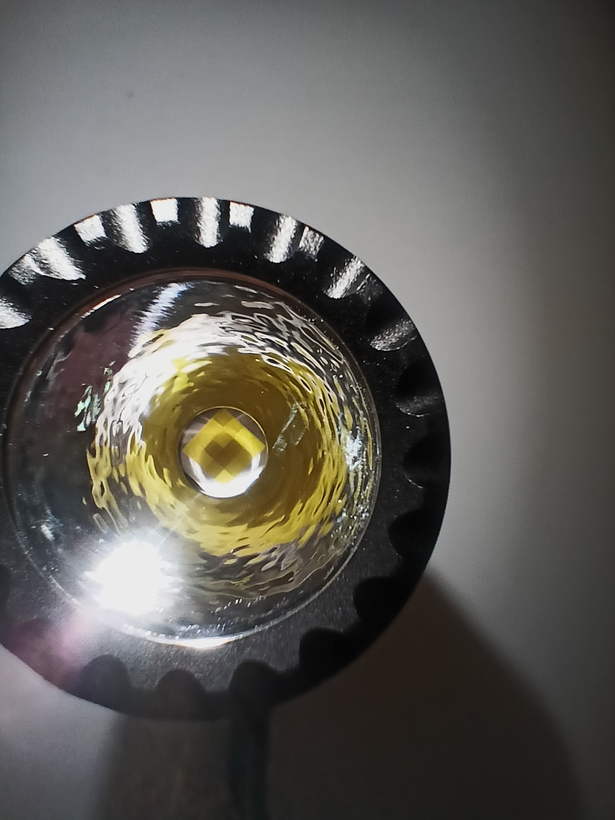

LMP LML2AW.DC 3000K, Convoy S2+ smooth reflector, glass and GITD o-ring

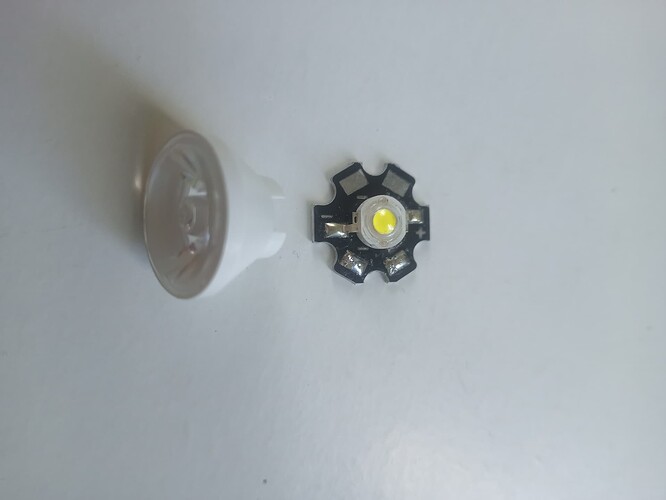

LED&TIR it had before
Depends on the type of glue, but at relatively low temperatures(under 80C) nothing happens

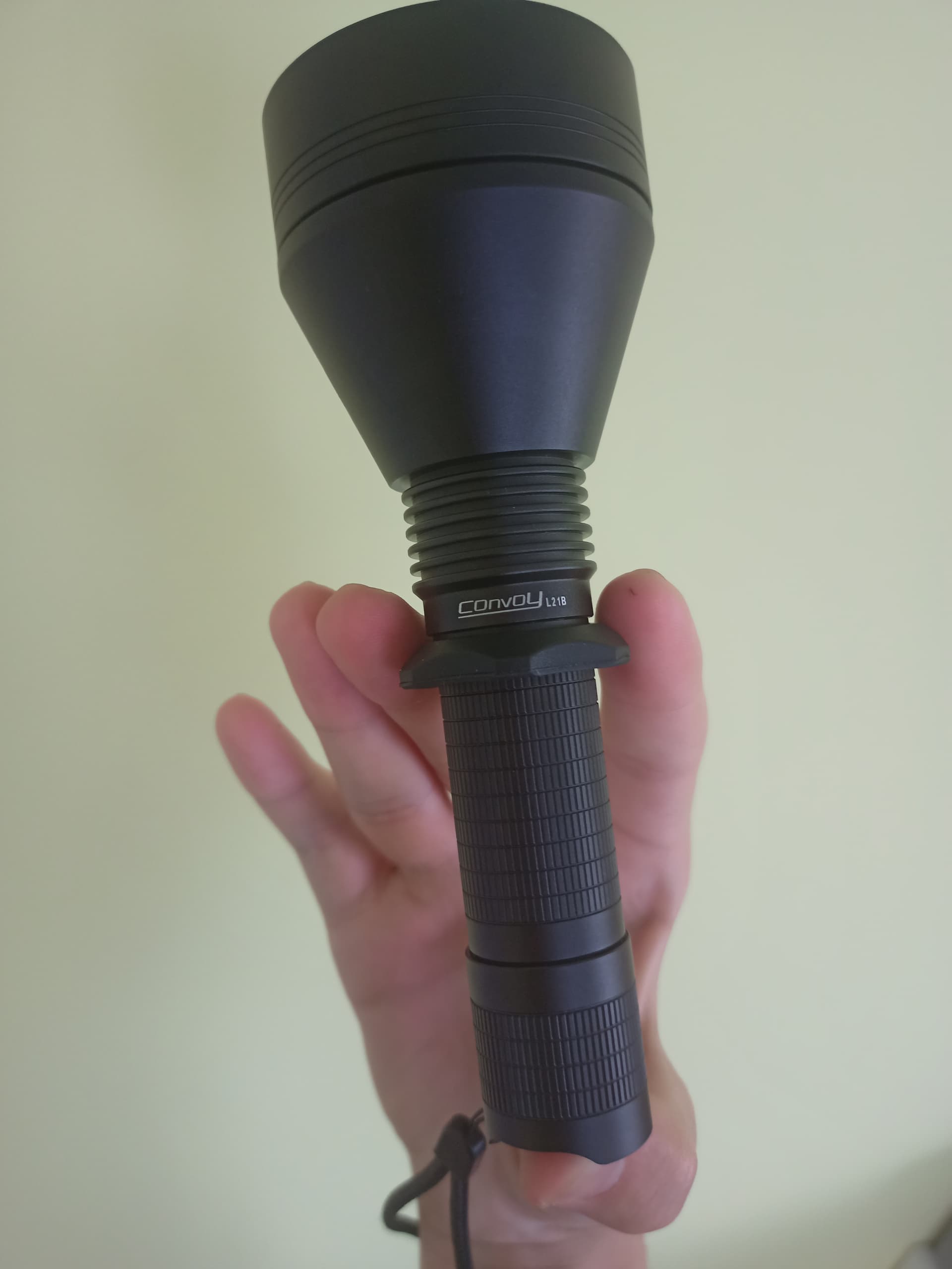

Convoy L21B buck10A w “XND HP HI 70” from Mateminco

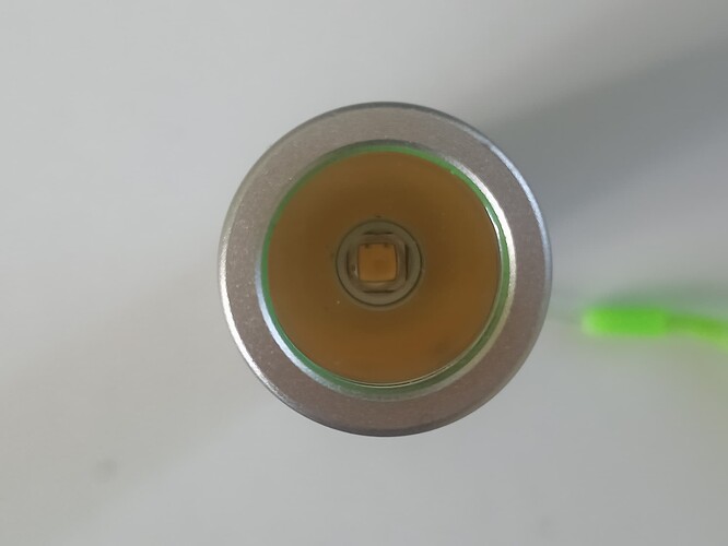

The LED die is kinda off to the side
I’m not that great at reflowing.. flux everywhere.

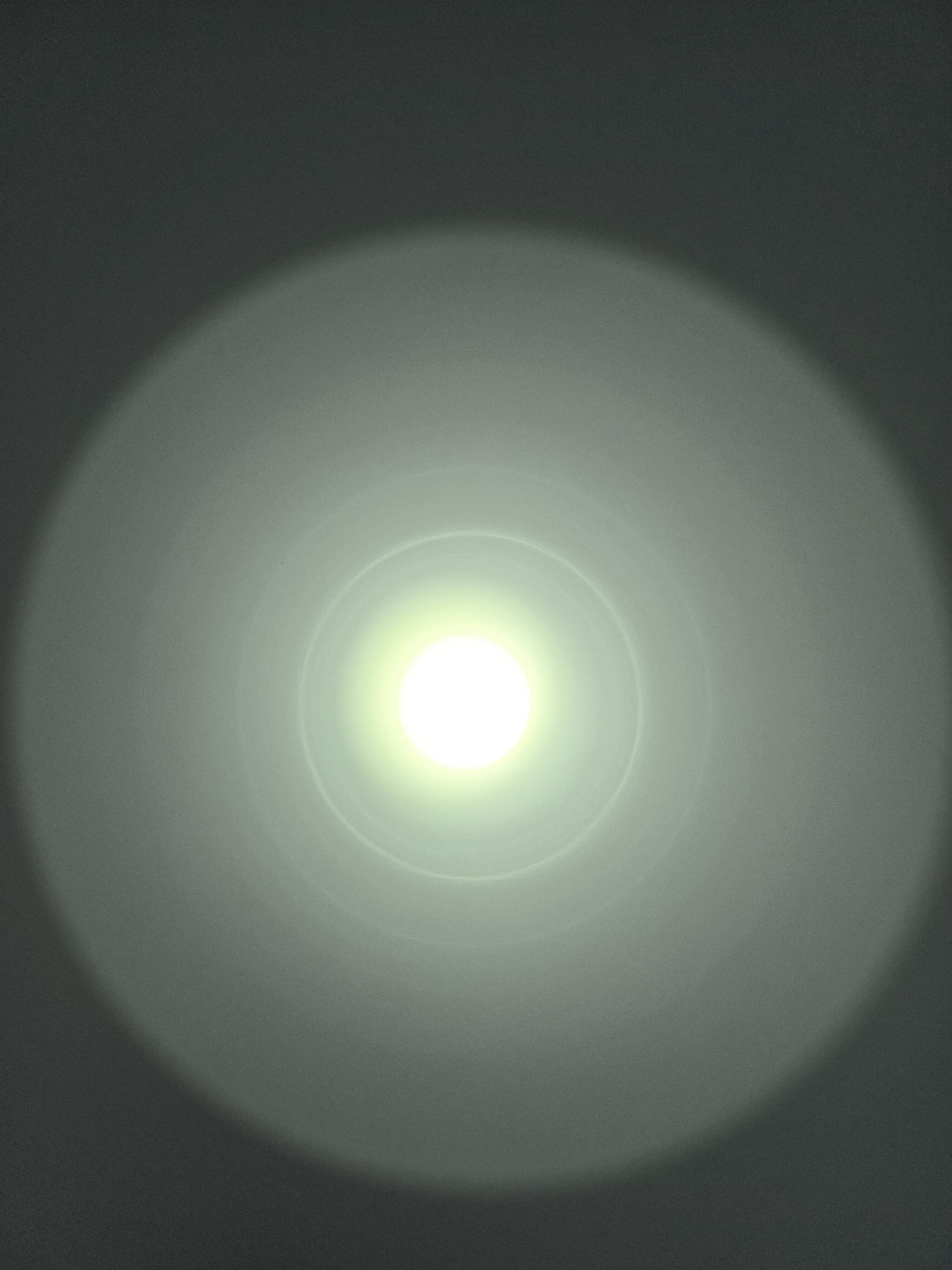

Really throwy, can’t look at the hotspot at a few meters. I hope to post better beamshots soon
L21B

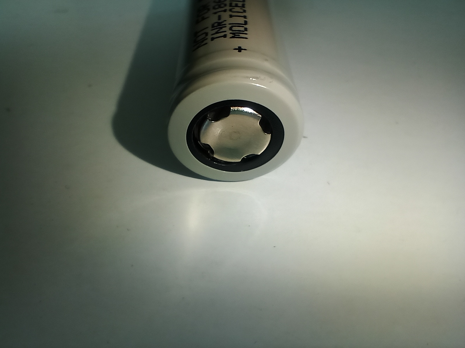

Discounted Molibent P30B grade B

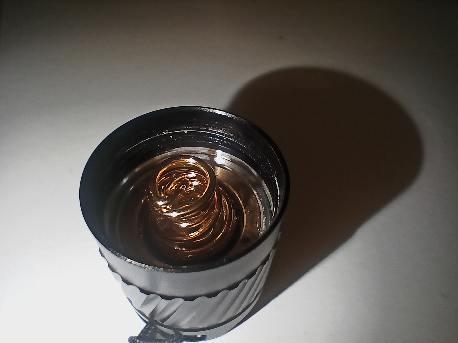

Smaller and shorter switch spring to prevent short circuit

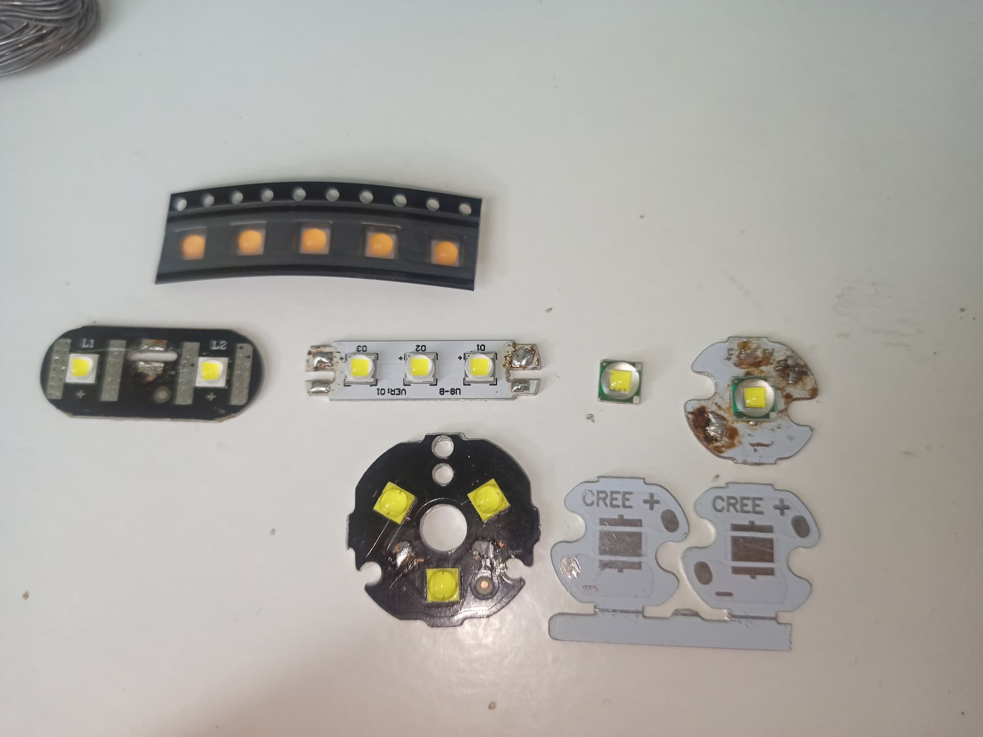

Made some reflows finally

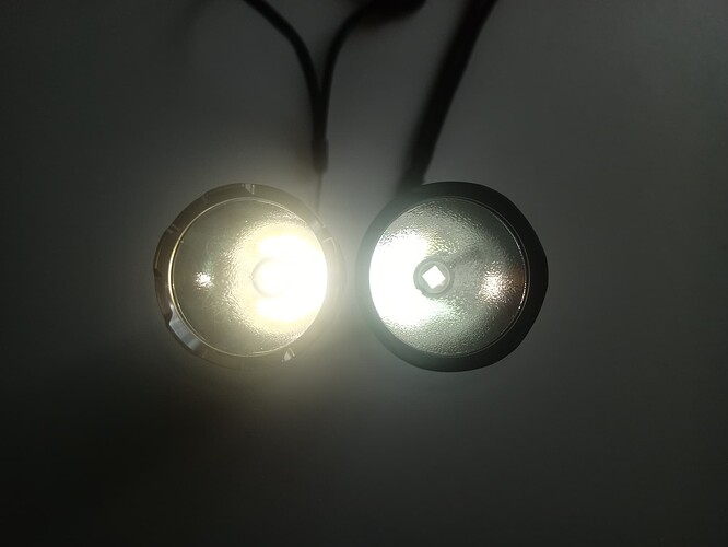

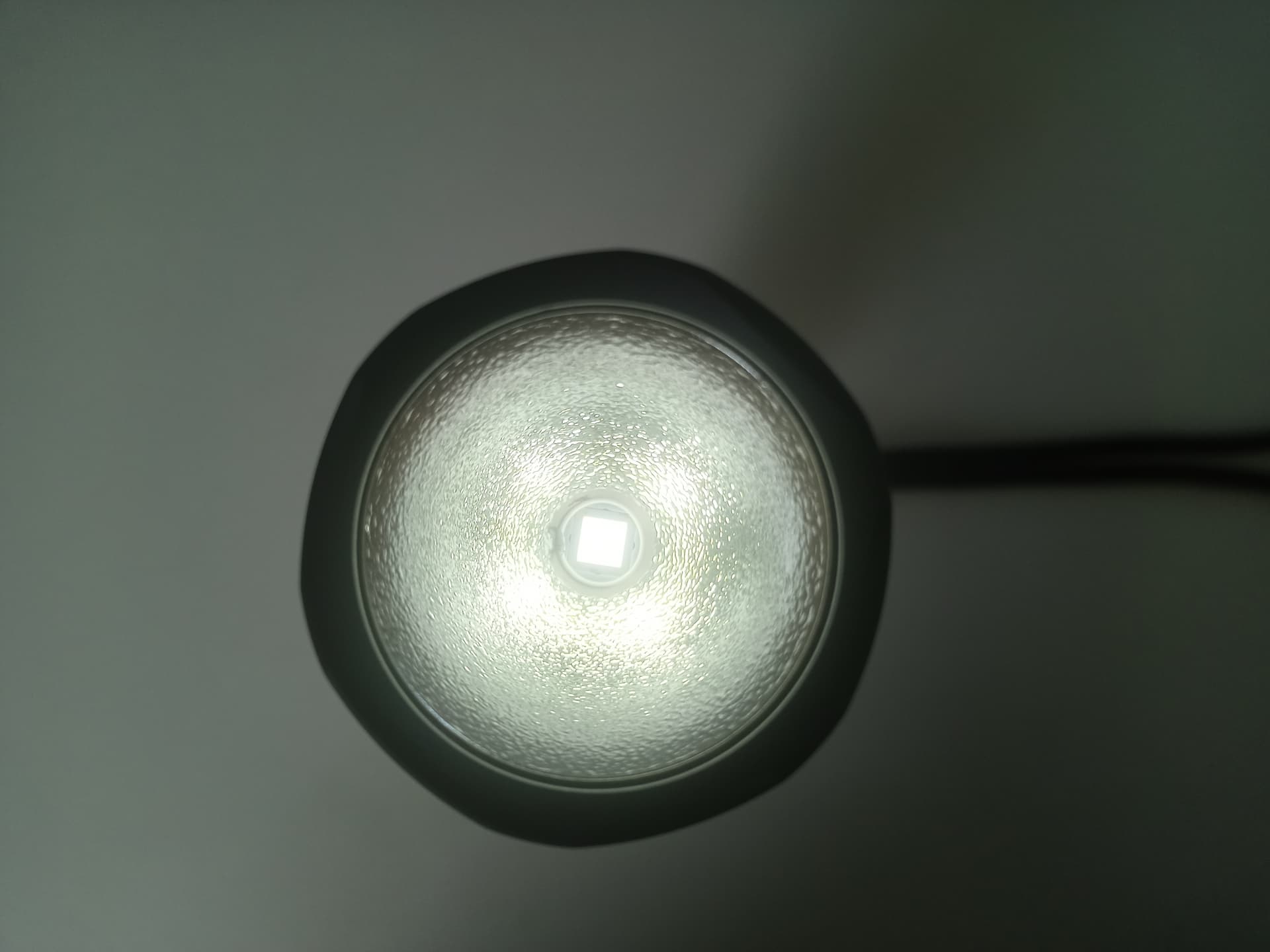

From now on my Boruits(V3 and U8) have 519a 3000K in them, somehow they are rosier than the same one in Skilhunt H200, maybe a different bin was used
It is possible that the different optic is making the difference. By inspection, the Skilhunt optic looks like the type to produce a green hotspot and purple spill, while the Boruit flat triple optic appear almost mule-like, which tends to make a rosy beam.

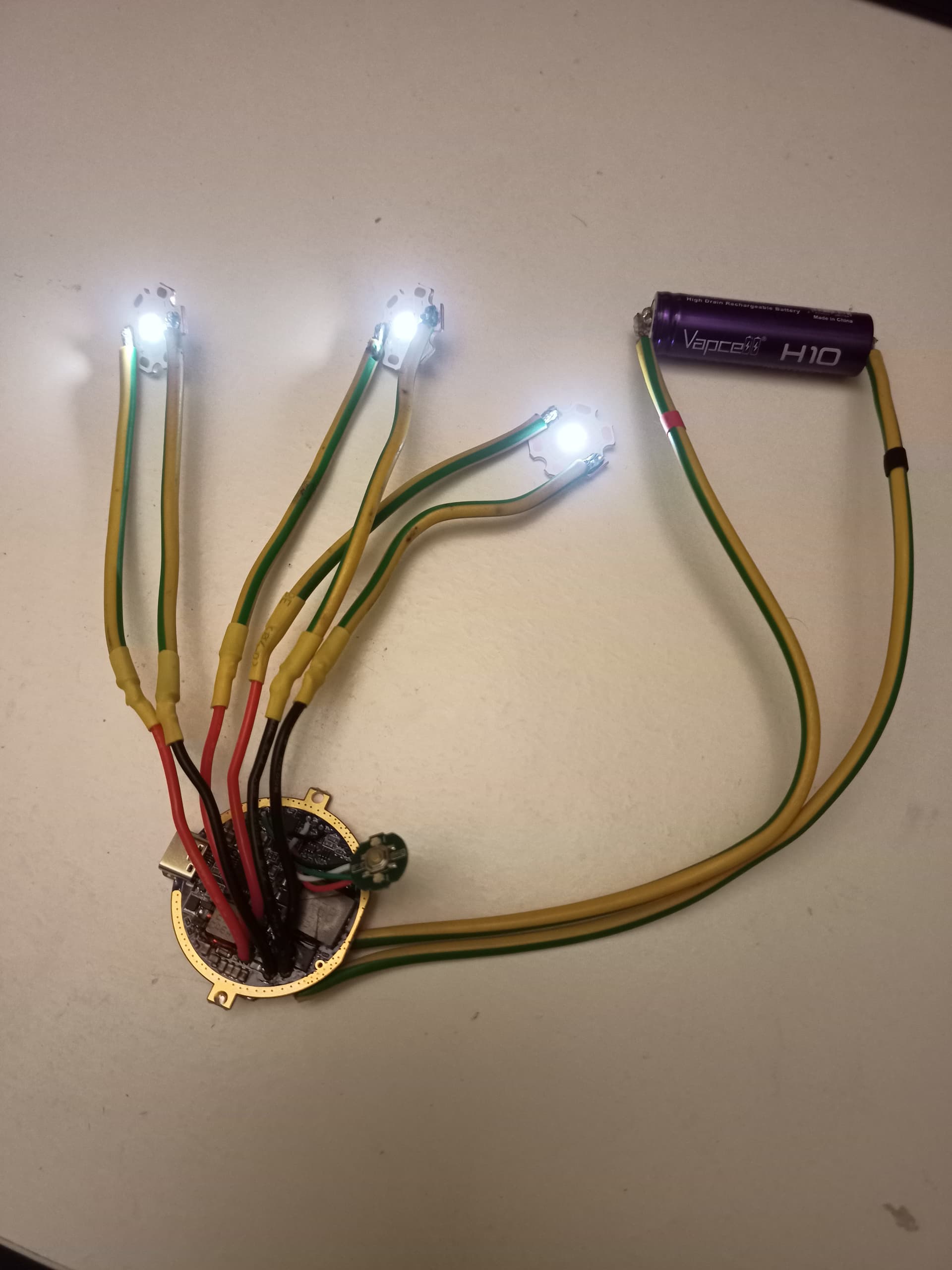

3xLHP531, buck25A+FET driver, bad batch Vapcell H10 soon to be disposed
