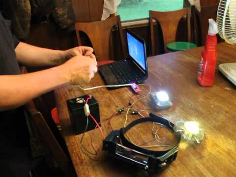

have switch, pvc pipe and endcaps… one led installed into endcap… working on second one… pictures were taken, will upload them and post them soon.
images
12volt to 5volt adjustable voltage regulator
the two drivers, one modified for pwm input
front of driver board it uses a pt4115 driver chip, pin 8 is the pwm input, pin 4-7 is ground of the pwm input. so connect a wire from anyone of those to the ground of your pwm signal ![]()
schematic of the driver board some values are guesses.
the 2 10 watt leds, one cool white, one warm white. yes. I’m mixing tints… we shall see what happens ![]()
