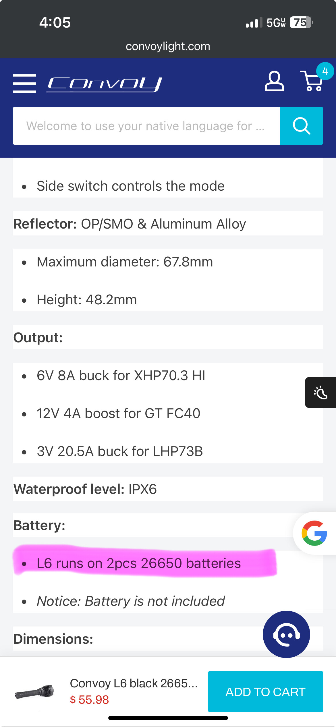

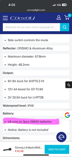

The current L6 listing doesn’t specify Protected/Unprotected:
That’s what I read.
