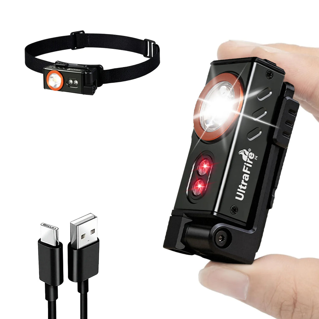

These are my impressions of the UltraFire P4 EDC Magnetic Headlamp that I just received from them. Given that I don’t have the proper testing equipment, or the necessary analytical skills, I can only offer my thoughts on it.
The light, headband, USB-A to USC-C cable, and user manual arrived contained inside of a small nylon case. This is a nice feature since everything can be stored together when traveling or storing the light.

The charge port is located next to the switch and is covered by a typical port cover. It will charge using either a USB-A to USB-C charger or a USB-C to USB-C charger. I measured .55A when charging from a 5V USB-A charger. A red light is on when the light is charging and turns off when charging is completed.

The light has a wide range of motion which makes it very useful in certain scenarios (example, hanging it on your car’s hood when looking at an engine issue at night). The ratchet teeth are strong enough to prevent the body from moving when it has been tilted into the desired position.
The light is stable when the base is placed on a non-metallic level surface, unless it’s been tilted to an extreme amount. On a metallic surface the light is held securely in any position.

The strap is comfortable enough when the light is connected to it given its light weight.
The full range of tilting is available when the headlamp is connected to the strap.
The light slides easily into the strap mount. However there is nothing holding the 2 together other than friction. I was able to separate the light from the mount just by shaking it vigorously. This would definitely be a problem if doing something such as jogging or biking. It needs some kind of locking mechanism that has to be disengaged in order for the light to slide free from the mount.
However I didn’t have any problems with the light coming free when walking around or using the light in more sedate activities.
