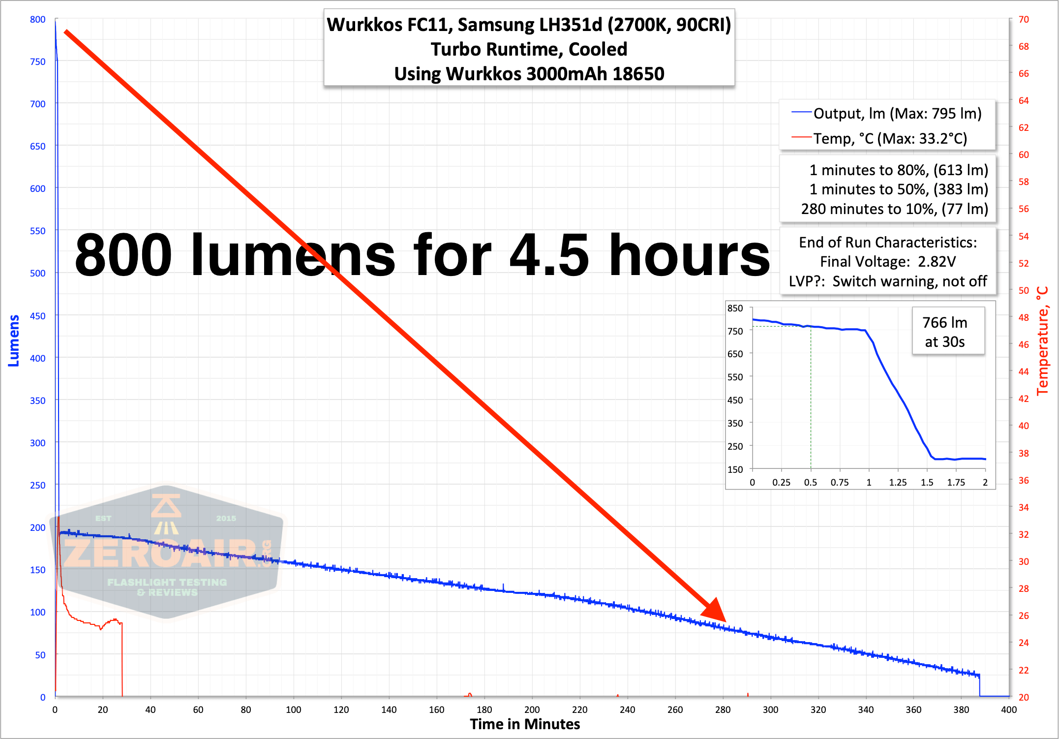

agree… that is from starting output until it declines to 10%… looks like this for example:
so, the LED lenser claim could be technically true if it uses a 6000mAh battery

Almost all manufactures state something like this, 5000L for 5 hours, but not mentioning any thermal throttling/regulating down. Some say 5000L + 1500L for 1.5H.
Acebeam’s latest light the L16.2 says 2100-1000L - Time 60s+2H, so yes they can blur the line.
Zebralight is known for some of the best regulation lights, take their H600d headlamp with a 18650 and of course less mass, * High: H1 1616 Lm (PID, 2.5 hrs) or H2 1010 Lm (PID, 2.9 hrs)/579 Lm (PID, 3.1 hrs)/305 Lm (5.3 hrs) I guess they try to quote the highest possible output.
Ledlenser might be quoting 10H with all the auto heat throttling and auto dimming? Nothing really is ever perfect for a light nerd :0) like me!
