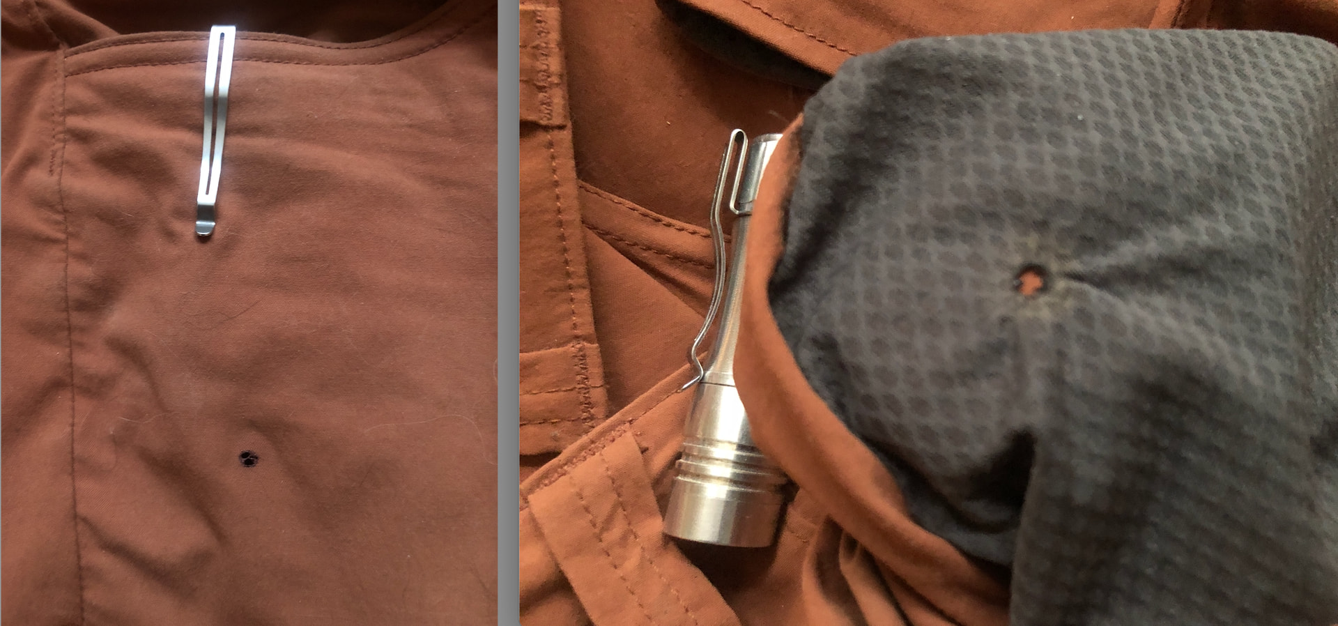

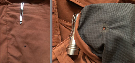

My KR1AA V1 melted a hole in my Nylon/Spandex hiking pants because I did not use Lockout while using LiIon.
The ceiling was set to 120/150 = 650 lm = 400°F. Turbo was disabled. Temperature and output testing details here.

I dont know what output the light was on at, nor for how long. I had been sitting at my desk with the light clipped inside my right front pocket. My cat had been on my lap.
I dont know if she had pressed the button.
I then got undressed to take a shower and left the pants on my bed. I did not notice if the light was on.
When I got out of the shower and went to get dressed, I noticed the light was On in the pants pocket, but I did not check at how many lumens. I dont know if the light was ramped up to its ceiling or not. I wish I had checked the lumens before turning the light off. But it did not look very bright. I suspect thermal stepdown had reduced the output and prevented a more extensive burn.
There is a small hole melted into the grey mesh that lines the inside of the pocket, and also a small hole in the outside of the pants.
I had been carrying the light unlocked. I have now implemented a 5 minute auto lock, and have lowered the ceiling to 90/150 = 280 lumens. I dont know if that level can burn a hole in a pocket within that amount of time.
The pants are made of 96% nylon and 4% spandex.

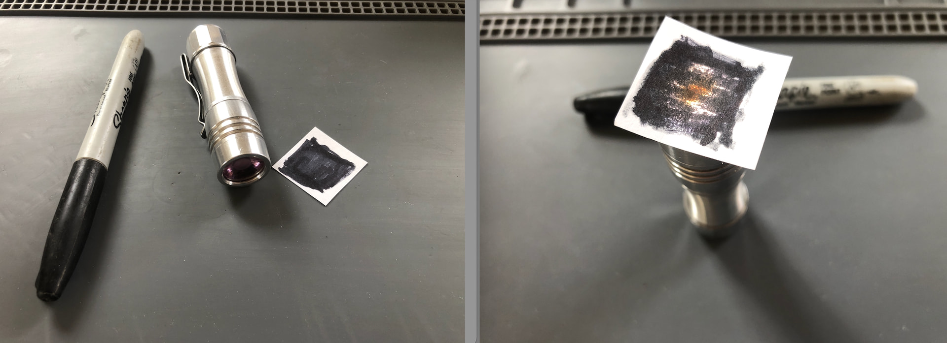

Initial Testing sequence:
I used a black sharpie to make a piece of printer paper black. Then did some tests at different ceiling levels.
Starting with the freshly applied black marker
at 80/150 = 170 lumens no smoke after 1 minute
at 90/150 = 270 lumens, paper started smoking within 5 seconds, I think this was the fresh black marker ink vaporizing, but the paper did not burn
at 100/150 = 375 lm, paper started smoking within 10 seconds, I think this was the fresh black marker ink vaporizing, but the paper did not burn
at 110/150 = 520 lm the paper started smoking after 10 sec, I think this was the black marker vaporizing but no actual paper burn
at 120/150 = 650 lm.. the paper started smoking immediately, I think this was the black marker vaporizing but no actual paper burn
After those tests, I did not add fresh black sharpie ink.. So the following tests used the same paper but after some or most of the fresh sharpie ink (or its carrier solvent) had evaporated or dried.

Testing Setup Pic:
On left is the paper with fresh ink at start of test (ink on both sides of the paper):
On right is the paper at end of test. Notice the paper has browned from using level 120/150, and some of the ink has evaporated or vaporized during testing (the light is On in the photo). When the light is Off the paper still looks black.
