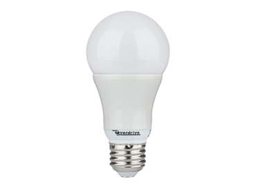

For a diffuser, if you happen to have some dead household led bulbs with covers something like these, you can pry them off carefully and there is a thin lip on the bottom…just a little trimming and it is a great fit on the M3C bezel and a fantastic full flood smooth diffuser. The plastic one Convoy sells is ok. You might also look around for clear textured vinyl window film that could be applied to the lens (DC Fix is one brand here but there are all kinds out there that would serve the purpose).

I don’t like The M3C stock diffuser or Led bulb housing because they will scatter the light backwards, into my eyes. I only want forward looking beam (~120 degrees, same as the camera). I guess I’ll just remove the optics or add that vinyl film.
