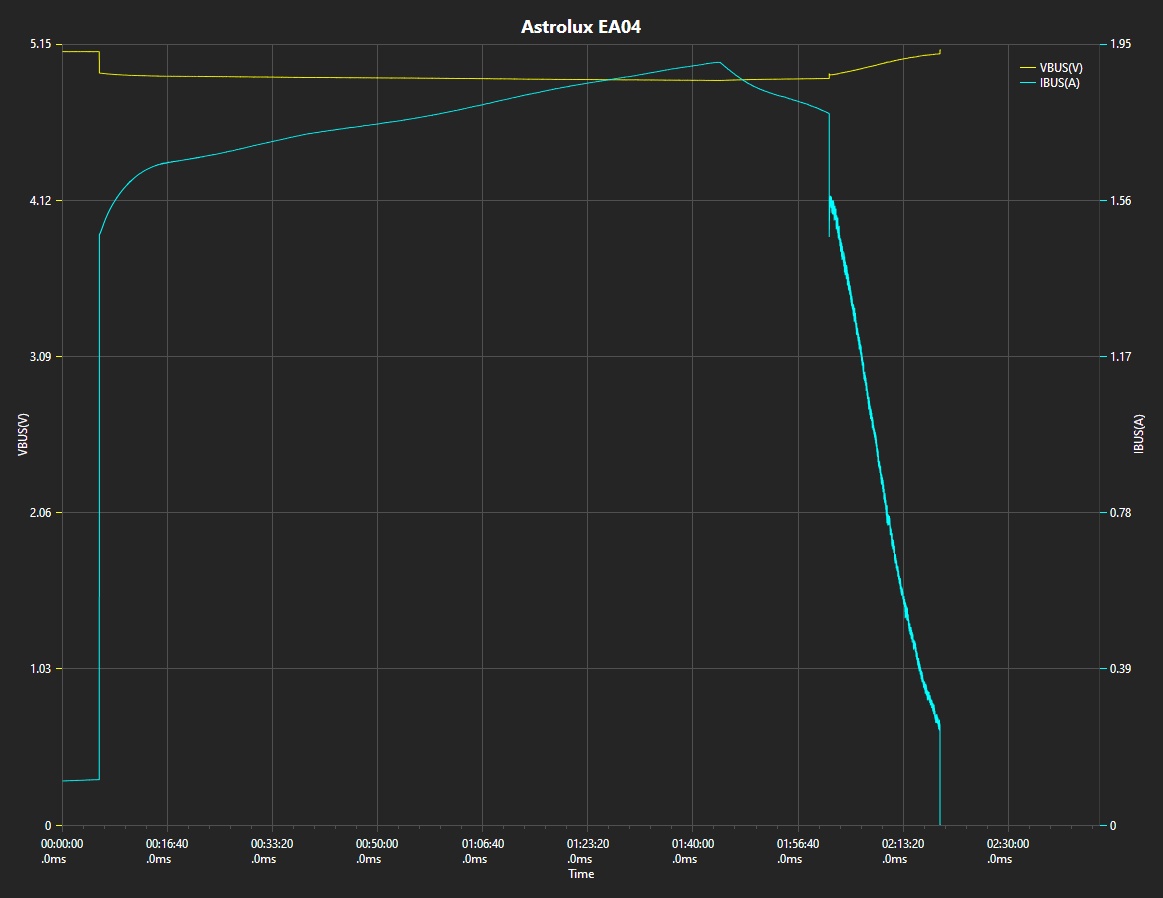

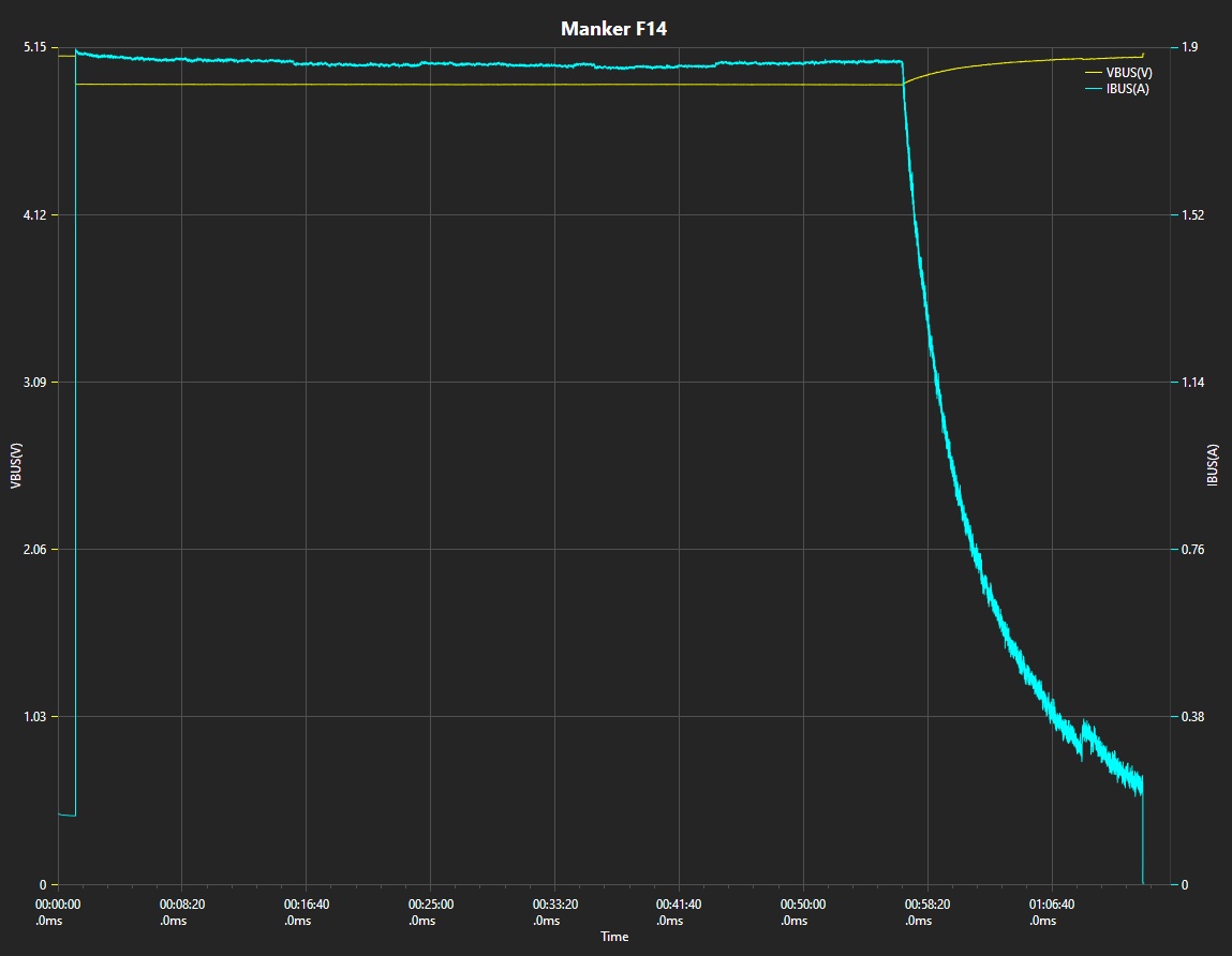

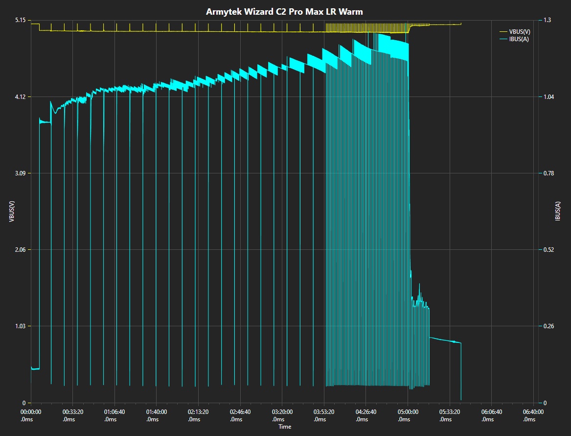

I use an AVHzY CT-3 connected to a Windows PC and take measurements using a micro USB connection. I don’t use Bluetooth.
I tried some RD TC66 and UM25C but the software sometimes resets. This isn’t great when trying to record for hours.
Here’s an example of some graphs:
The software has more measuments (capacity etc).
