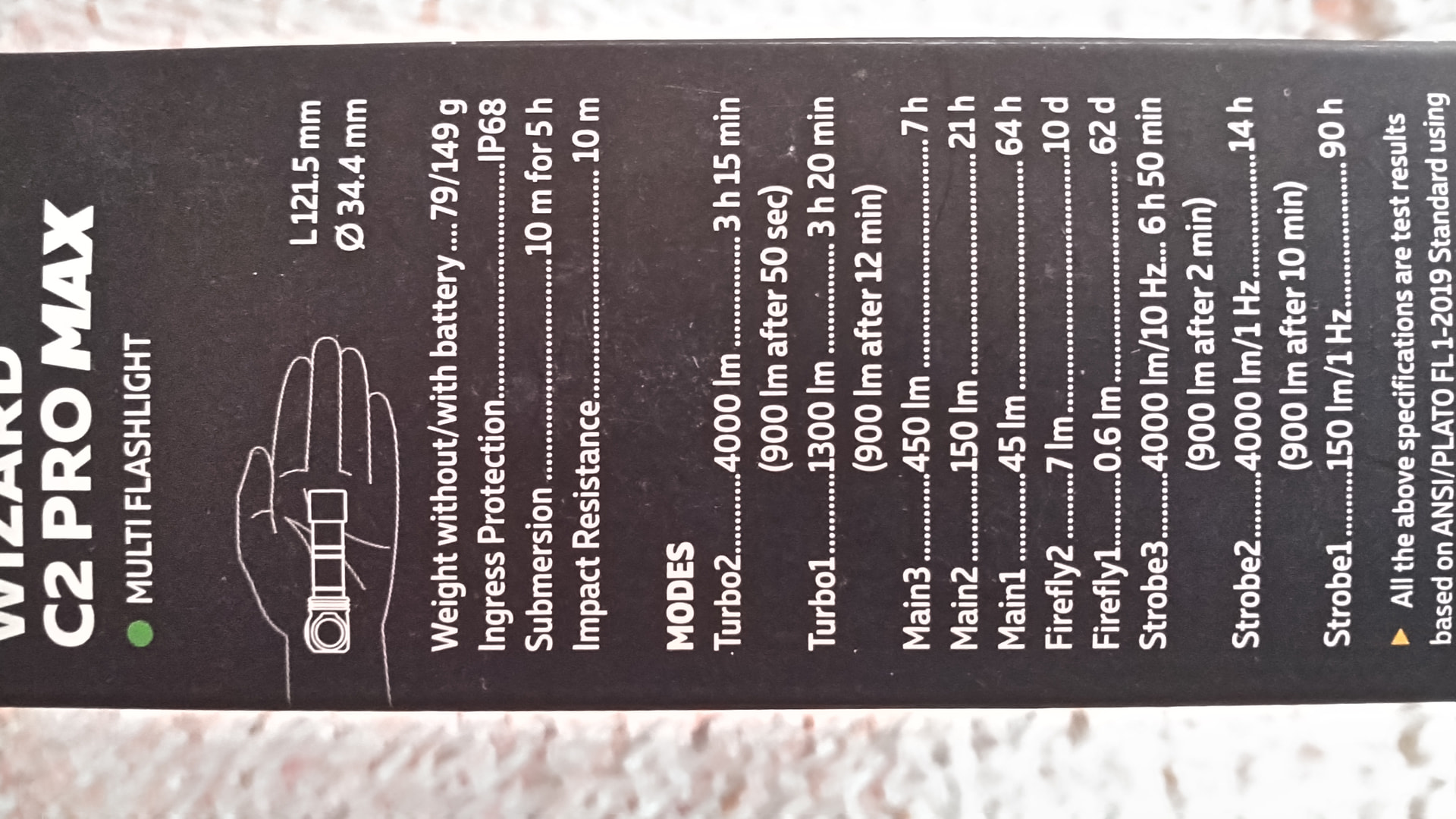

These are the cold white specs on the max.
RRight, 4000lm for 3h 15 min, no effing way, 15 min I’ll believe, but no more, it would either dim on thermal protection, but even if we assume heat is no issues, cuz under water it is not, there is no energy in that cell to run that long, 21700 is 18whr, xph70.2 or .3 which is what they use in that light, makes 4000lm at about 40w, the math does not add up at all. not to mention that company has been caught lying multiple times.
I think you’re missing something.
They claim it will step down to 900 lumens after 50 seconds on turbo 2.
It claims it will step down from turbo 1 after 12 minutes to 900 lumens.
I suspect if you start on turbo 1 (1300 lumens) it won’t step down underwater and you would probably get near 2 hours before the battery is 3/4 empty. I haven’t looked up the amp draw but I could measure it tomorrow. I suspect somebody has tested it. Maybe it’s not really putting out 1300 lumens on turbo 1.
Either way he’s going to get more light and longer run times than the zebra light that he’s currently using.
Yea I missed that 900lm “fine print” but still not seeing any point. he only has 50 seconds of 4000lm, then it drops to what his current ZL makes. turbos are on timer, whether hot or cold, high mode can run as long as temperature allows. He needs something that makes 4000lm or so on high, so it stays 4000 as long as he makes videos.
It’s a bit frustrating when reading all the “Turbo” specs because it leads one to believe that the light can actually sustain that output for a reasonable amount of useful time. In reality, some of those “Turbo” times are a joke.
Imagine a light that claims 15,000 lumens but it only lasts for 5 seconds.
I think you have a good understanding of what my needs are, but given that my current ZL starts out with 1,700 lumens, and works pretty good, I was thinking that even 3,000 lumens would be a major improvement.
But I am also wondering, will a 3,000 lumen light from anther brand, which steps down faster, actually be any better than a ZL that starts out with 1,700 lumens, which steps down slower. It’s that step down period that keeps me from just buying based on lumens.
I also should have mentioned that I generally only record video for 2-5 minutes at a time. And the water is typically in the 50-75 degree range. So a nice broad flood of light, around 2,500 lumens or more, if possible, for about 5 minutes, is all I need.
