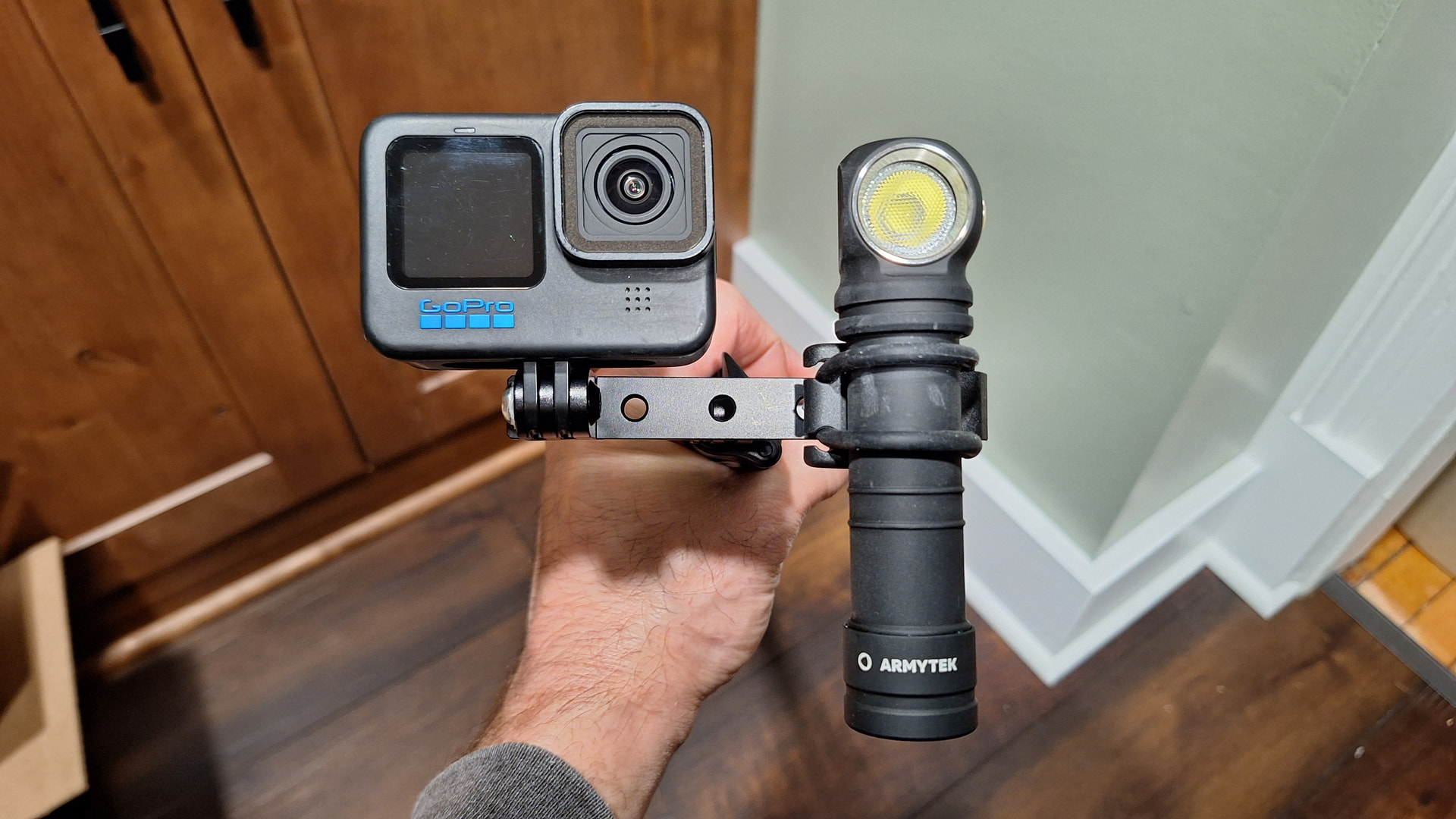

Olight’s clever little FB-1 bike mount works perfect for mounting this light to the end of my pole. So no need to waste time designing something. Very happy about that!
Interesting, not seen this before, and can’t find any reviews; it appears the angle (rotation) can be adjusted, is this a friction mechanism allowing infinite adjustment, or does the bracket have “steps” of adjustment, or is it only capable of 0°/90°?
At the moment I use twofish lock-block rubber and velcro mounts, which are actually very good, albeit non-adjustable.
These are excellent little mounts that have very thick rubber bands that secure the unit to whatever (handlebars, etc.), and the light to the unit, allowing for infinite adjustment.
The unit can be rotated 90 degrees for either style of light - straight or angled. There is one single screw that holds the two halves tightly together, but there is also a raised square male protrusion that fits into the female square of the other half, making it impossible to rotate due to a loose screw.
They even send 2 sizes of rubber bands - so a total of 4 bands. They even include a nice solid little L-shaped Allen wrench which has a Phillips on the one end.
It’s an impressive little mount for the price.
I must admit though, I will be very hesitant the first time I use my GoPro pole setup, knowing that the only thing holding my new Armytek light to the end of the pole is a thick rubber band. Ha! But it’s THICK! And it secures well.

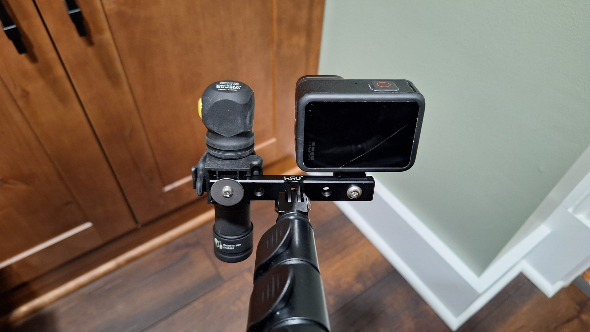

I just wanted to thank you again for taking the time to help me out.

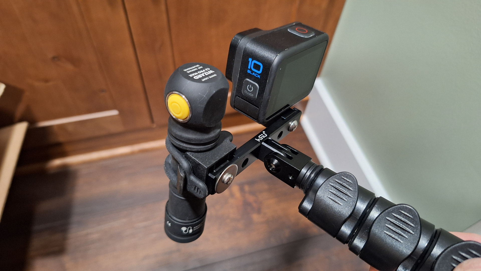

After some minor modifications to some attachments, I think I finally found the perfect set up for my use.

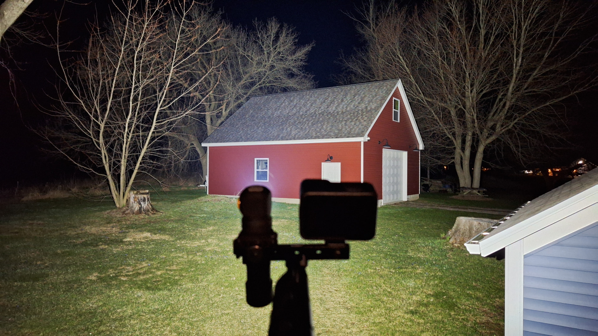

You were right. This thing is BRIGHT and FLOODY. Exactly what I was wanting.
We’ll see how it does at the lake, under water.

Also, while the GoPro and new ArmyTek light look to be securely attached to the cross bar, it wouldn’t hurt to add a zip tie around the light & bar. In fact, keeping several zip ties of varying sizes in your tackle box or your vehicle’s glove box is always a good idea!

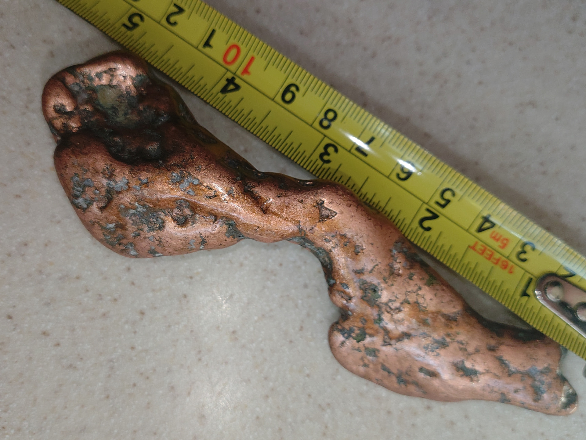

I am not from that area but I did very briefly swim on the Canadian side of Lake Superior. And one of my top five or 10 most memorable 4x4 van camping spots was about 3/4 of a mile south of Gay Michigan in the UP. This was on the stamp sand Beach right on Lake Superior. It was probably August, 20 years ago. The history of dumping all of the stamp sands into the lake is interesting but it causes multiple environmental issues. The "sands"came from Rock crushing Mills that were extracting copper from rocks. The Rock came from copper mines some miles away. For those not familiar with the area, if you want to understand it better just search “stamp sands Gay Michigan”.
This is a copper nugget that I got from one of the many Rock shops in Michigan.
I will certainly consider the zip tie idea, because it’s a good one!
I tend to tweak things as I put them into actual use. Some of the things I thought would be good ideas, turned out to be problematic in some way or another, for me anyway. E.g. my last set up with my Zebralight, I had it secured with a stainless steel hose clamp, only to find that I didn’t really like not being able to quickly remove the light.
Zip ties are incredibly strong for their size and weight, and they are part of my emergency pack while snowshoe camping, so that would definitely be an option for sure.
I normally would not rely on any rubber band method, but after seeing these mounts in person, I am much more confident in relying on them, because of how thick they are.
