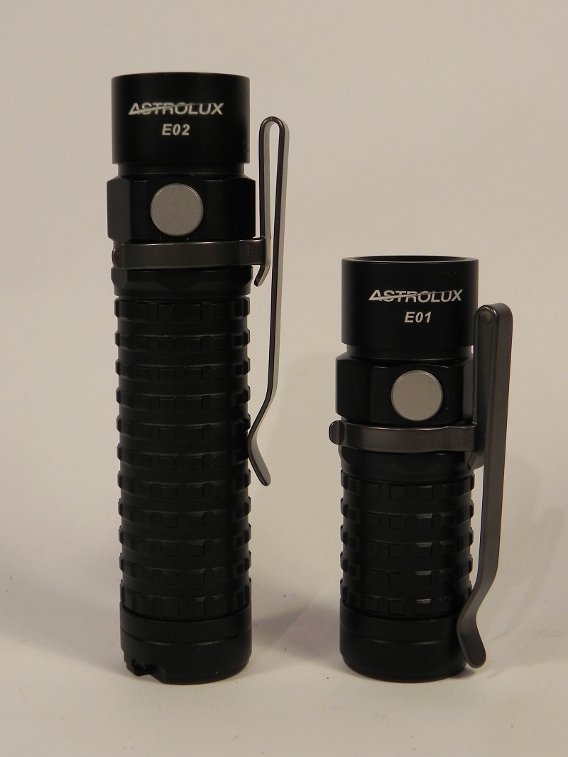

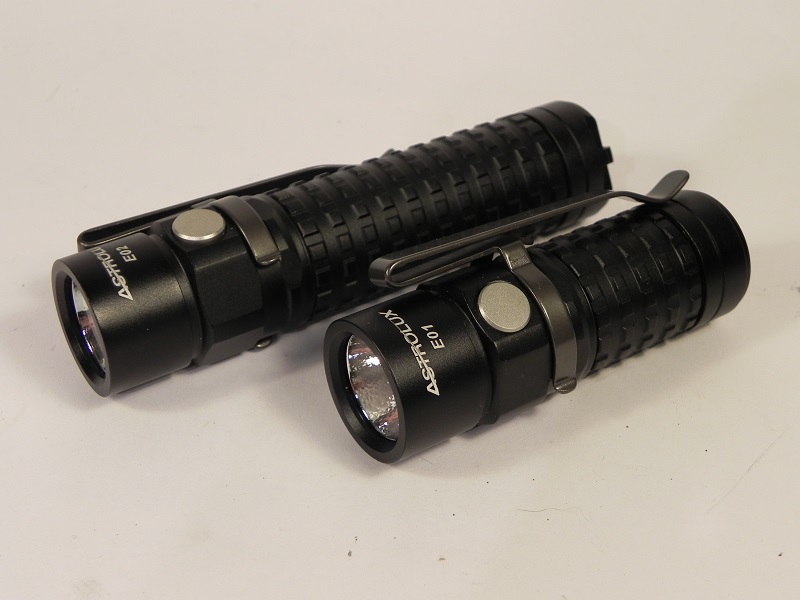

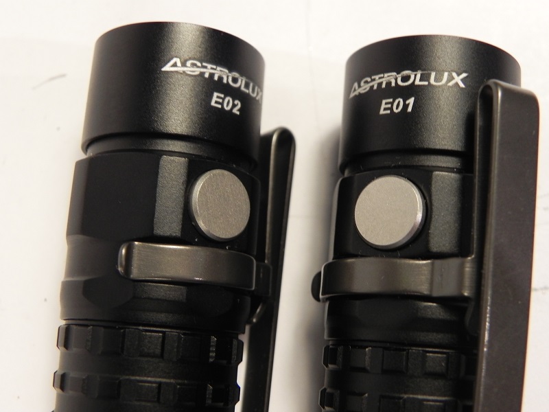

Ok, so it's a true e-switch. Guess they are stumped why the BLF A6 firmware won't work...
The switch looks exactly like an Eagle Eye X5's e-switch.
Hi,

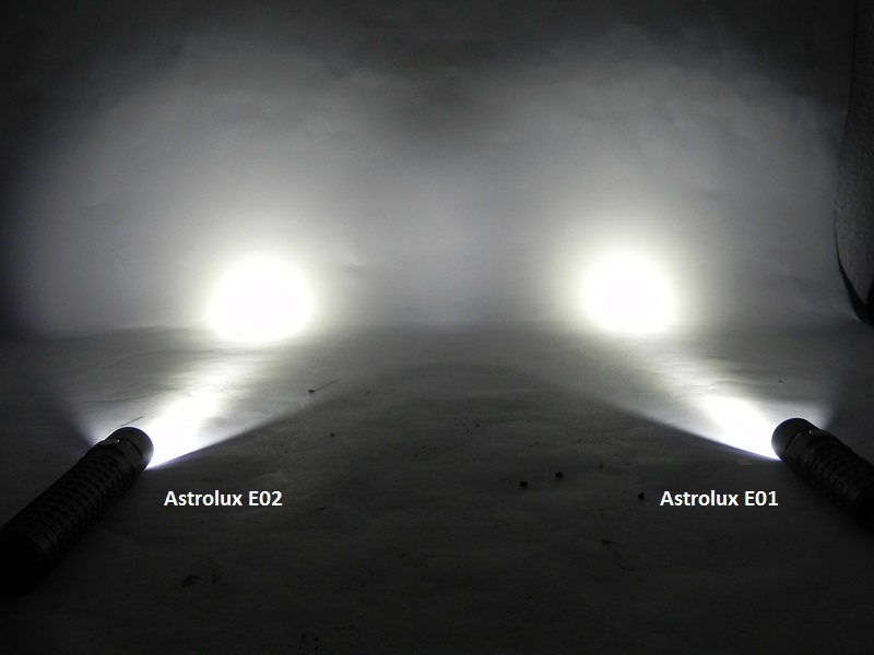

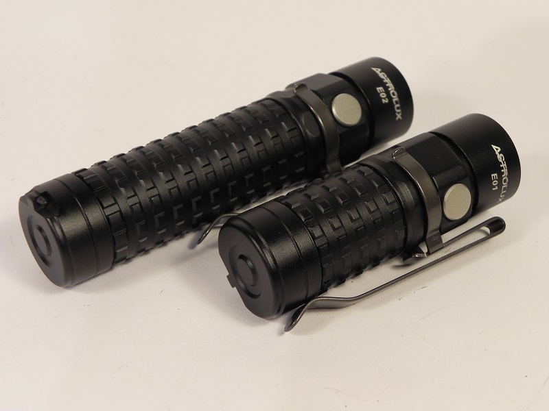

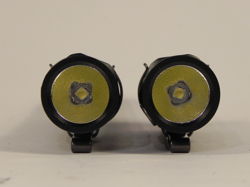

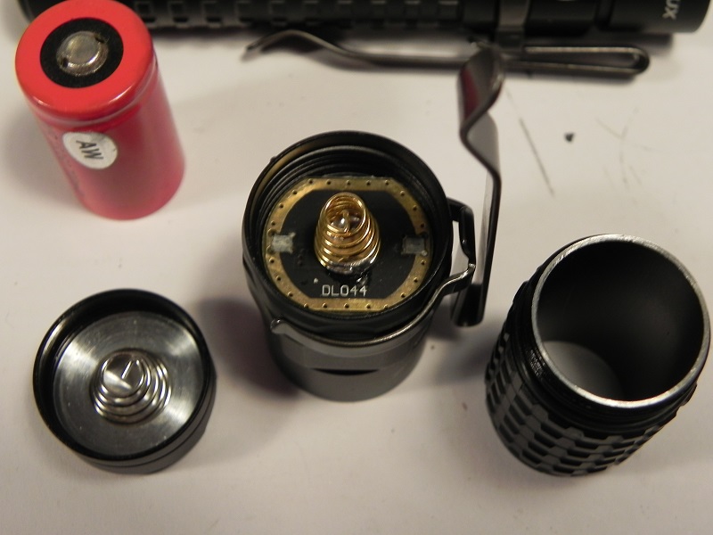

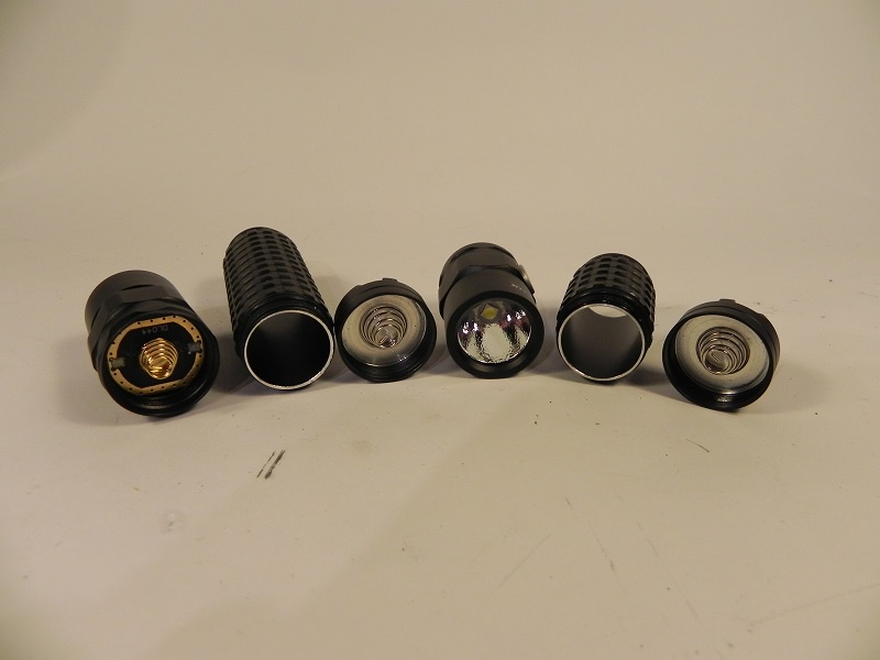

the samples came in this morning. There is definitely not the BLF A6 driver inside. 4 normal Modes with a huge step from Moon to Low, Doubleklick activates Strobe, Bike Strobe (?) and Beacon. Single Click from off switches the light on to Moon and changes mode. Long press from off activates the last used mode (memory), long press from on switches the light off. I did not find a Config Menu or Battery indicator. The light feels good in the hand, pretty comfortable. I measured via ceiling bounce in comparison to a Skyray King (2000 Lumens) 896 Lumens for the E01 and 904 Lumens for the E02.
I contacted Neal for further info on the used driver. I guess it is a 3A driver.

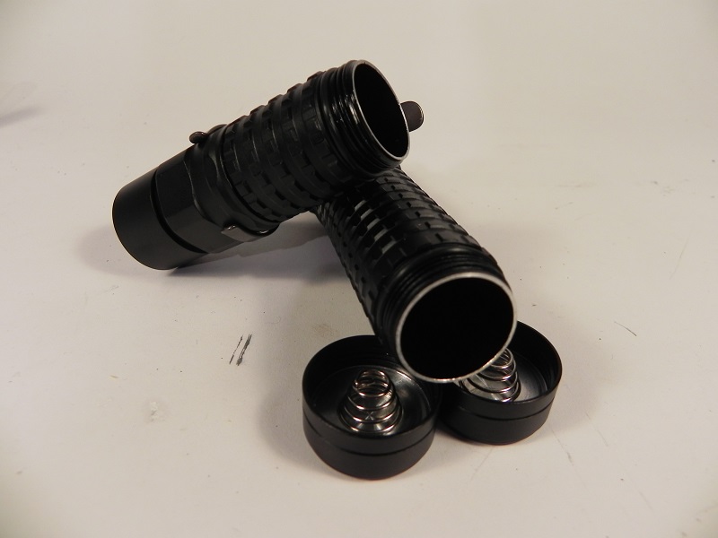

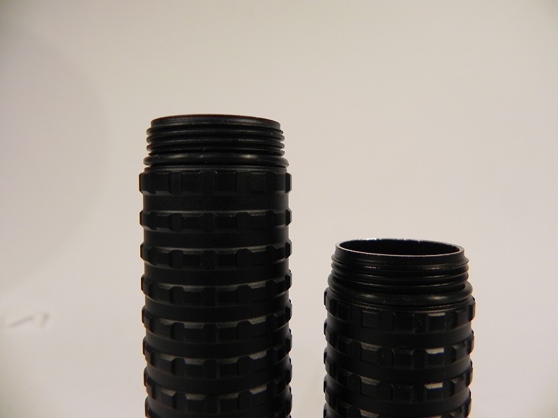

What about battery fit? Do protected batteries fit length and width wise ?
Can you get the driver out? Does the bezel unscrew? Appears to be threaded — really, really hope it’s not glued. I don’t see a retaining ring on the driver, which doesn’t look good to me - might be glued in like an SRK. That DL044 on the driver sounds familiar, hhhmmm…. Can’t recall where I saw it.
Ohh - can you take body length measurements? It’s been a mystery - they never posted dimensions. Based on the size of the clips, it looks fairly short, which is good.
That’s not the advertised driver at all !
