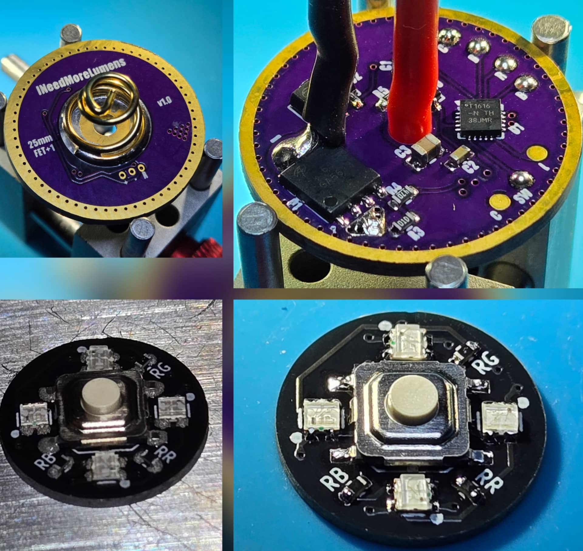

It takes a 25mm driver and uses a 25mm proprietary MCPCB.
They usually come with the mcpcb, but this one did not. Luckily I had an extra on hand.

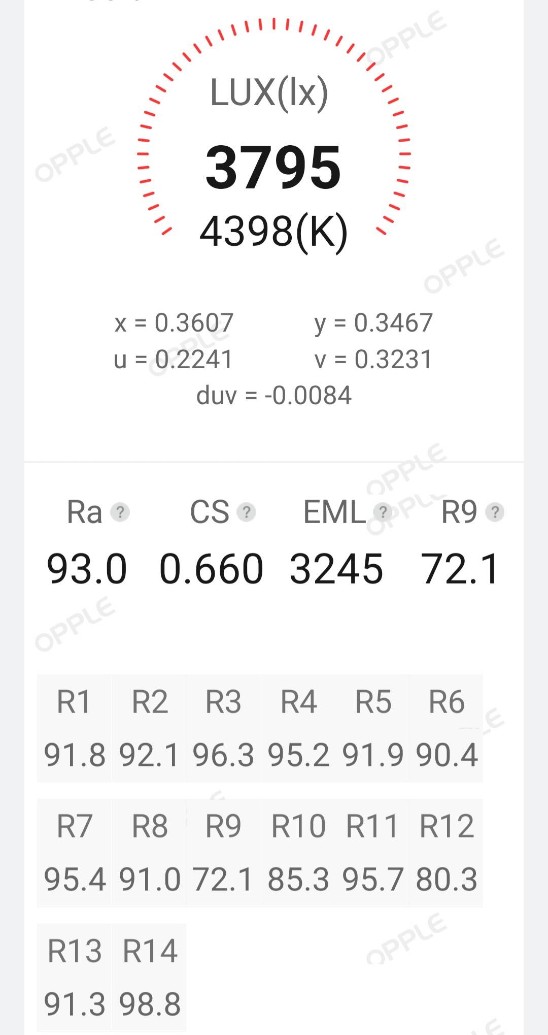

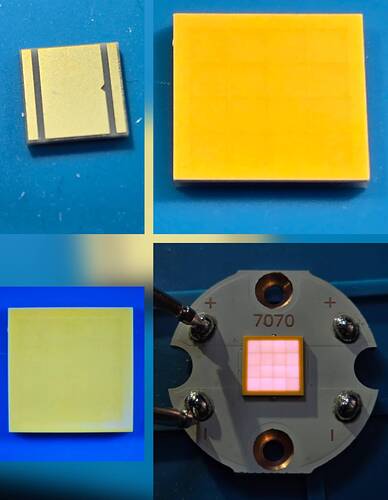

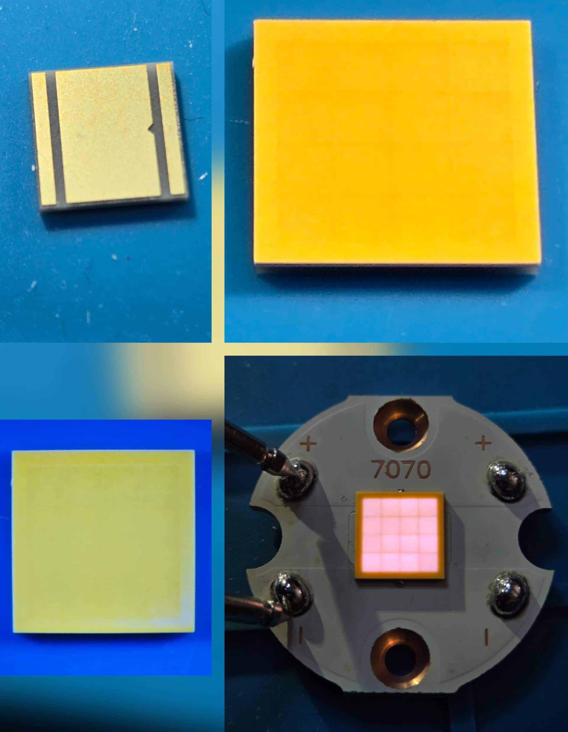

This is the first time I tried the LHD7016 4500k emitter.
It is similar to the 7070 Daydream.
Nice even grid pattern.
The notch delineates the Anode +

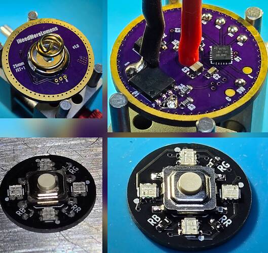

Building the 25mm Fet+1 @INeedMoreLumens driver and eSwitch. I used 16ga wire for the emitter leads. It barely fit :slight_smile:
I didn’t get any pictures of the tail end, but if you plan on pulling high amps, you need to figure out a bypass. I melted the spring on my first X3. These drivers can pull 50+ amps with the right setup.

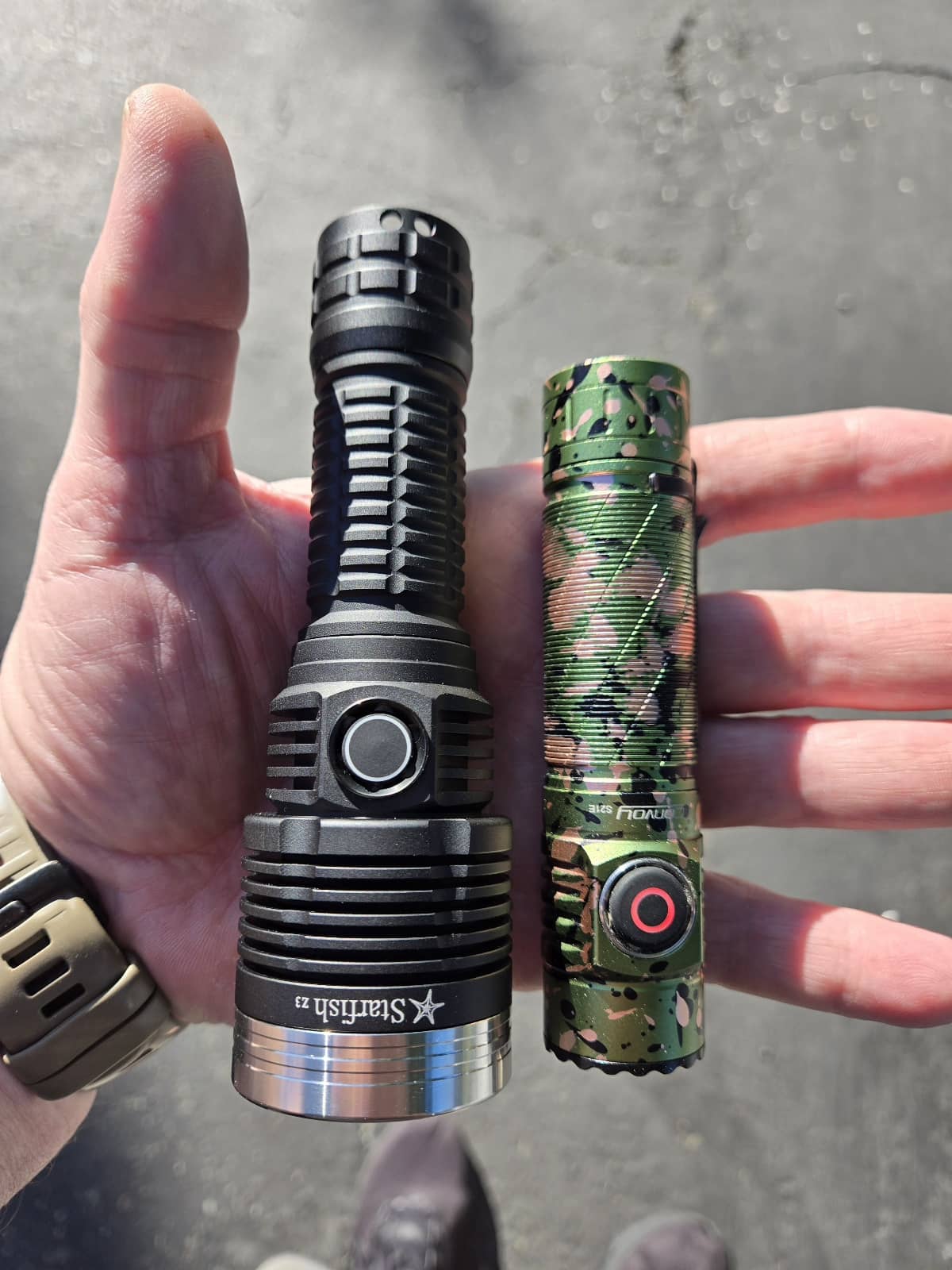

9 Thanks
S21E and Starfish Z3 side by side.

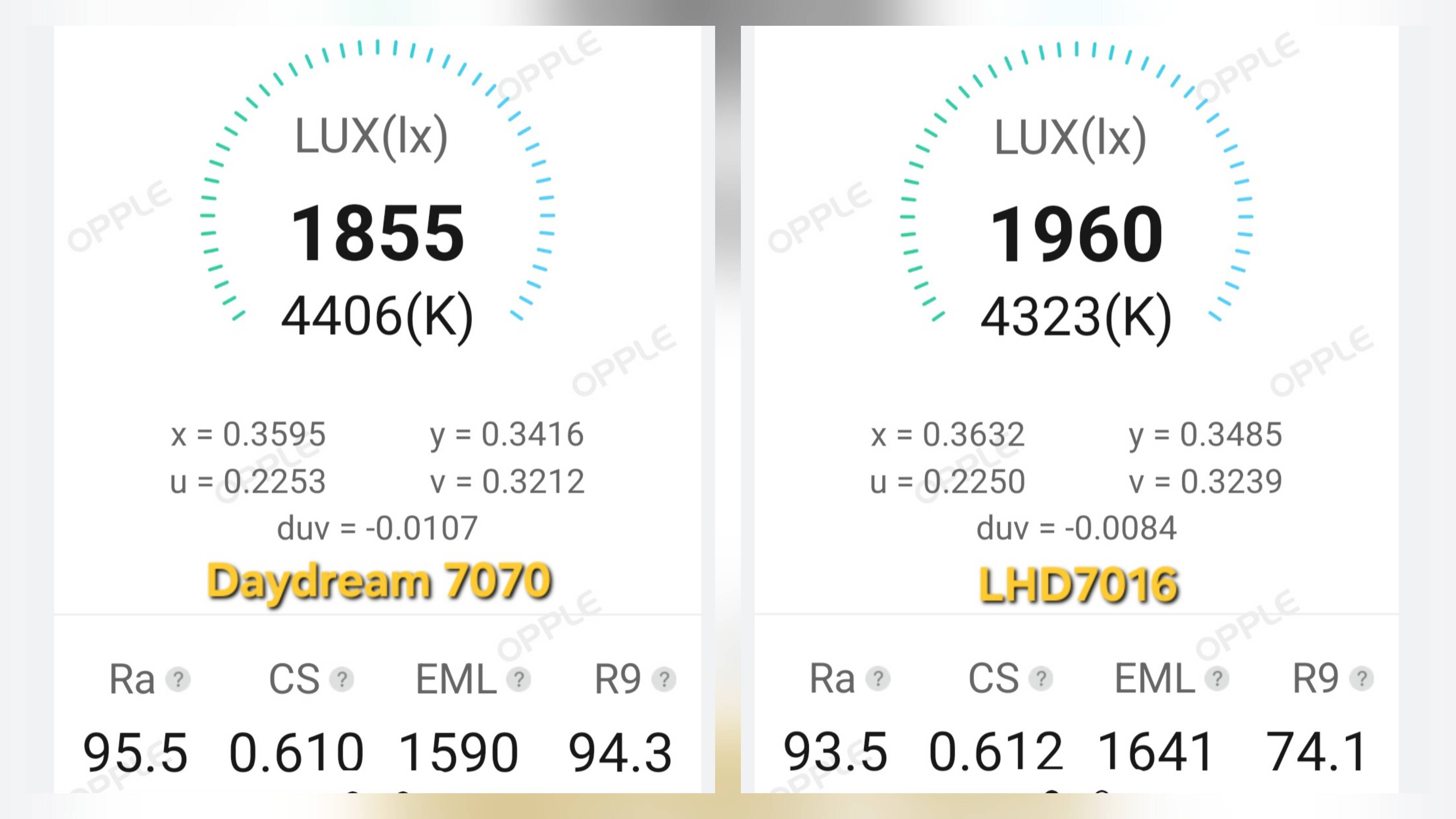

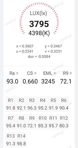

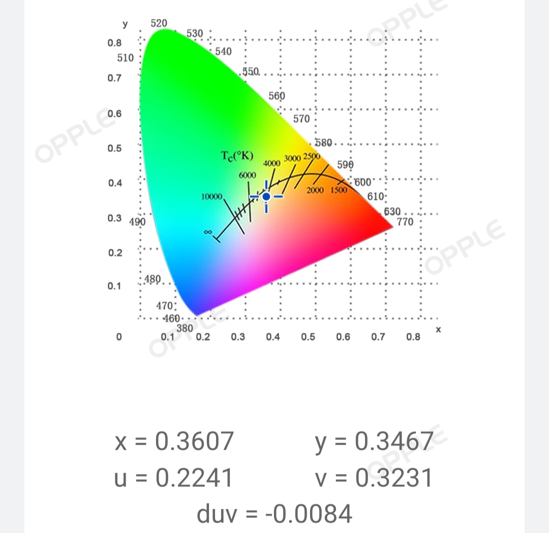

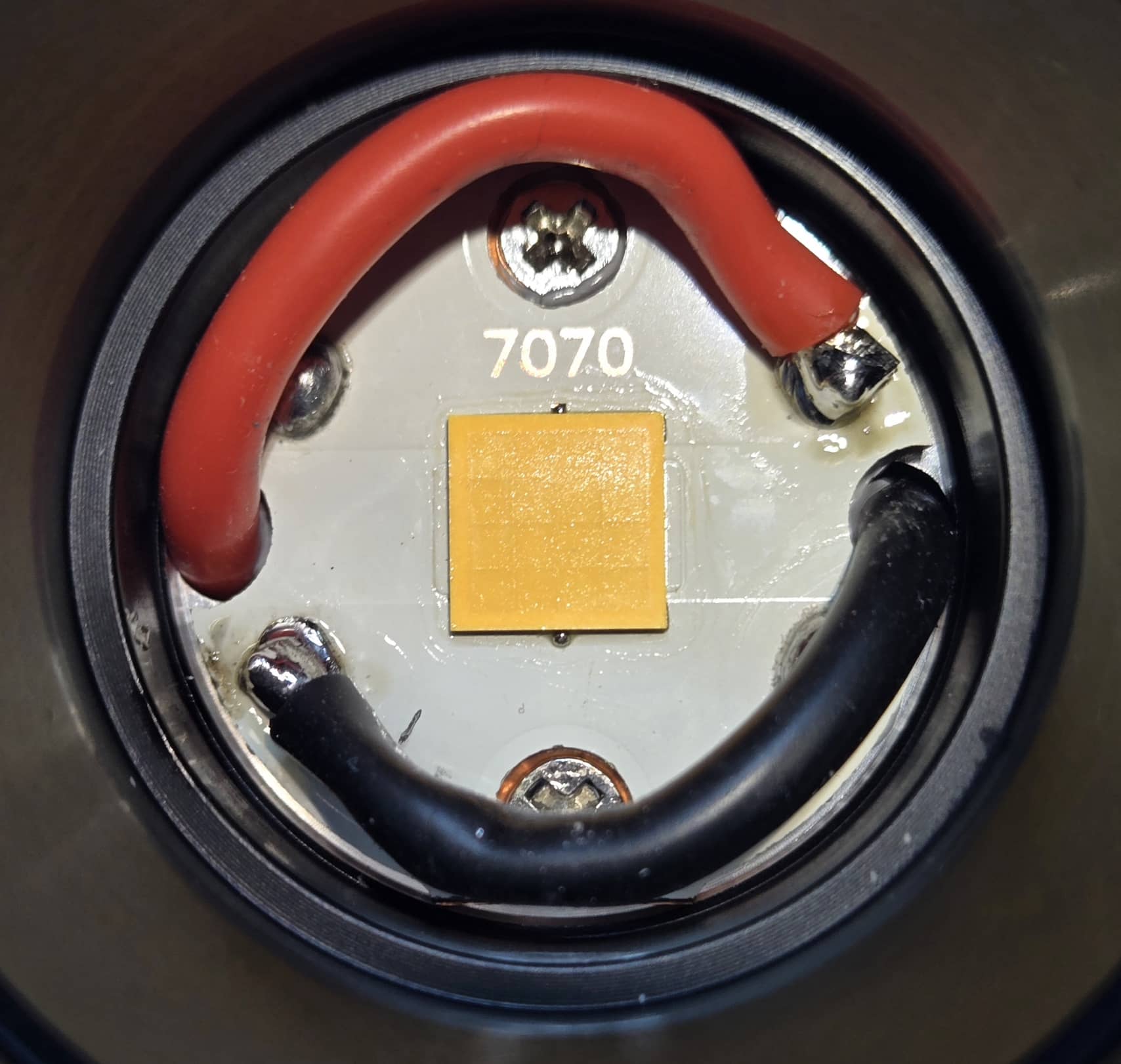

i’ve seen these. they look interesting. have you had time to compare them to the 7070 daydream?
Yeah. They are good, but I think the Daydream wins.
it’s funny, the lhd7016 looks more pink than the daydream in your photo. is billy still the go-to guy for daydream leds?
Yeah, it does.
I need to take updated photos. The photos were taken 4-6 weeks apart. LHD7016 more recent, so things look a little less green here now.
Billy IS still the guy. I believe they are out of stock, but in production.
