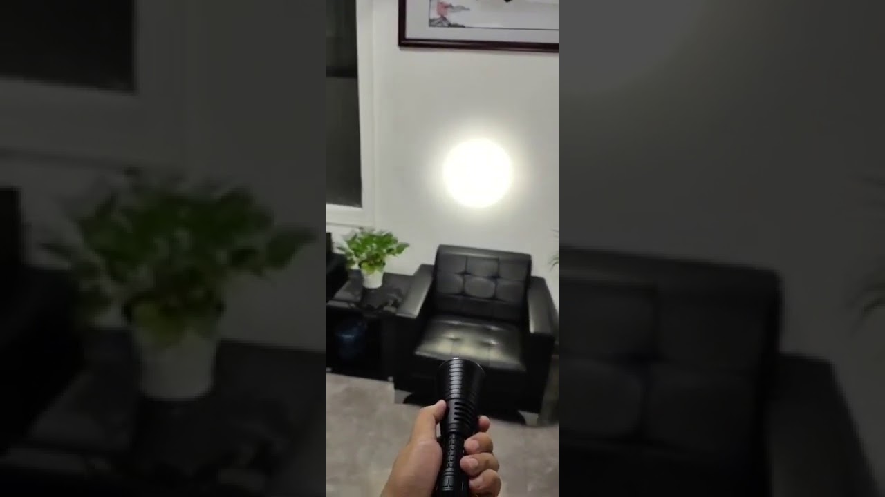

New Fireflylite T9R STB90.2 / Osram 1x21700 Thrower Preview
Specifications:
• 1* Luminous STB90.2 or 1* Osram KW CULNM1
• Max output 4800-lumen or 1500-lumen
• Light Intensity: STB90.2 (400Kcd) ; Osram KW CULNM1 (680Kcd)
• Battery type 1x21700 / 18650 (65mm to 77mm)
• Built-in USB Type-C 2A fast charging
• Most efficiency 6A Constant current regulated Buck driver , Efficiency > 90% ;
• Made of 6063-T6 aluminum, Type III hard coat anodizing
• Ultra Clear AR Coating Glass lens
• Stainless steel side switch with built-in battery charging indication
• Waterproof: IP67
• UI - open-source Anduril firmware
• Size: 6.57’’ x 2.51’’ x 1.04’’ / 167*64*26.5mm
• Netweight: 199 gram / 7.02 oz
