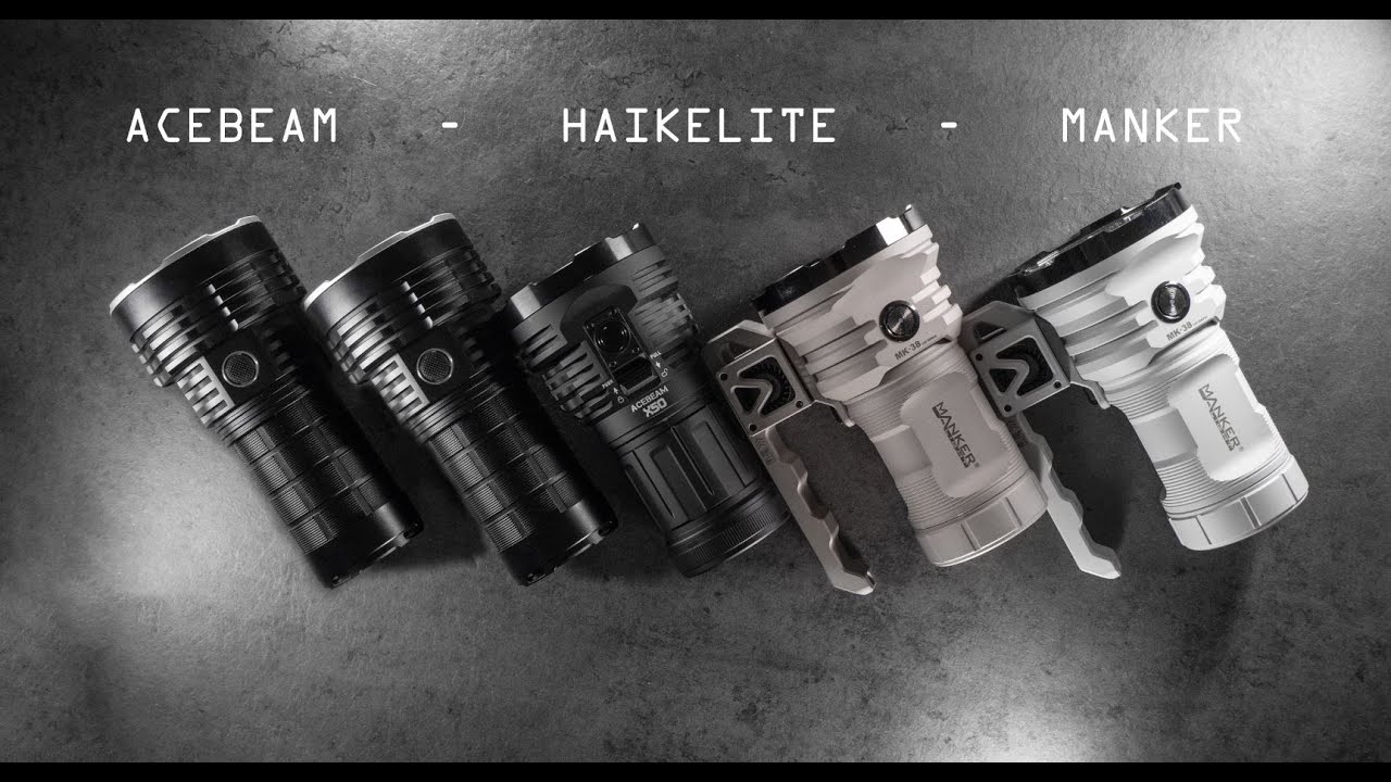

hey guys, I recorded some beamshots of both NW and CW version and compared it to X50 2.0 CRI and MK38 (sft40 and xhp50.3 hi). Here it is:
it seems that NW are lh351d led, but CW are different - I don’t recognize those. CW is visibly stronger and has more throw while having the same flood as NW. NW keeps turbo for 4 minutes before step down, while CW rums on
turbo only 1 minute. Ah, and flashlight is pretty heavy - head has aome
weight in it.
