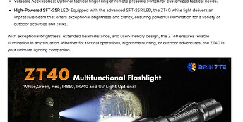

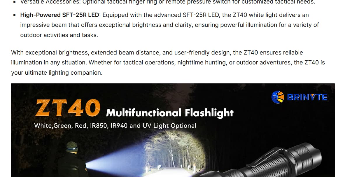

I wonder why Brinyte claims this emitter to be the SFT25R?
Where did they claim this? In the German shop they just call it āCREE white LEDā (no joke) ![]()
(Makes also no sense btw since these round-die Cree ones are designed completely different)
If it really is an SFT-25R, it would just be silly to use a different LED chip that is definitely slightly different since they already have the chip used in the 3535 variant.
I could be wrong of course, but with the method of counting pixels I actually come up with different sized LES. The easiest way would be to play with open cards and publish what exact kind of LED is inside. After all, an SFT-25R with 5050 hasnāt even been officially announced yet, not even through Chinese channels as is sometimes the case, so why would Brinyte happen to have received a batch of these unannounced LEDs which are completely unknown to this date? Surely they are not installing pre-production samples in mass-production lights?
The SFT-40 maxes out at around 14 Amps btw. This is to be expected since they have a much bigger chip with much bigger thermal heat sink.
This is the site I saw, and hereās a screenshot:
Calling it āCree white LEDā is rather irresponsible on their part.

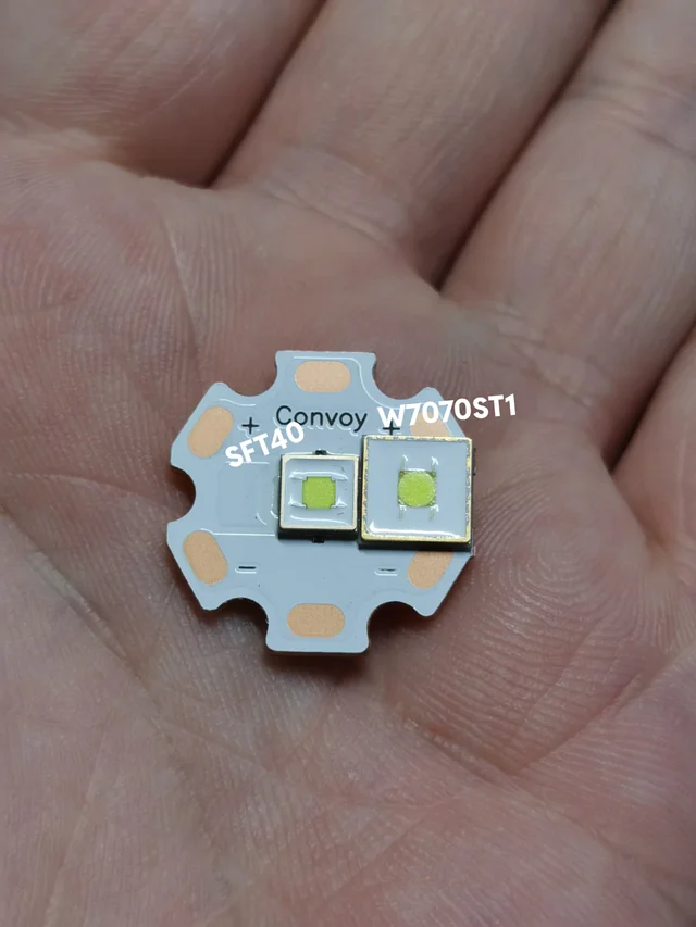

I would not be surprised also if this LED is a joint production between LMP and Luminus. The W7070ST1 has a metal frame in the same style as Luminus emitters, and looks very much like a bigger version of the emitter in question, save for the gold-colored frame and the square corners around the die.
Why Luminus? Luminusās parent company Sanan has been selling various round chips, and Latticepower also has similar products. And many LED packaging manufacturersā products are very similar to Luminusās packaging.
Good point, I forgot that Luminus is owned by this much bigger company that also collaborates with other sub-companies. Itās hard to not think of Luminus, however, when the Brinyte website advertises the LED as āSFT25Rā, though now the mismatching info from the German website suggests that the advertised info is not to be believed.
