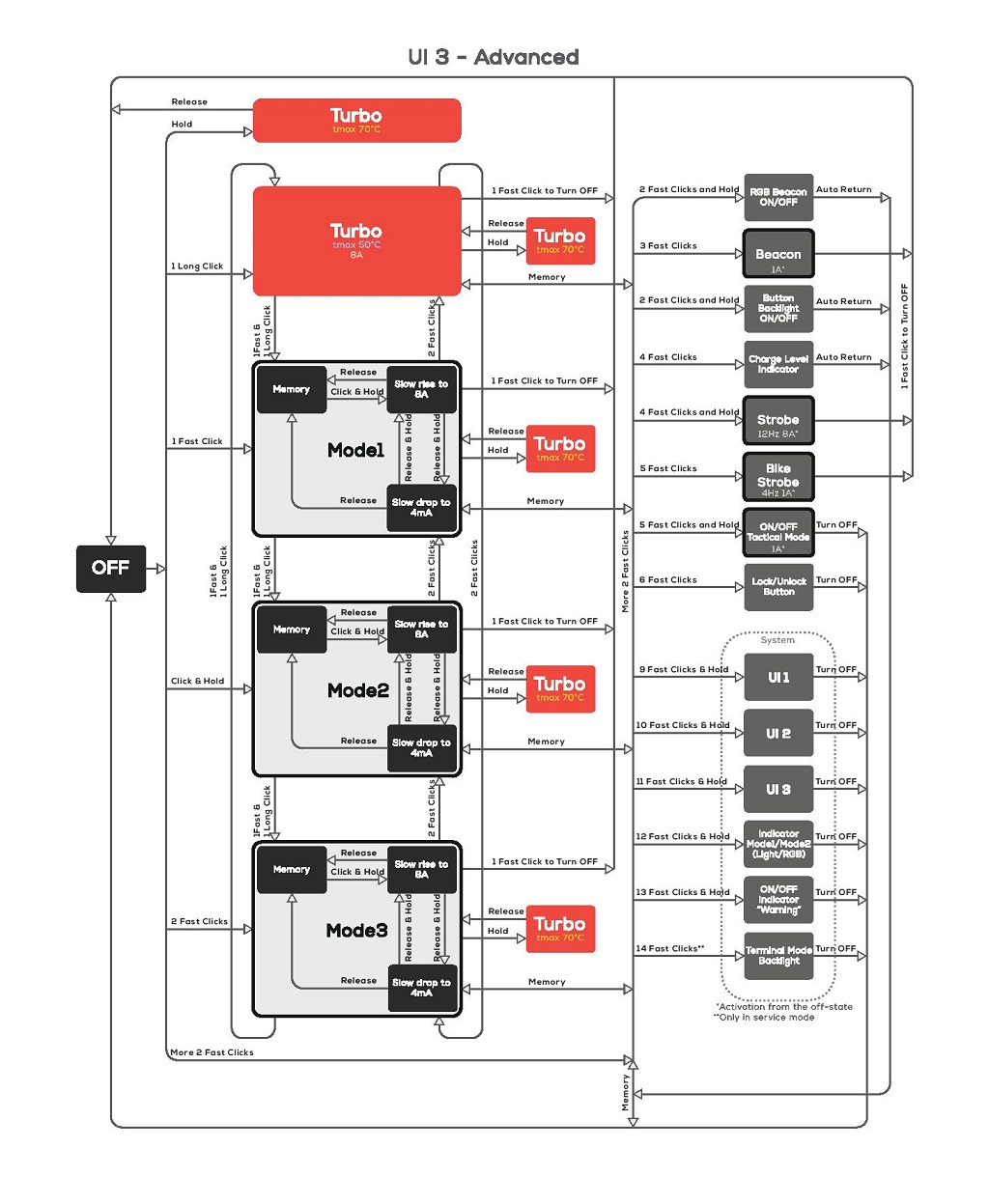

Hy,
Hank told me that the work on the UI is finished and i think it is awesome. So i publish it here, too. I think it may take some time to get it into my brain
Minimalist
Cycle & Fast Access
Advanced

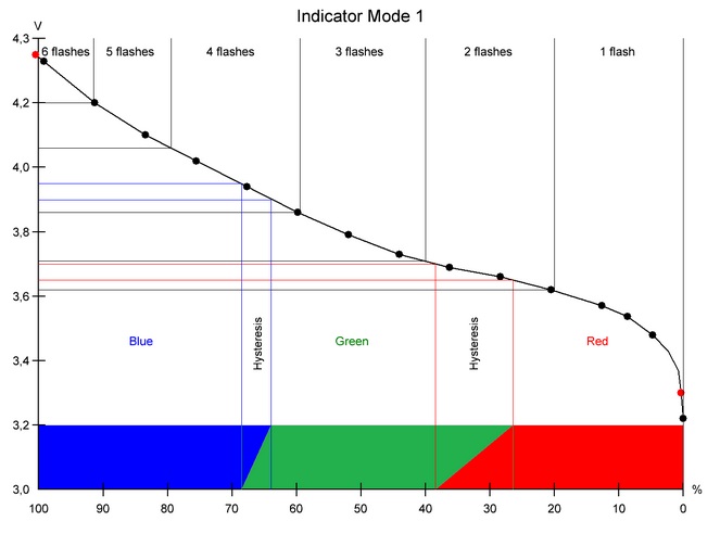

And some info on the Low-Voltage indicator/RGB indicator
Lumens were not measured until now.

Pretty dang intense! I might not be able to buy this one as my memory may not have enough storage space for that UI.
Turbo at 8A. Hmmmmm……

From off to turbo at least 6 seconds !
No, it’s not. Turbo starts after UI recognizes what it was not “Fast click”, so far as i know ~ 0.5…1 sec.
It is a boost driver, where output values are not identical to input values, a power conversion it is made. There are 4 sets of 3 LEDs in series.
To imagine current that would pass through each LED you can divide a displayed value in the graph by 4:
Example “Turbo 8A / 4 = 2A (per LED)”
We can make a simple UI like “firefly-medium-high-Turbo”, just as any other flashlights in the market, but
our team decided to bring something new to the market.
It looks a bit complicated though, all you need is to take some time and patience to practice it,
then you will enjoy it, quite simple when you get used to it, then to choose your favorite UI
(there are 3 different UI in the program which can be chosen by multiple clicking.)
I would suggest people to look into the UI graph, and give more serious comment.
Thanks!
Hank
Thanks, Hank!
I see now only one typo: “2 Fast Clicks and Hold” used twice for RGB Beacon and Button Backlight. Surelly it should be 3 Fast Clicks + Hold for Backlight.
It is not really clear, what is “service mode” and how to activate it?
Strobes and Beacons can be activated only from OFF State? Why?
Something like “From off to turbo at least 6 seconds” surely means he does not understand the UI,
No, I understand it ok but you should really use larger font, I had to magnify that 500% to actually see it is “greater than 1 and less than 6”…
BTW, you should change the date in the thread title, we are 1/3 into April but I admit I am not sure what month is in China,
after all not a nuclear scientist here

I have attached the User Interface as PDF file so it can be seen at various sizes and even to be downloaded.
Thanks for showing the typo it has been fixed now.
