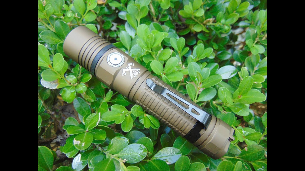

I like the styling on this one with the “ribbing” , instead of the traditional knurling on the tube. Along with the more “flat” type finish on this light , the grip is exceptional with the rib and finish combination. I also like the (Bronzy) color on this new Custom Edition , I know opinions will vary however.
