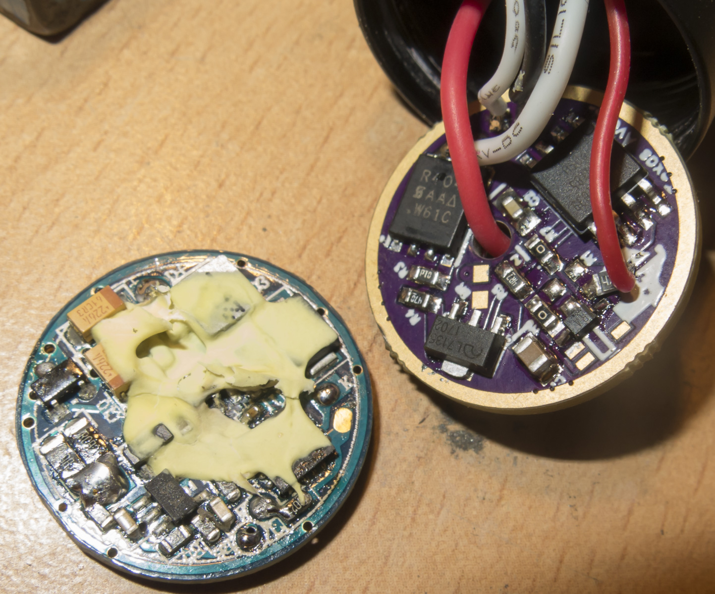

I feel the same way. I modded mine with a FET driver with ramping. I think I used a 20mm driver and it was a bit too small; I got it to work by putting some solder at the edge to sort of increase the diameter.

For the driver, a FET+1 from mtnelectronics with the D4 firmware is what you want. They don’t have 21mm drivers, so I would get a 22mm and sand the edges until it fits.
Like this one: FET + 7135 Driver - 22mm - MTN-22DDm

I want to engourage you to build your own driver. But buying the parts by the piece will cost more than a complete built driver. You will also have to learn to Flash the Firmware to the MCU. The flashing parts can be had for under $20 or even under $10 if you go with a made in china clip.

I have recently started building my own drivers but I am fortunate enough to be in USA and MtnE is only a couple days for shipping. His parts are reasonable and I can build 2 for the cost of one assembled driver. He also sells the MCU only with some UI options already flashed.
I believe you will still need to order the boards from USA. OshPark is where the files are shared and orders made. I forgot that part… On OshPark TA lists the parts needed and some have a shopping cart build link to an electronics supplier.

I am selling those H03 drivers with TA Narsil Layout
with button AMC7135 TA Layout you need a 0.8mm thick board as the 2 Oz Oshpark
latest design 1S or 2S also XHP50 possible
