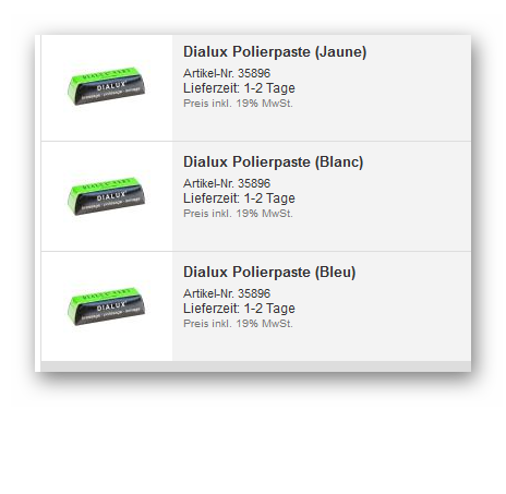

I orderd new polishing paste yesterday. The one i used in the past was ordered from china but i could not get further information about it. (is it really good for Aluminium or better for SS. . . . )
And because you wil most likely get fake Dialux paste from Ebay/AE i orderd it from a German shop for jewelers. This should help with getting it nice and shiny.
