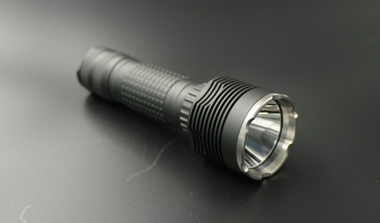

Final LED information:
SST-40-WDS-F50 N4 flux Bin DD tint ~4800K (running on a bit more than 7A on a fully charged 30Q battery)
XPL-HI V2 flux Bin 3B tint ~5000K (running on arround 5,5A on a 30Q)
And a few pics from the now complete light

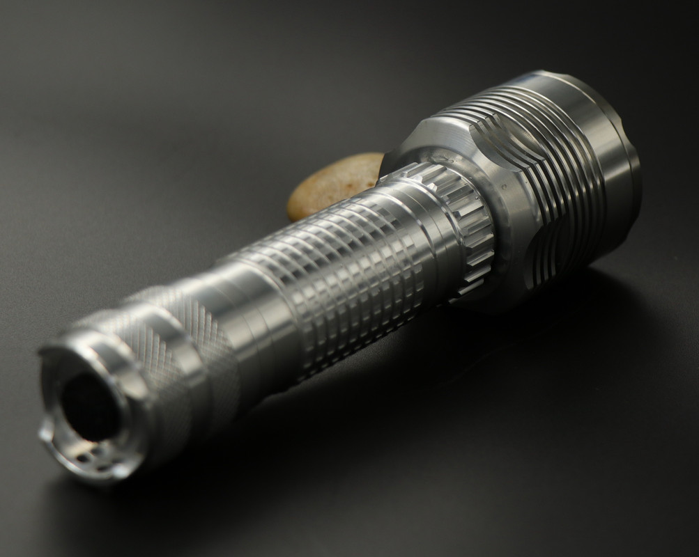

And here the no ano version

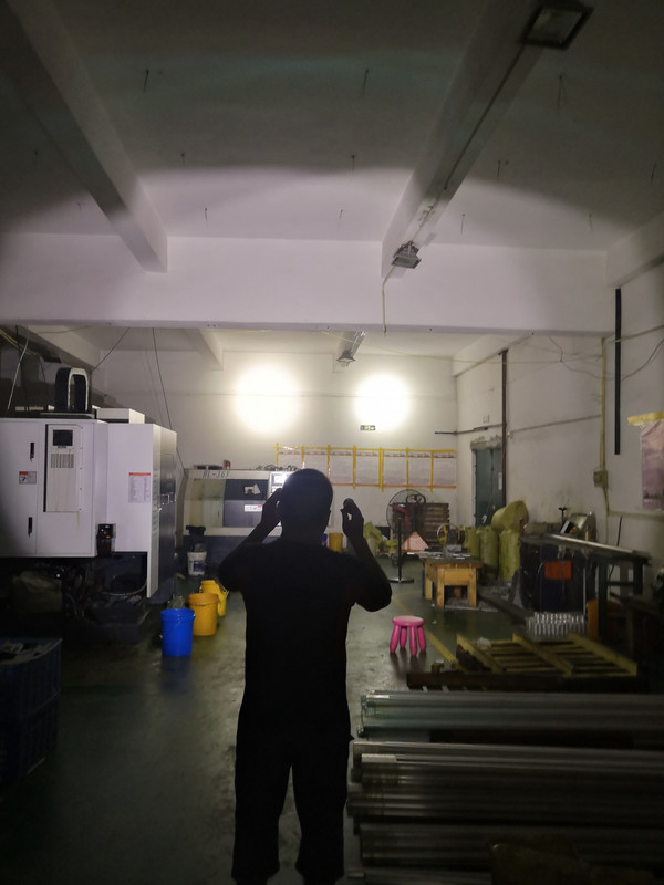

And here a few beamshots:
SST40 on the left XPL-HI on the right (~5m from the Wall)
SST40 on the left XPL-HI on the right (~15m from the Wall)
