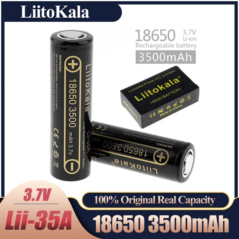

I’m looking in Aliexpress (Liitokala) or Gearbest, but still don’t know what’s best for this light. Don’t even know how much (hours) they will last. Probably the best should be something with high capacity (>3200), as the prices are not really that different.

No. Liitokala is OK, but they’re rewraps, so who knows what they’re currently wrapping in there.
I was suggesting sticking with name brands like Sanyo/Panasonic, Samsung, LG, or Sony.
