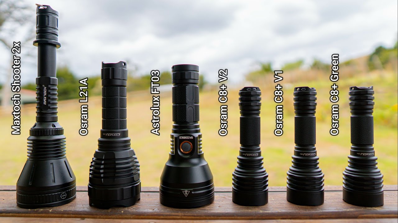

This is my comparison which includes the shooter 2X and C8+ with CSLNM1 and CULPM1. The CSLNM1 is narrower. The CSLNM1 is labeled Osram V1 since I was selling these custom made long before I got Simon (Convoy) to stock the Osram chips.
Edit: I guess that would depend on which version of the 2x you have. The first and best version for hunting was the XML2 dedomed, then Maxtoch released it with the CSLNM1

Yeap very first version, 2nd batch, with better QC’d head-screws.
Yeah, so the one in the video is the dedomed XML2 which is wider. This is at 150m, this shows quite a lot more spill with the 2x for walking around. Back then Convoy’s 5A driver was running at 4.8A, now it’s pushing 5.7A which is damaging the CLSNM1, so if Poohduck was to use the 3A driver he’d be getting less spill making it less useful walking in the bush.
Maxtoch’s build quality has gone downhill a bit since though. I reviewed the L3K LEP and 1Lumen has also touched on it being subpar for the price. I’ve spoken with far too many customers with their Maxtoch models failing. Excellent performance though, can’t fault them there.
To clarify, it’s the dedomed XM-L2 U4 I have.
