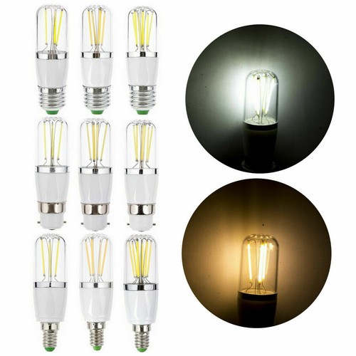

You might try one of these available for under $5 shipped to where I live. The filaments are LED chip-on-board and you can get it in dimmable 220V for either white or warm white.
