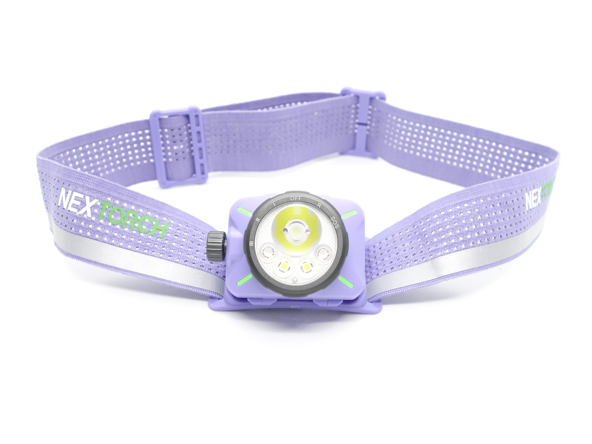

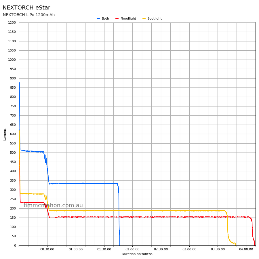

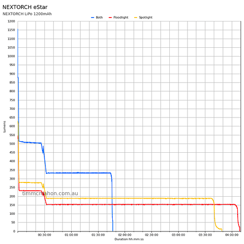

The NEXTORCH eStar is a knob controlled headlamp with a spotlight, a floodlight and a red light. It takes three AAA batteries or a rechargeable LiPo battery with USB-C charging.
The runtimes are better than expected and the output is well regulated.
Spotlight
Floodlight
Both (Spot + Flood)

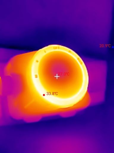

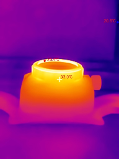

The thermals are pretty good.
