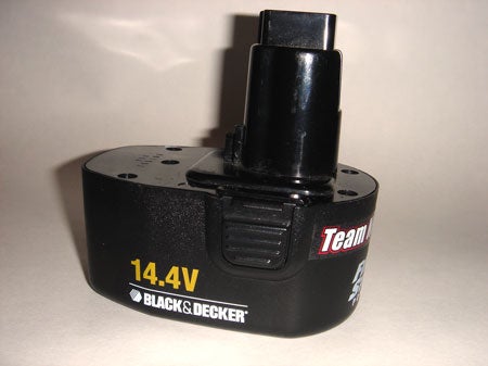

Not the same voltage….but you will see a familiarity in rebuilding these battery packs
Would this be your Ni-Cad pack?
In the bins, I see more of these than any other. Most are brand new chucked by HD. Never have I seen a well used one.

Mine is the same brand and voltage as this one, but the case looks different, it could be an updated outer case of mine
