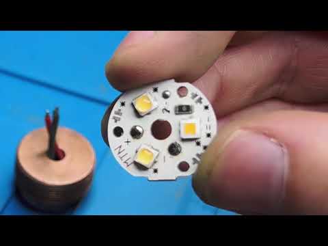

I saw this 519A dedoming video shared on Reddit yesterday:
Cheule says the method recommended to him by Clemence is to first vertically section the dome into quarters with a knife (the glass protects the phosphor), then pry it off laterally.
He tries a couple variations on the technique in the video, and still had a little cleanup to do on some of them, but it seems like something that a person might be able to do very consistently with a little practice.
My impression is the goal is a mix of minimizing setup (no washer/shim), reducing cleanup of residual dome material, and avoiding risk of pulling up the glass cover and any phosphor.

That is a very informative video. I watched it last week and cringed when he sliced down on the dome with an x-acto knife.
I was able to pull off the dome with my fingernail at room temperature. I was surprised as to how easy it was to do! The glass over the phosphor was nice and clean (no clean-up necessary). I just removed one of the triple domes to give it some rosiness, but not too much. It brought the overall CCT down to around 4000K.
