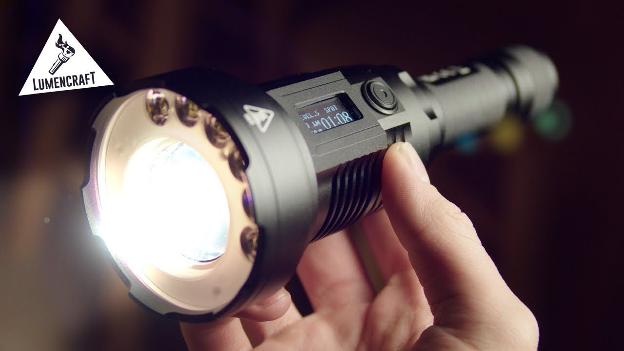

6x LEDs and a laser in the center. Ethan did this review, he works for me at the Lumencraft YT channel now. Most of you already know him as Luxwad.

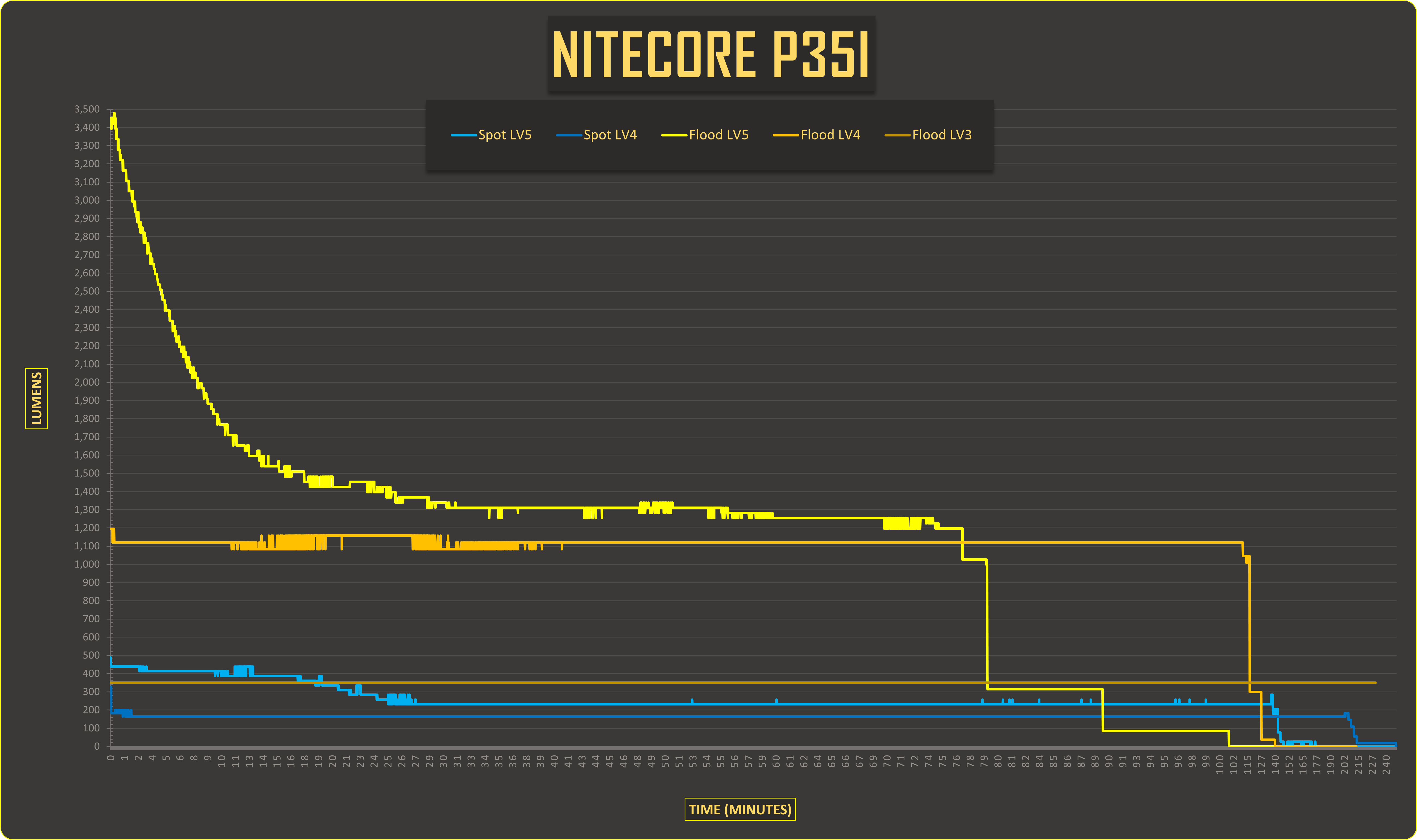

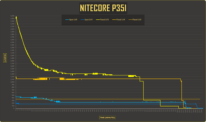

Thanks for posting this! Here is the runtime graph as well for anyone who wants to take a look at it again:
