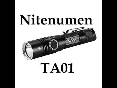

Gearbest was kind enough to send me the Nitenumen TA01 for review. I picked this light due to the popularity of the NE01 and that no one has done a thorough review and test of the TA01 so far.

The tailcap has a forward clicky that does operate with momentary feature. Inside there is a nice stout coated spring and a brass retaining ring to hold the switch in place. The light will tailstand if you coax it, but it’s not going to happen in anything but perfect flat conditions where you have time to balance the light.
The Ta01 follows in the footsteps of the NE01 in that it has a really thick aluminum tube, annodized threads, and a pretty impressive pocket clip. The clip is equally thick and beefy. The threads are nothing spectacular, but are smooth after a little cleaning and lube. The ability to physically lockout the light is very important to me.
The head has a stainless steel bezel, glass lens (not AR), a smooth reflector, USB port, and the driver is held in place with a retaining ring. I did not remove out of fear of damaging it prior to completing my review. The battery contact should be noted. There is a spring loaded brass button surrounded by a plastic insulator. The brass button is recessed so you are going to need to use button top batteries. I did test numerous batteries and the ncr18650b was a great fit. I attempted several unprotected batteries with magnets attached and they were too short. So battery length will rule out the use of shorter batteries even if you have modified them. This setup provides a physical reverse polarity protection as well as the flat bottoms can’t make contact with the brass button. I would really like to see electronic polarity protection in a light, but I guess something is better than nothing. The USB port is covered with a rubber boot. As usual it will only accept USB cables with a thinner profile to them. The ones with the big square rubber boot wont fit in.
The quality of construction is very similar to the NE01. Thick tube, and most of the features we need.

How am I the first to review this? The TA01 is a great flashlight for the price. It’s only problem is the new budget competition on the 18650 tube light market. The Atactical A1S is the same price and you have the ability to order it from Amazon and get it in a few days. I do prefer the TA01 to the A1S just because of the extra mass in the head. The flashlight is much more manageable to handle during longer runs with that extra material to transfer heat away. The light has alot of great features crammed in for $30, it’s super easy to use, and has some good safety features. The USB charging worked flawlessly, it has some respectable throw, a nice clean beam with a decent tint, on top of having mode memory, and thermal protection.
My major complaints are the physical reverse polarity protection, and the inability to use short batteries with the flashlight. It limits your ability to easily mod this flashlight and use your high drain unprotected cells with it. Nitenumen does great work with the pocket clips, and they are about as comfortable to carry as an 18650 tube light can be. The lack of PWM (at least that I can see) is also nice. The NE01 had PWM that I could see readily even when the flashlight was still. Lots of positives about this flashlight, and you’re not giving up much by buying this budget light.
So would I buy this light? Absolutely. It performs as good as the TC12 at half the price. Thats enough for me.
