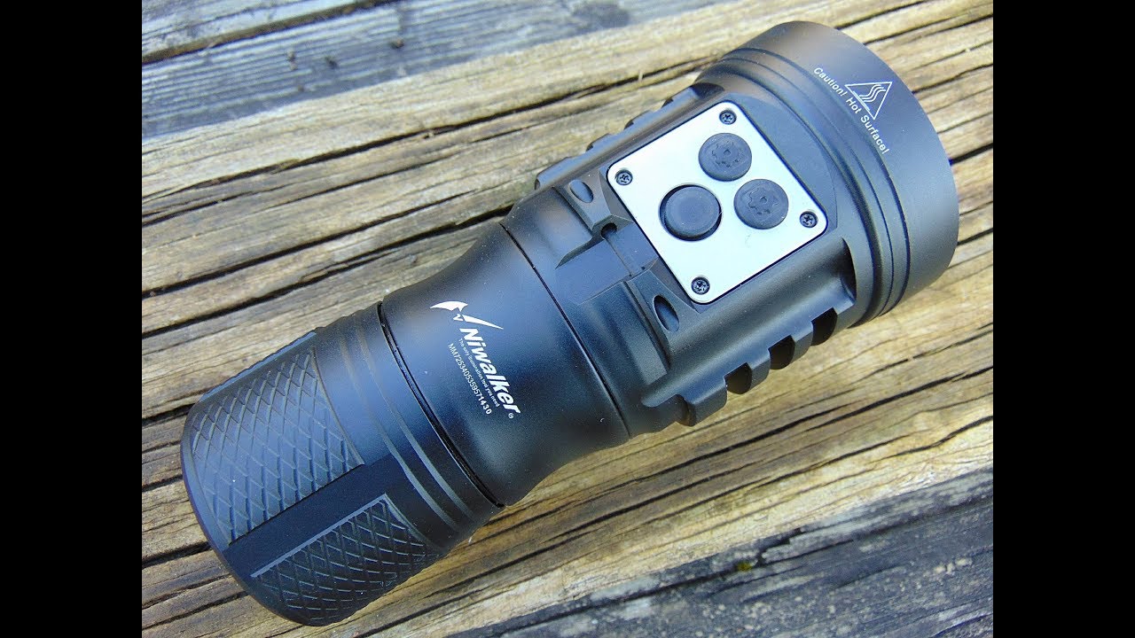

Upon unpacking the light and looking it over , I found no bare or thin spots in the anodizing , the knurling is well done and the overall fit and finish are very nice on this light. There is even a tripod mount on this one.
The lens was very clear and the sliver colored bezel sits nicely inside the outer black anodized part of the head , giving a very nice finished look there. There is only knurling on the tail end of the light (tailcap) but the tapered build of the tube makes for a nice feel and grip.
The MM18JR runs on 4 x 18650 cells and comes with a well made battery carrier with ceramic rods and it can be inserted either direction in the tube. Just be sure you get the cells oriented right in the carrier itself.
The light has 3 emitters , 1 x XHP 35 HI and 2 x XHP 70.2. You can use only the XHP 70.2 emitters with 6 levels of brightness for flood , or use only the XHP 35 HI with 6 levels of brightness for all throw. There is also the choice to use all 3 emitters. The main switch gives you 7 levels of brightness and you can get the full 10,000 plus lumens from there , or go all the way down to 5 lumens using all 3 of the emitters at once and / or set one of the auxiliary switches for the 100% mode if you so choose.
There is a switch panel on the side of the head with 3 switches that control all the modes and functions of the light and the panel is also well done. There is the main switch and 2 auxiliary switches on the panel itself. The 2 auxiliary switches let you program the mode you want into the memory and each one can be set to memorize different modes of your choosing.

The main switch turns the light on with a single click with the 2 XHP 70.2’s in the lowest setting. From there it is a semi long press to the next level (maybe 1/2 second) , or you can press and hold the button to cycle the modes until the desrired mode is reached , then release the button. To cycle to the single XHP 35 only you click to turn the light on , click again for the single emitter and one more click gets all 3 emitters. Once you have the emitter (or emitters) that you want turned on then to cycle the modes is as described before hand. As mentioned above , each of the auxiliary switches can be set to any mode or emitter combination you choose and once they are set a simple click on or click off on those. To get the momentary on 100% , from off you press and hold the switch. To get the full 100% constant on you press , release and then click and the light stays on at 100%.
To lock the light out , it is a triple click of the main switch from off. The strobe is a double click of main switch from off. The hidden SOS / Beacon / warning flash , are accessed from the main switch also. When the light is on you press and hold the main switch for changing hidden modes and the light will flash to let you know you are in the next mode.
