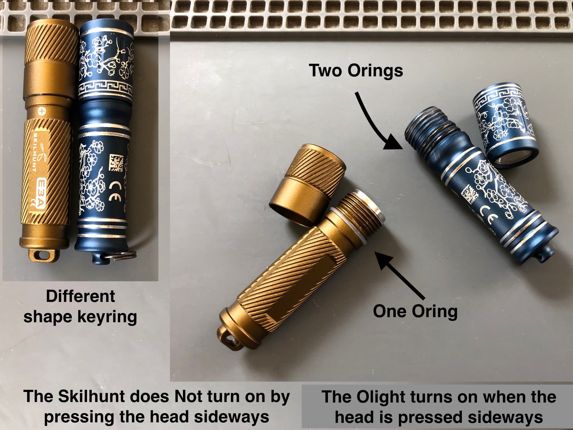

a few more e3a to i3e comparisons:
Major advantage to the Skilhunt, is that it does not turn on when pressing the head sideways…

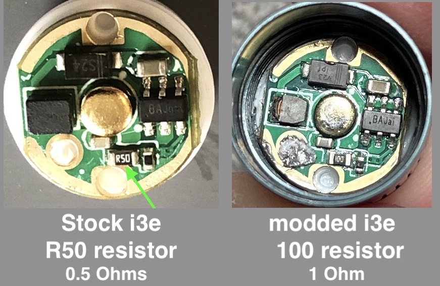

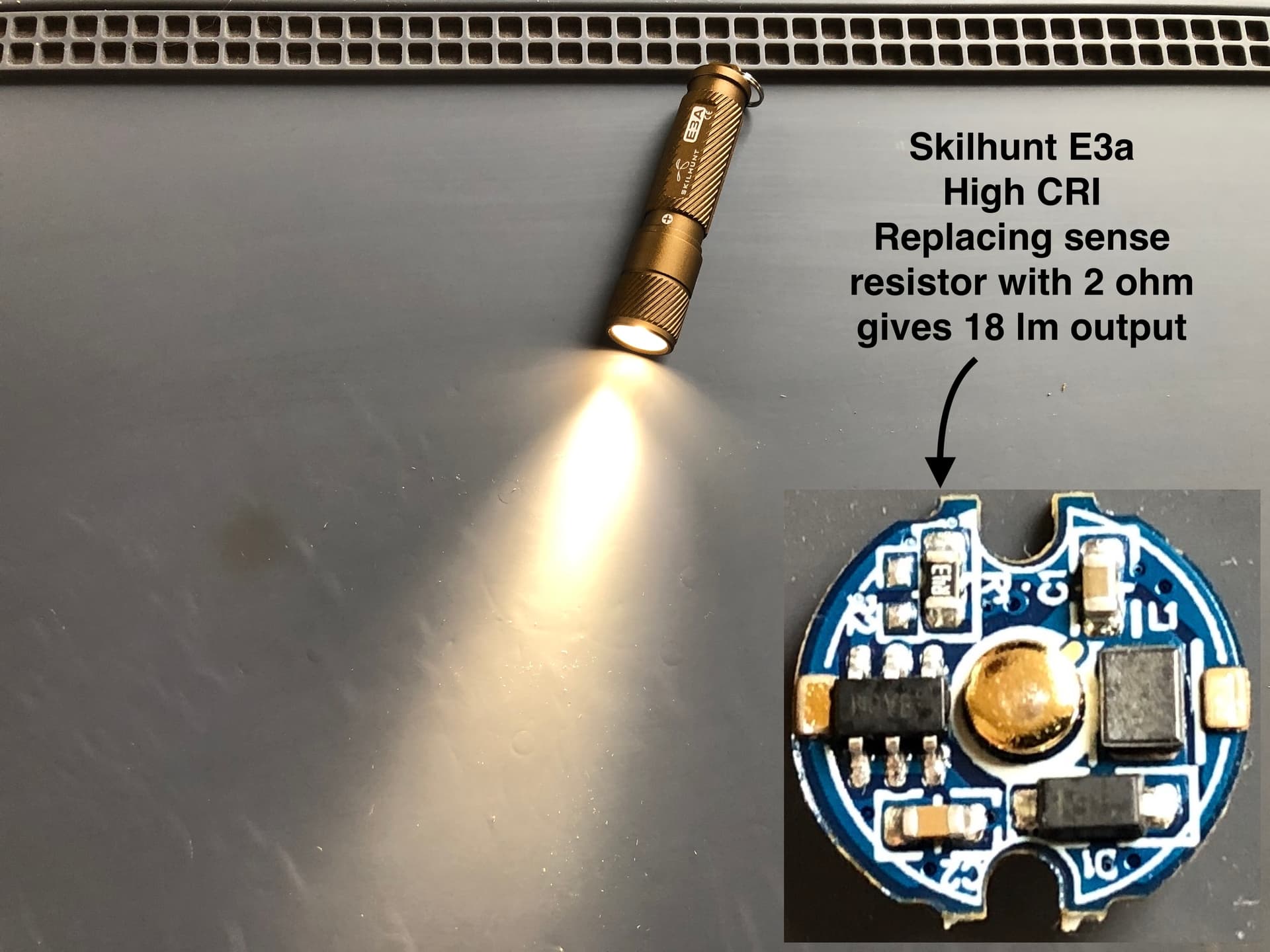

I think it was you who posted a link to changing the sense resistor to lower the output? I’m tempted to pick one of these up and give it a go, perhaps if I see them on aliX with a good deal.
You’re right about the lack of thread slop, in my opinion Skilhunt did a fantastic job on the threads.
I did collect info on sense resistor change for the Olight, thanks to info shared by another member who had Skylumen do a modded Olight for him with High CRI LED and lower output.
that mod reportedly gives 15 lumens for 7 hours
both those expenses could be skipped by just buying the High CRI Skilhunt and powering it with an old high resistance Eneloop
I have not bothered to try doing a sense resistor swap myself… I hope you share your results :wink:

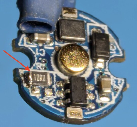

Here is a pic of a modded Skilhunt with resistor swap output info:
Skilhunt E3A modded w 10 ohm resistor to produce 5 lumens for 34 hours…

Resistor mod:

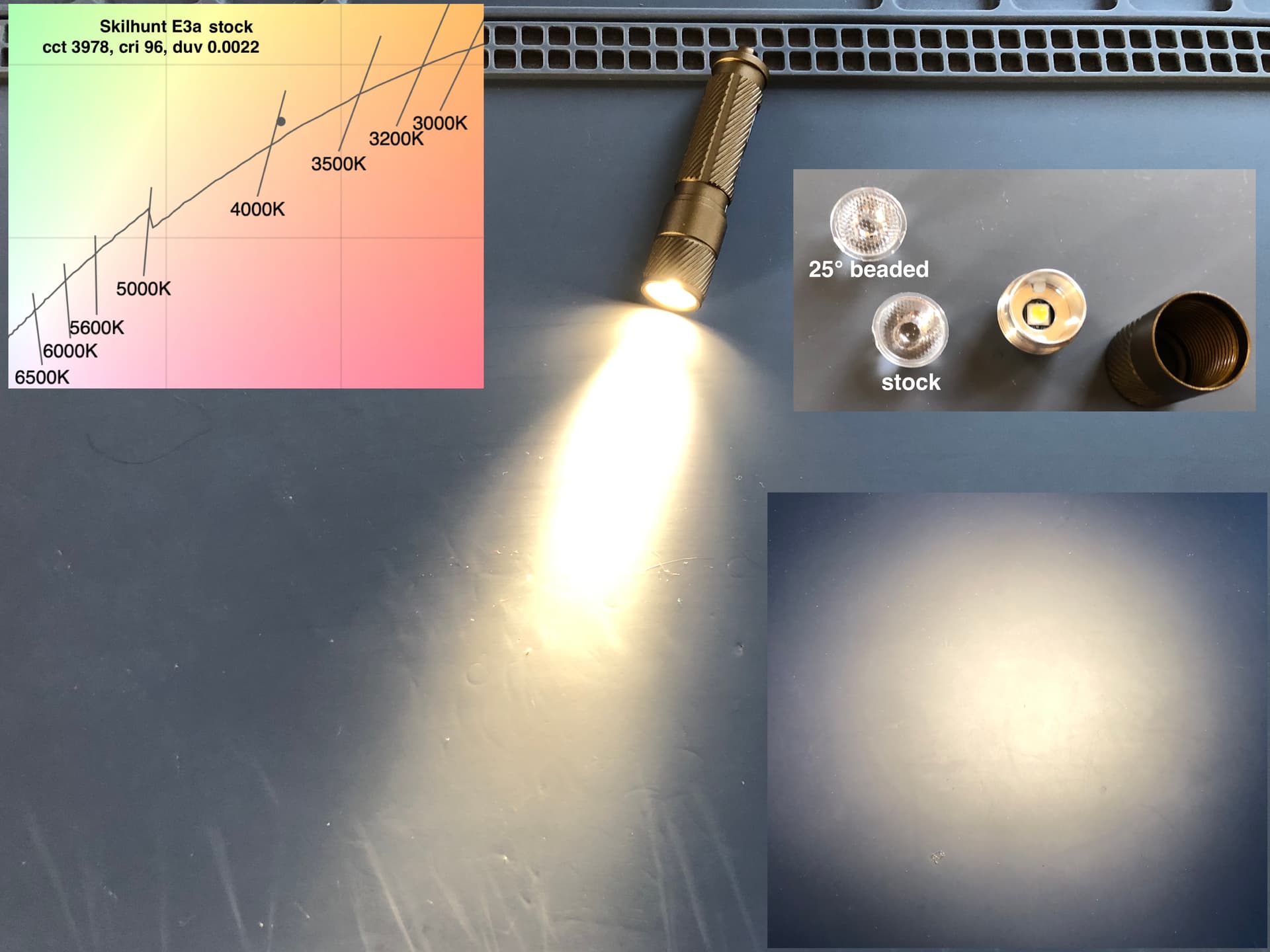

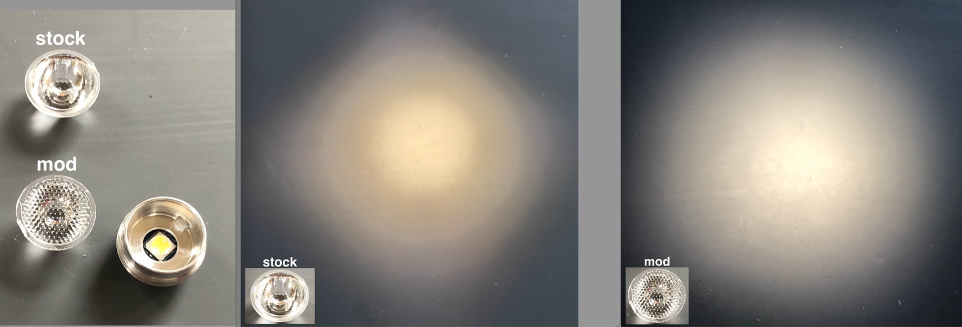

beam change from throwy to floody:

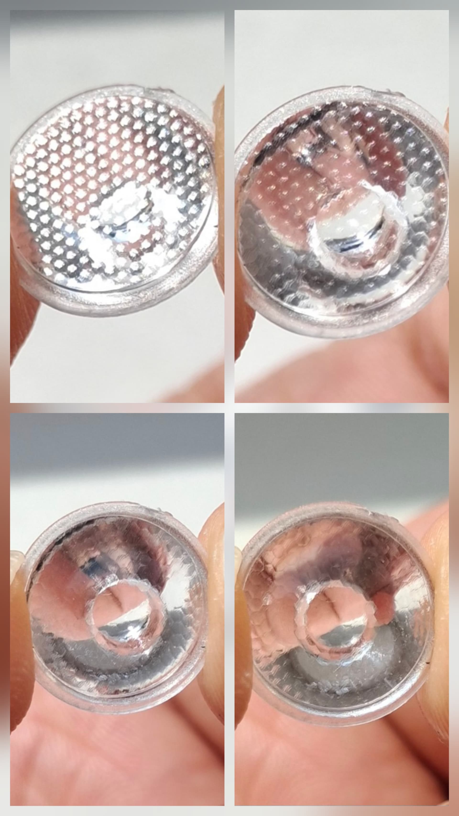

E3A (high cri) are sold with beaded lens. May be it’s later time change or depends from a seller/region.
It is beaded, but it’s very slightly beaded. From a distance you won’t notice those beads.
Here how the E3A’s lens looks from different angles.
Welcome and thank you for posting
true, the stock e3a lens is slightly beaded
the light is great, even with the stock LED, stock lens, stock output
changing the LED, lens, and output resistor are just things that Can be done, but they are not required
a few more pics in this album

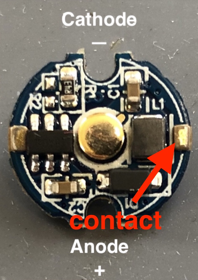

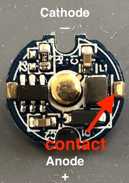

the solution would be to make a ring with bare wire, 0.2mm thick, and put it in the head, around the plastic clip that holds the driver. Pushing the wire into the gap of the body around that plastic clip.
I have not tried this and I think it is a bad idea, because the wire might touch something it should not and cause a short circuit and ruin the driver.
here you can see the contact for the body on the driver. note there are many other expose solder joints that the wire could short to.
Suggest you just not use Varta in E3a
