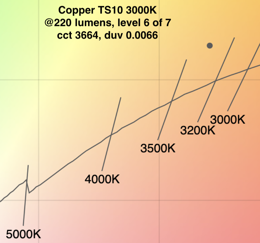

Tint is Terrible, sort of a greenish mustard yellow when whitewall hunting, although when waking up in the dark of night, the tint is not noticeable, at moonlight outputs. This light might get modded to DD 4500K 519a

Tint DUV increases w ouput, on Level 5 of 7 which is about 104 lumens, DUV is 0.0031. When using level 6 of 7, output goes up to 220 lumens, and DUV goes up to 0.0066:

That tint looks terrible. I have a TS10 brass version with 3000K LED and the tint is not bad. It’s not rosy but no where near as green as your sample. I’d say its pretty much dead on neutral.
Nice! :face_vomiting:

I got two of the 3000k in copper. One is decent and the other is vomit green.

I’m wondering if tint on 3000k copper could have an easy fix for Wurkkos by installing a green AR coated glass?
There is no glass lens on TS10 lights…

A minus green filter can help.
