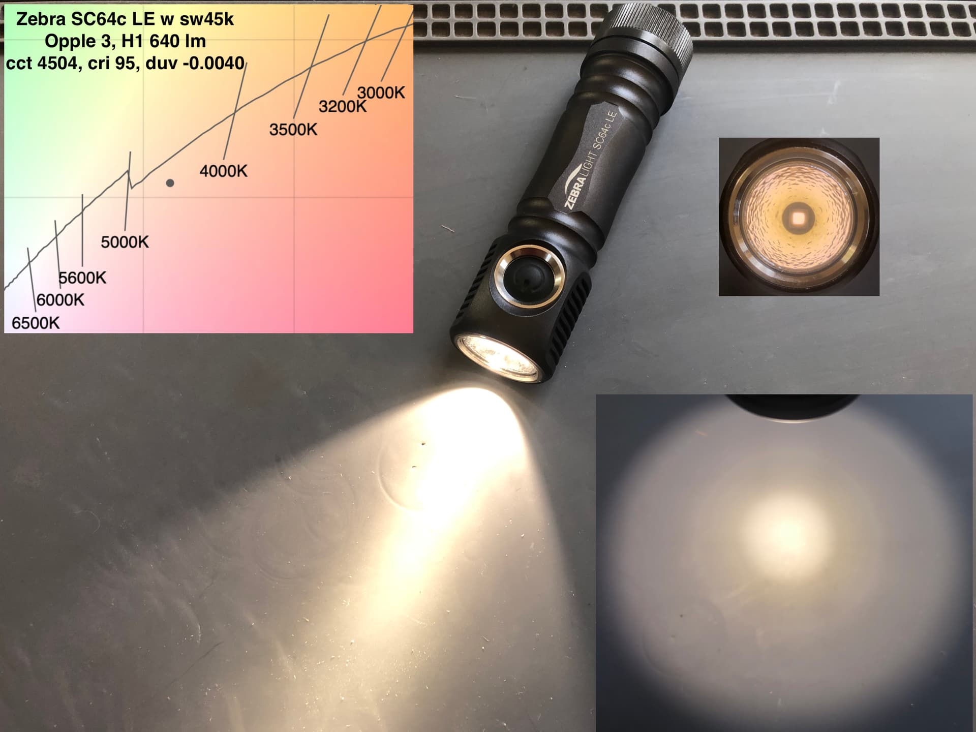

[NLD] Zebra SC64c LE w sapphire lens and sw45k
(mod thanks to bob_mcbob)
The beam is very clean, with nicely focused hotspot and smooth transition in the spill.
Very happy with the not excessively pink LED, as requested. Also pleased with the higher than expected output. (Lumens from my own meter.)
mcbob measured the LED at duv -0.0065.
My Opple reads -0.0040 on H1, and -0.0014 on M1.

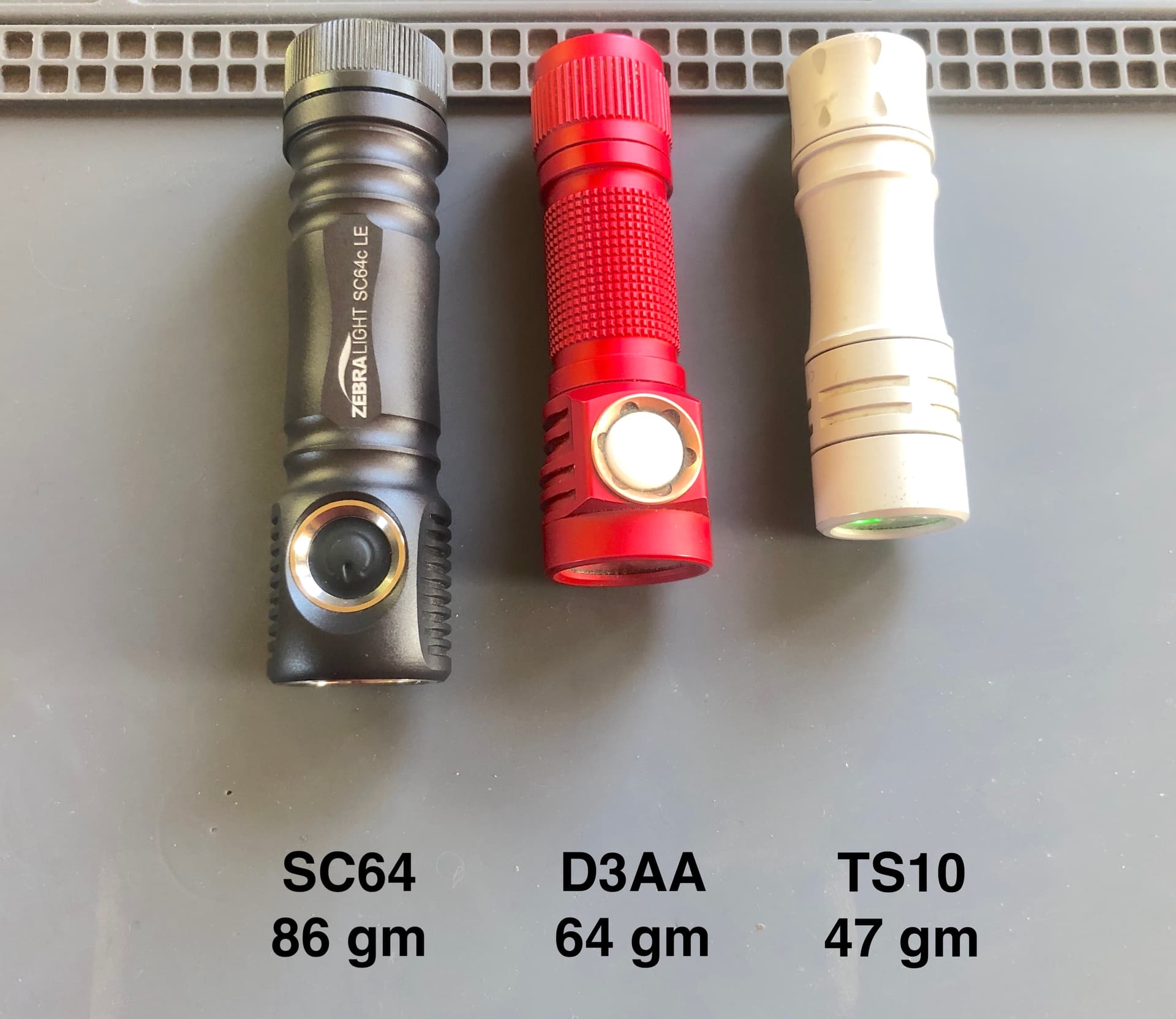

Carry Weight w clip and battery: 86 grams.

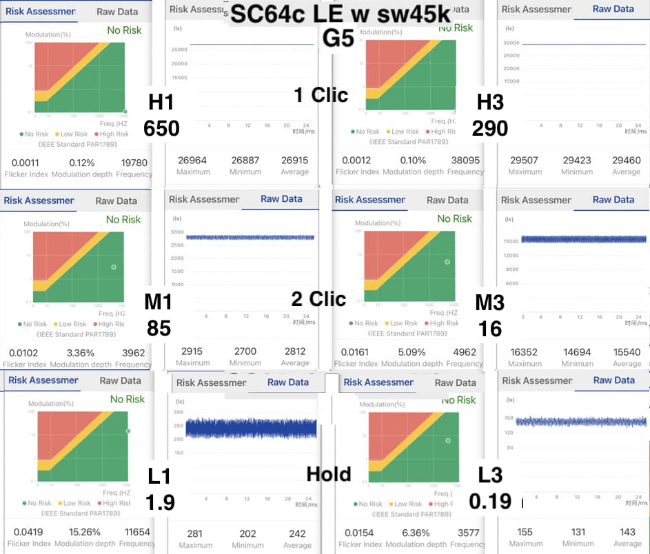

Flicker Index from my Opple 3.
Default G5 program:
Very pleased with the Very Low Flicker Index results from this driver.
Size and weight comparison:
