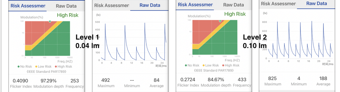

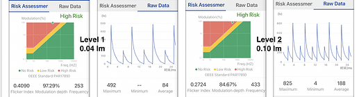

Im happy to say the low mode PWM does not flicker visibly, to my eye. Although the Opple ranks the Flicker Index as High Risk on the two lowest modes:
those two outputs are from my own lumen meter and they match the official specs almost exactly (spec level 1 is 0.03 lm, and level 2 is 0.11 lm)…

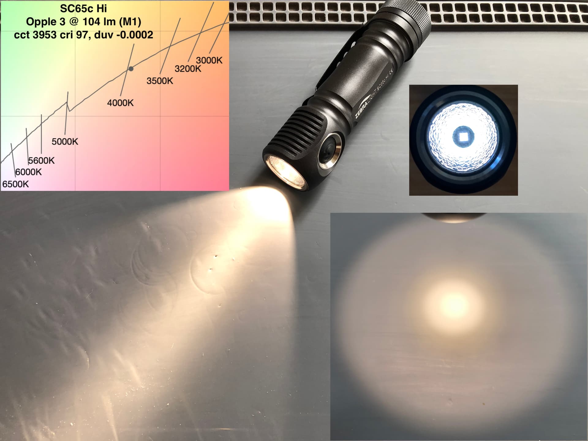

also pleased the Tint DUV is not above the BBL… looking forward to night time :wink:

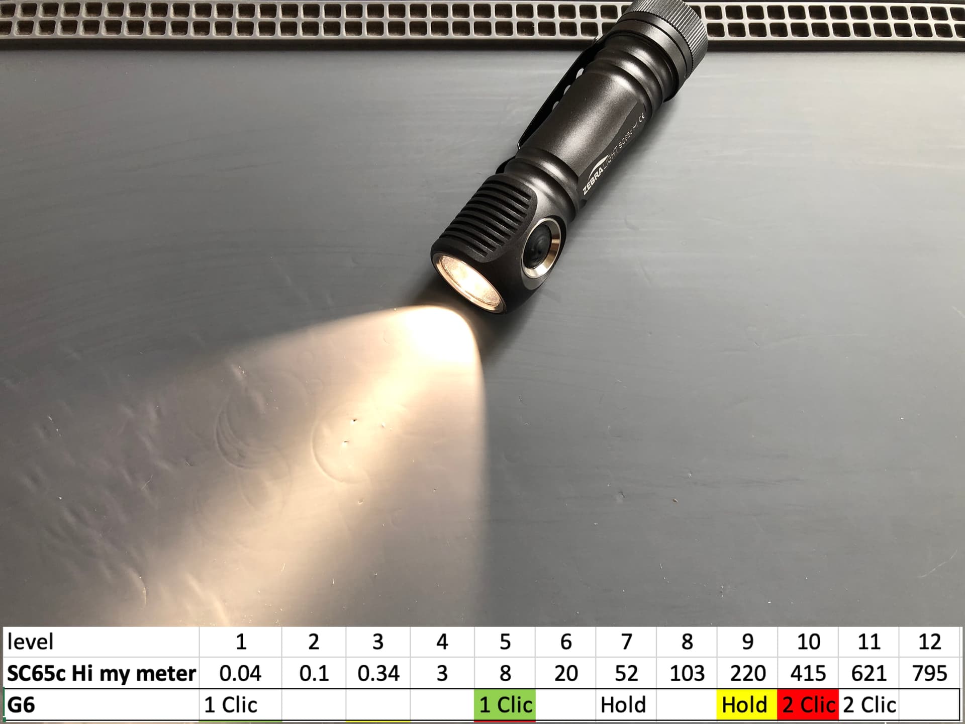

outputs on my meter, and my G6 program:

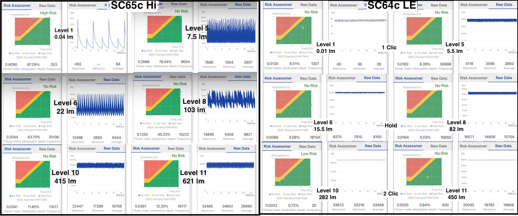

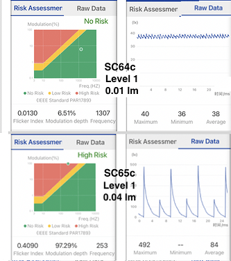

I prefer the SC64c LE driver, it keeps the LED at more Constant Lux, uses a lower Modulation Depth, higher frequency, and lower Flicker Index score, than the SC65:
On Level 1, the SC65c is using slow PWM, at 253Hz, and the Minimum Lux is cycling all the way Off.

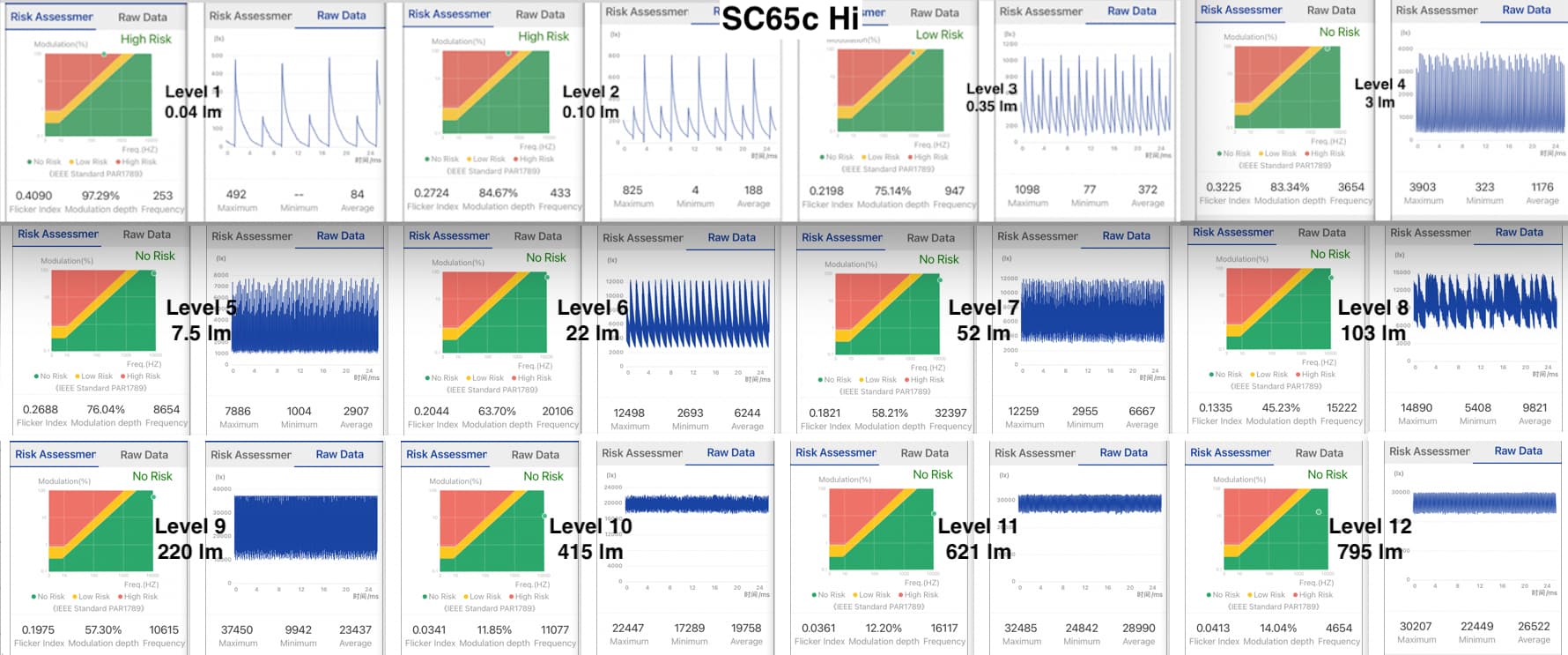

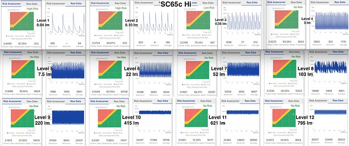

here is Opple 3 Flicker Index tests for all 12 levels:
(lumens from my meter read high due to the small LED w intense hotspot)

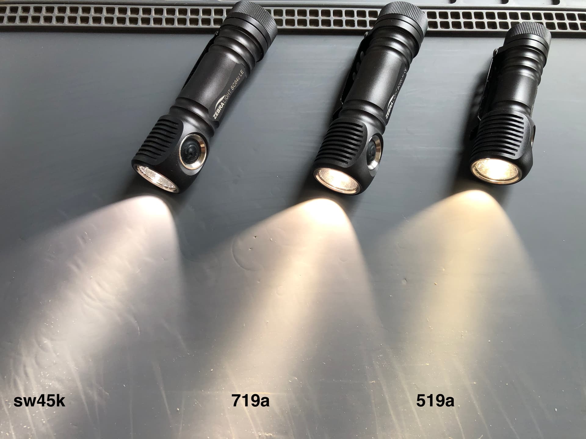

Only if this had a B35AM 5000K emitter…
here it is! :wink:

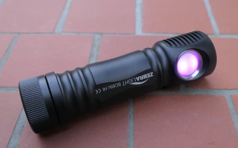

That Freeman ZL is amazing…

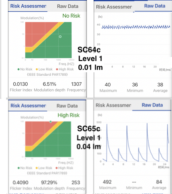

I cant see the flicker in mine neither… my Opple can:
the SC65 driver uses deeper modulation, and deeper dimming of the Lux output, resulting in higher Flicker Index…
