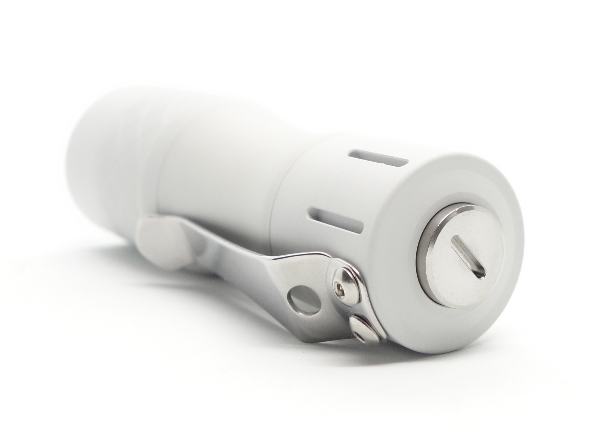

The NLIGHTD L3 is an 18350-sized torch with an 15W shine-through LEP module.
Neal kindly sent a prototype to test.
There is an optional 18650 tube to increase the capacity and runtime.
An NLIGHTD 18350 1600mAh cell is included but I used a Vapcell M11 V2 18350 1100mAh cell to test the LEP module.

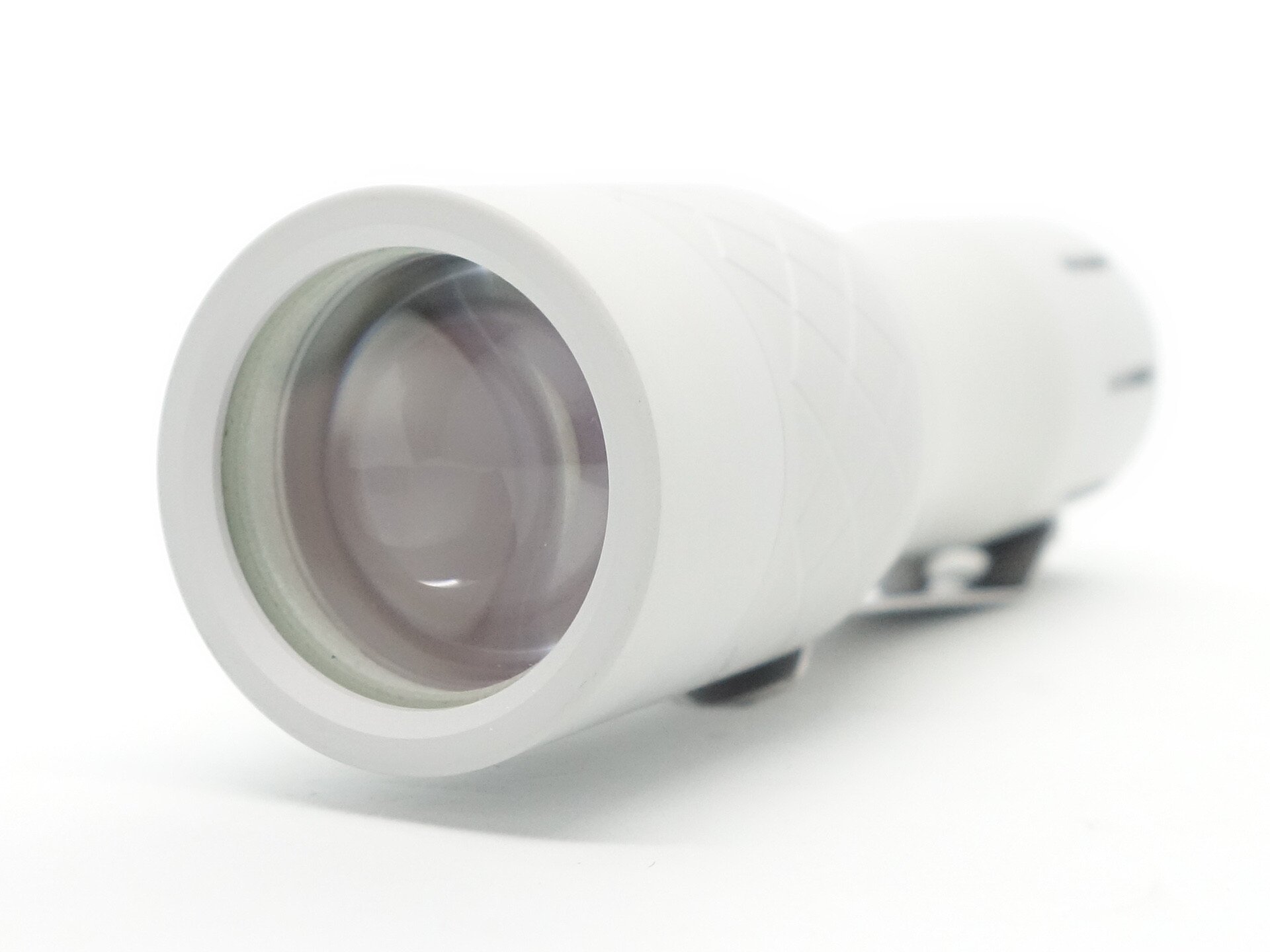

I don’t have a LEP yet but this one has a lot of what I think I’d want. I realize it’s a niche long range light, but could that filter instead be used with a diffuser to get a floodier beam if desired?
Yeah, you could probably find another filter that diffuses the beam.

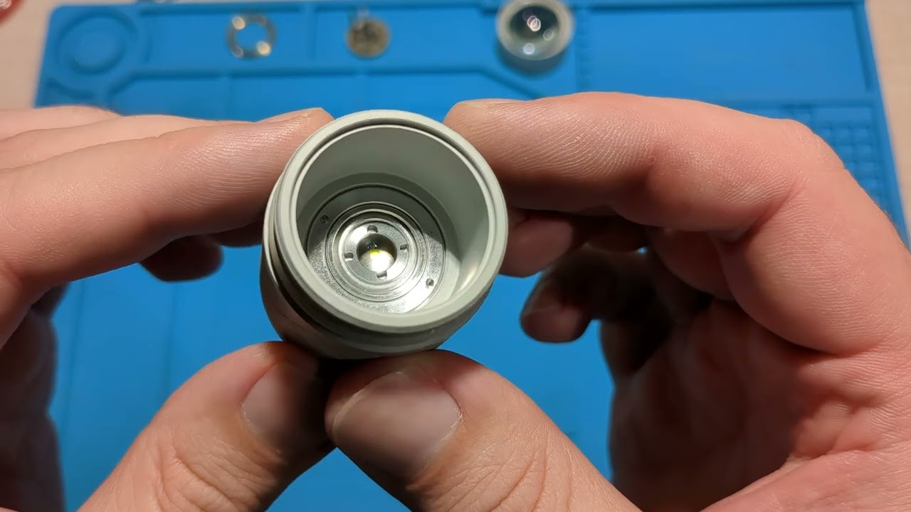

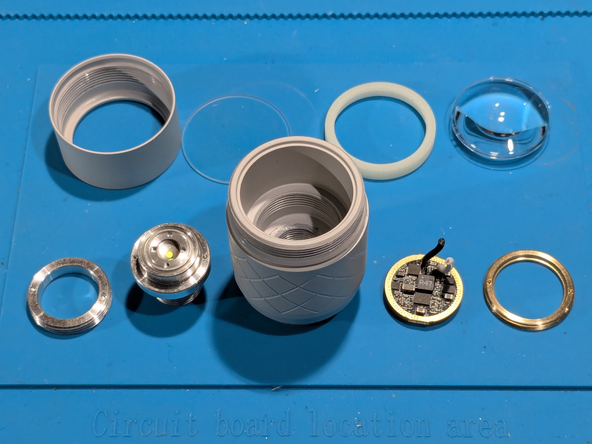

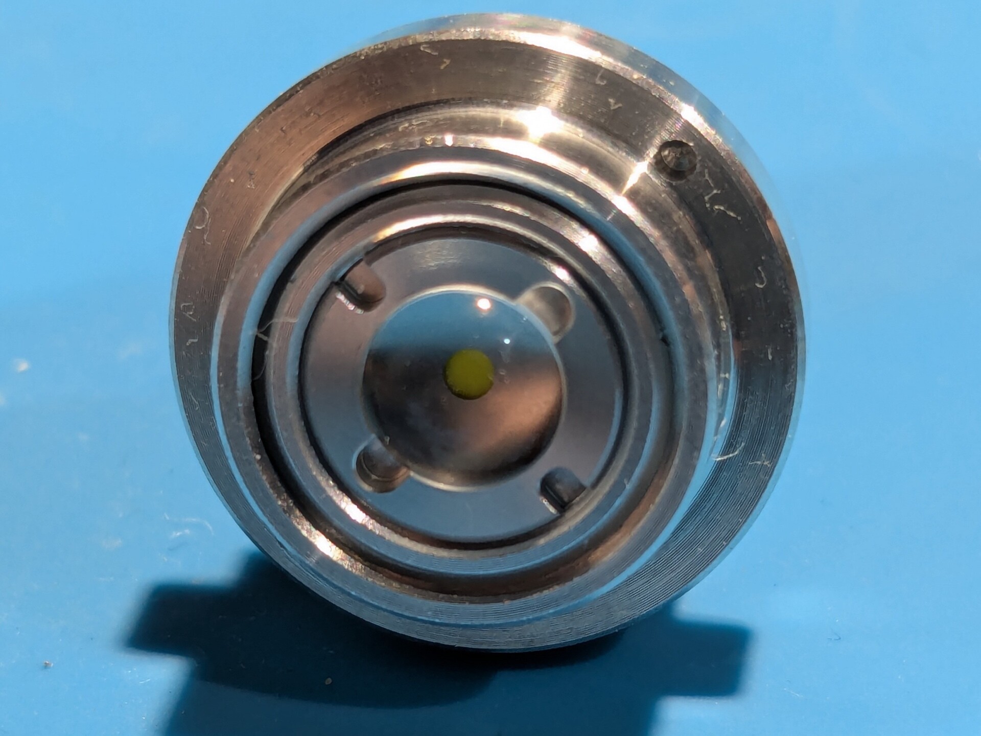

Teardown:
I received the L3 MAO for review, and later the L3 Green.
The MAO finish looks and feels gorgeous. But I ran into an issue while doing this review.

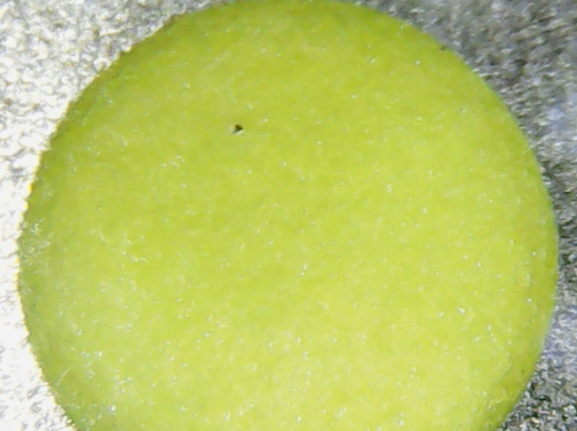

A dark spot appeared in the middle of the beam after using High for a few minutes with a high drain cell.
I did a teardown of the L3 MAO but I could not see any issue with the module.
I later bought a digital microscope to inspect the LEP module and I found a small black dot. It is very hard to see.
Has anyone else noticed this?
