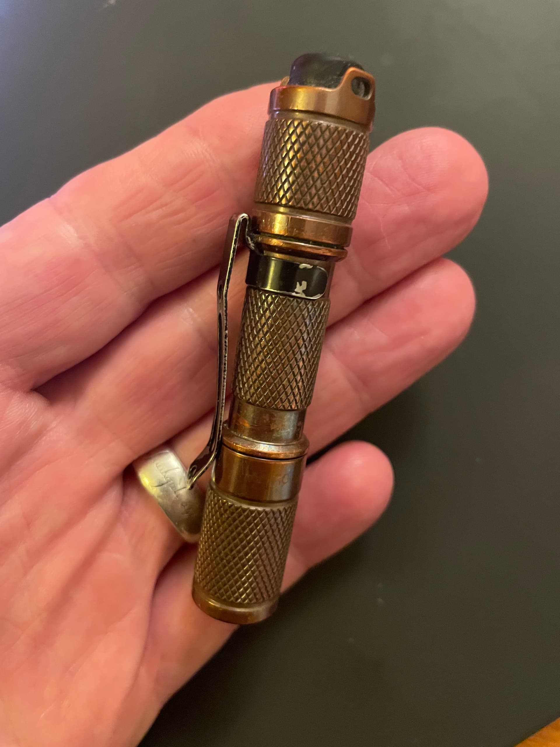

Success! I have a fully functioning KR1AA, or very close to it. :partying_face:

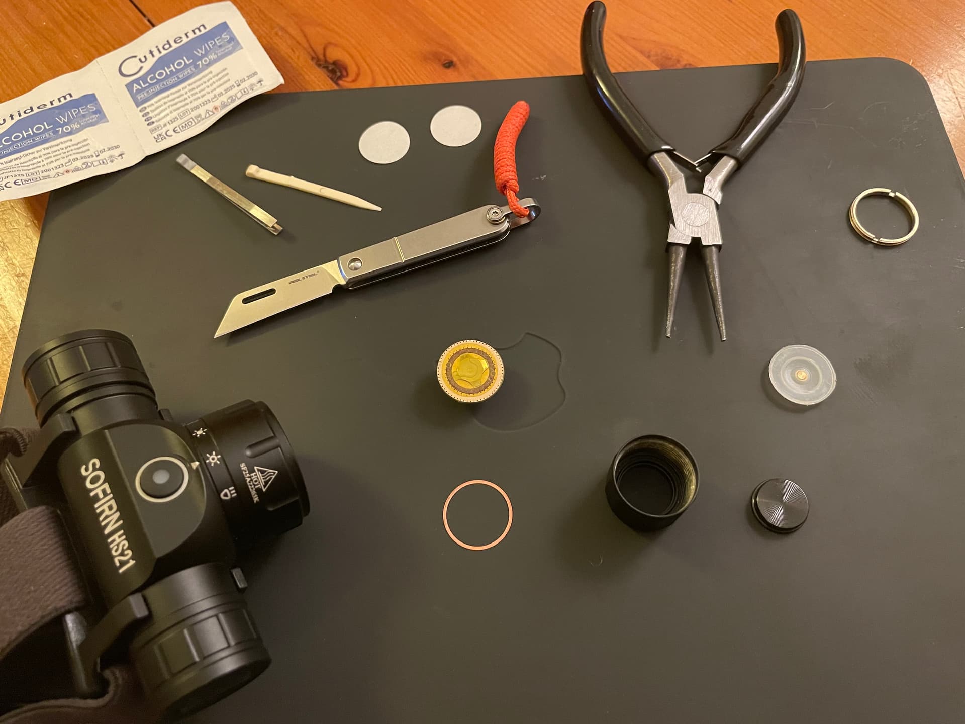

Tools

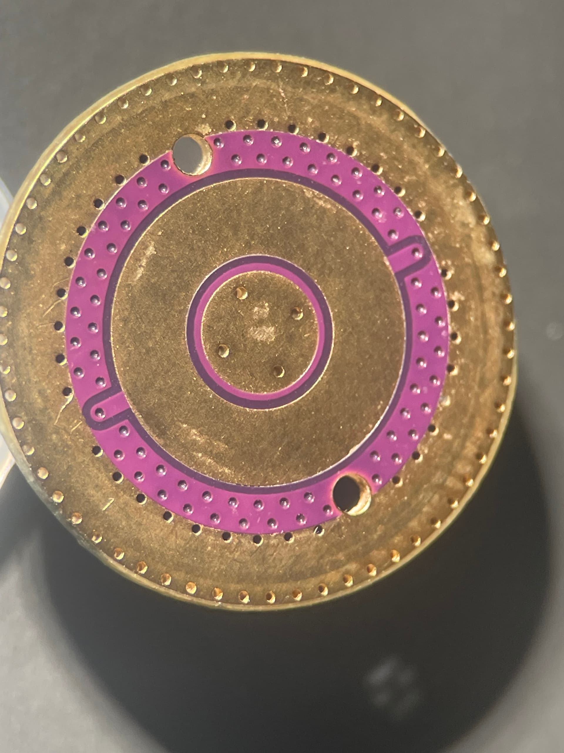

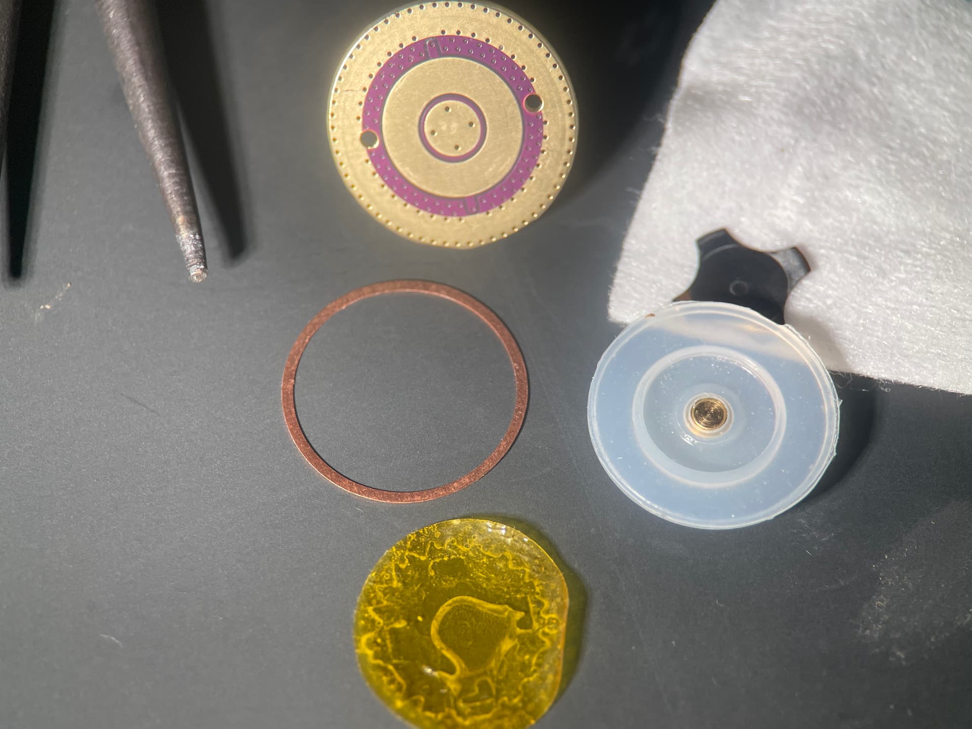

Cleaned up switch baseplate, you can see where the adhesive was and the outer copper washer sits.

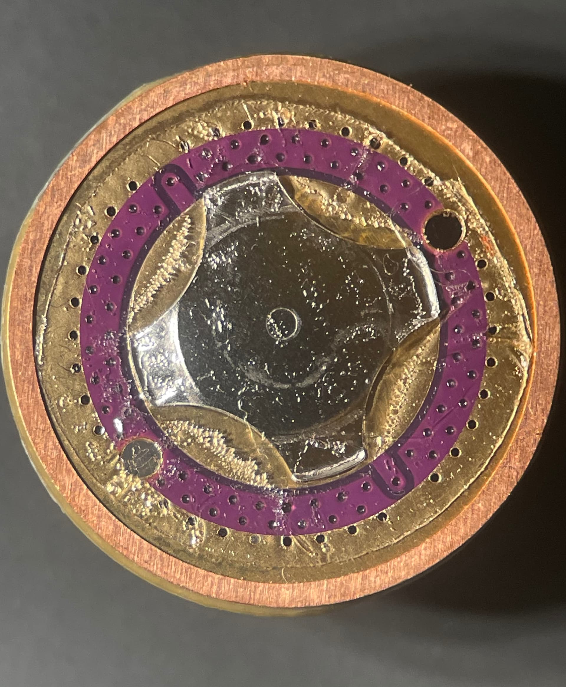

The flexibility of the clingfilm disc to blank the sticky side of the tape is essential to getting a good bond without creasing IMO. Had to trim a bit for the washer to sit, it looks messy and was fiddly, but I just ran the tip of the little knife round it and peeled the excess.
Copper washer sitting clear on the outside.
