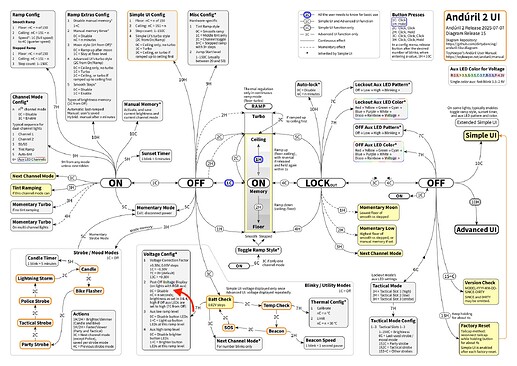

that sounds like you turned off one of the new POVD features, option 3 or 4 of the POVD menu, instead of turning off Option 2 of the menu
you just need to turn off Option 2 and then the Aux should come on without delay (red arrow, bottom of chart)

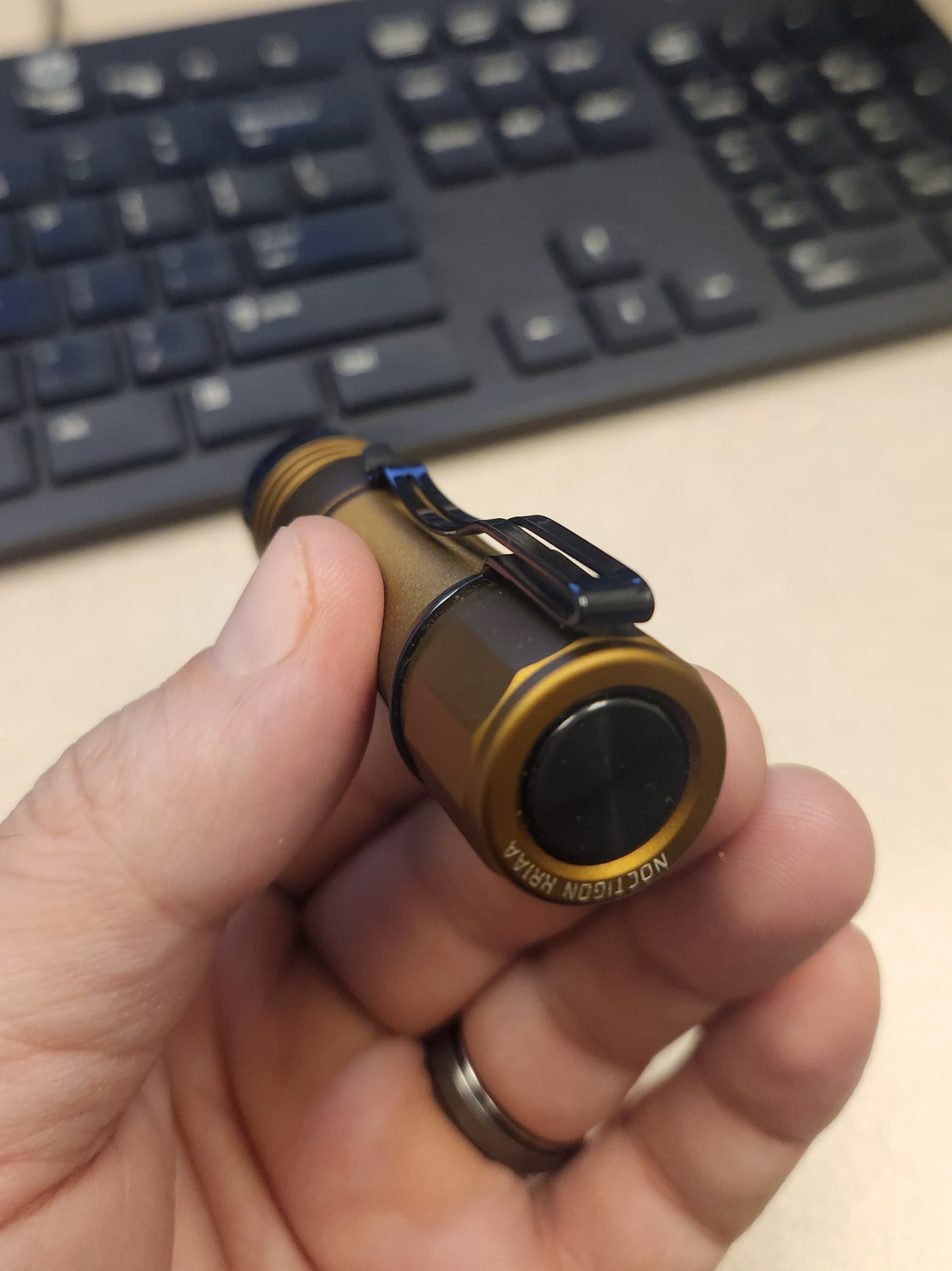

I made a video of the clip movement: Noctigon KR1AA clip : r/Anduril_Flashlight.
The clip has a bit of play. Even with the tailcap fully tightened, it still moves slightly when you press down on it. The clip can also rotate, it doesn’t take much force at all (less than pressing the button). According to discussions on BLF, both issues might be fixable by adding another O-ring.

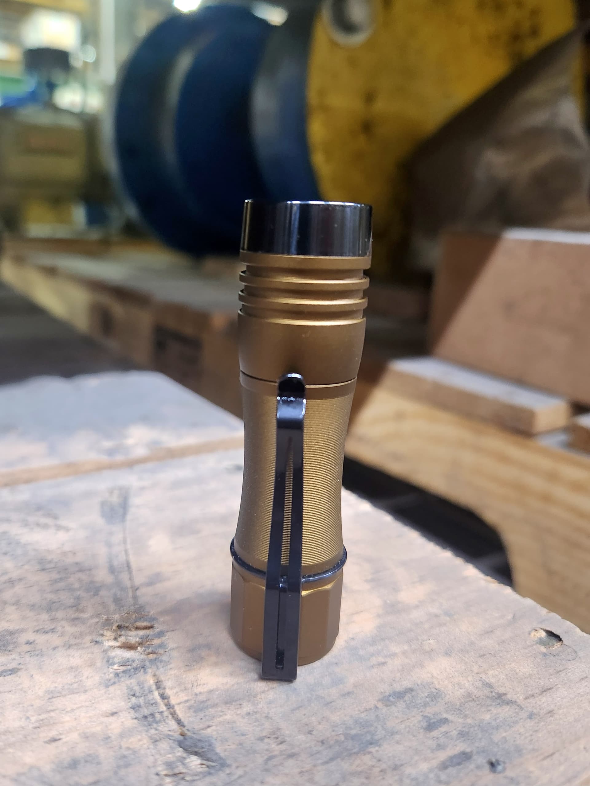

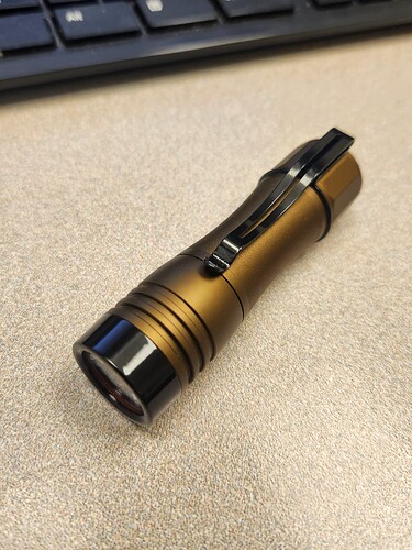

Dude, your light is SCREAMING to be olive drabbed. The black hardware looks slick
**also…it must be cool flouro lighting…but it looks like poo also LOL…Could you light it with a higher CRI? It seems to be missing some deeper red or amber tones. The indoorslighting always seem to impart a cooler/greener tint to everything when paired with AWB…
Here it is with a bit different lighting. This looks more accurate.
