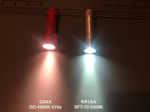

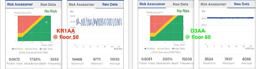

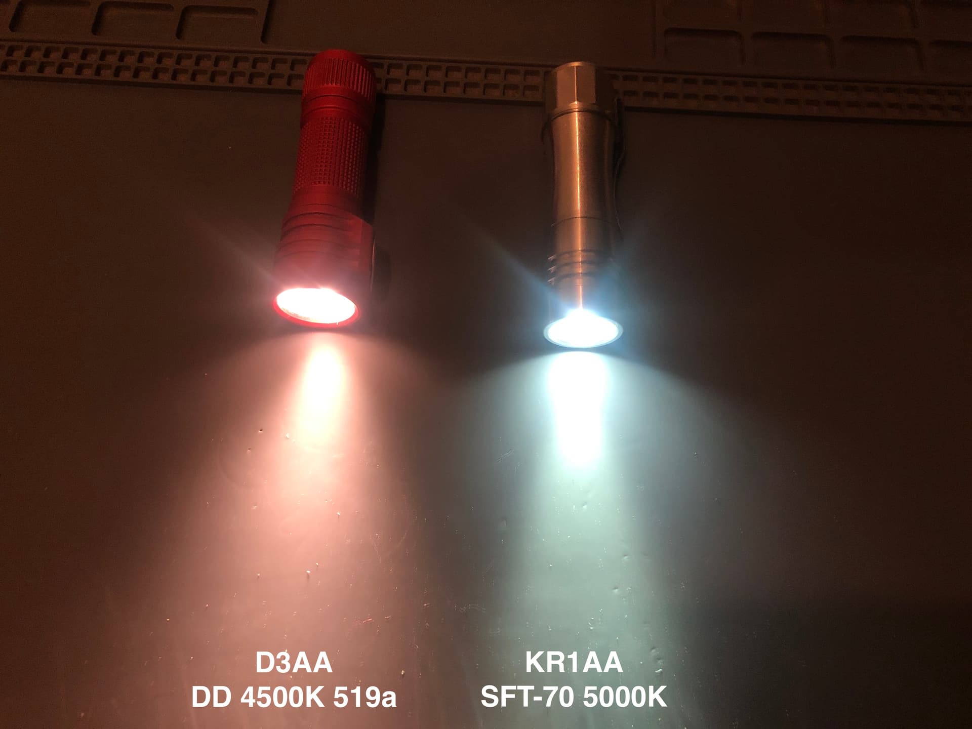

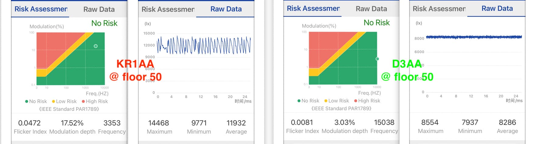

Good idea.. instead of using same lumens I tested at same ramp level this time:
Both have Firmware 0161-2025-07-07
Both have the same ceiling 110/150
Both are in Advanced Smooth Ramping
Both outputs are at floor level 50/150:
different LED type, CCT, and Lumens:
KR1AA w SFT-70 5000K, @ floor level 50/150 = 42 lumens,
D3AA w DD 519a 4500K (gives 3400K), @ floor level 50/150 = 19 lumens
(white balance locked at 5000K)
I think the drivers are also set to different Voltages.. 6V for KR1AA and 9V for D3AA. Maybe that factor affects the results?
I have not kept track of which light, but have seen and wondered about these shallow modulation in lights with regulated driver.
I could think of 3 possibilities:
  1. Real; if so the question I have is are such shallow modulations used as a way to control brightness?
  2. Unintended electronic noise of driver causing flicker.
  3. Error of Opple.
Good point. They won’t be comparable because they’re different voltages, so the regulator will behave differently even with the same firmware settings.
Your results demonstrated how much it can change from one ramp level to another though, even on the same light with the same battery.
Most regulators work by quickly setting an output level, then reading the result, then setting a new output level, then reading the result, and so on… so they naturally tend to oscillate. Most have configurable settings to controll the oscillation speed, because faster oscillations look better but use more power for the control chip, while slower oscillations are more likely to be visible but allow the control chip to use less power.
Additionally, the regulator has only limited resolution for the steps it can set the output to. So it’s unlikely it will be able to hit the exact level requested. It just tries to get as close as possible by oscillating between nearby levels.

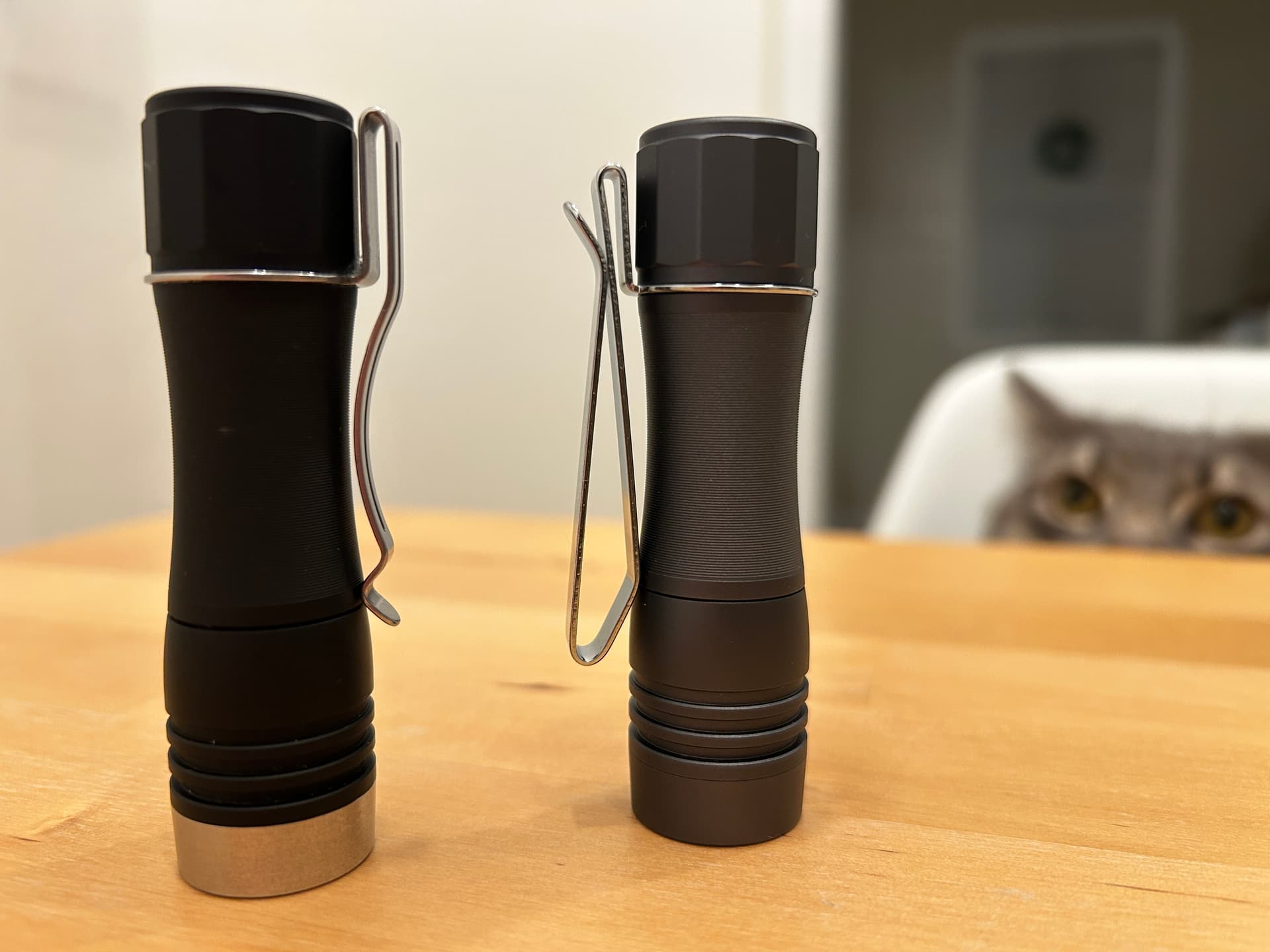

I did try the LT FW1AA deep carry clip on a N-E KR1AA.2.
Original KR1AA clip left (black torch). FW1AA clip right (gray torch).
The locum clip got more springy than when installed on its intended FW1AA, but still spun with little effort.
This combination would not deep carry when clipped to the thin fabric of my pajama bottoms.
When I put the ring portions of the clips together to compare thickness, I could discern none by eye or feel.
6 Thanks
The mischiveous lil bastid in the background, lol…

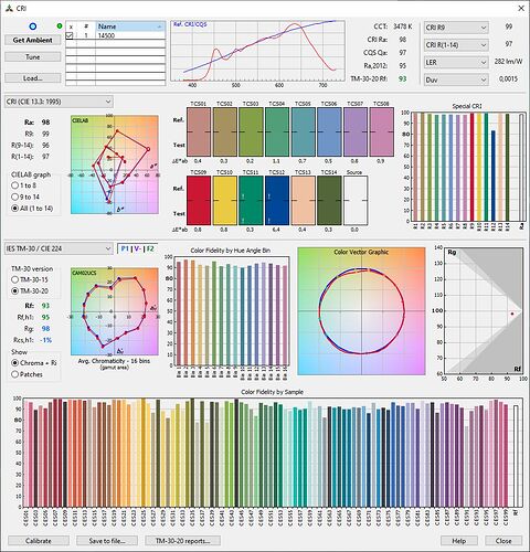

My KR1AA with SFT-70 3000K 95CRI
